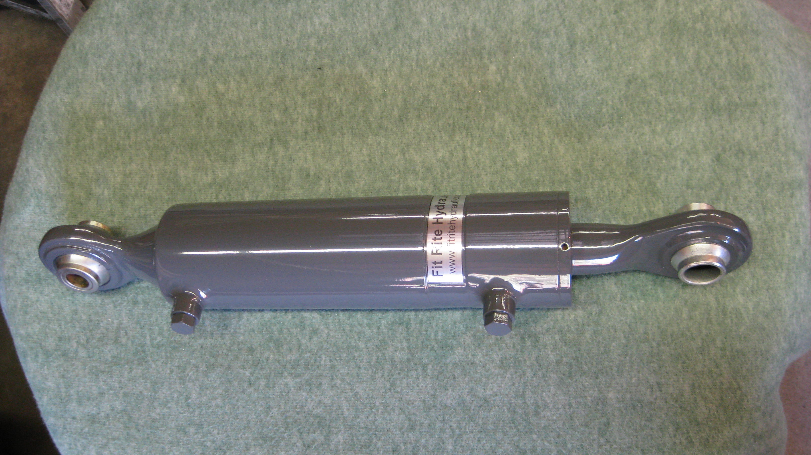

I am shopping for a hydraulic top link for a Kubota M7060 and was curious what has worked for others.(size and length)

Scott, I typically sell a 20 1/4"- 29 1/4" working length for your model of tractor. That's a 3" dia cylinder with a 1 1/2" dia rod as seen in the picture.
When shopping, keep in mind that the tractor end is a cat 1 pin size. ;)
