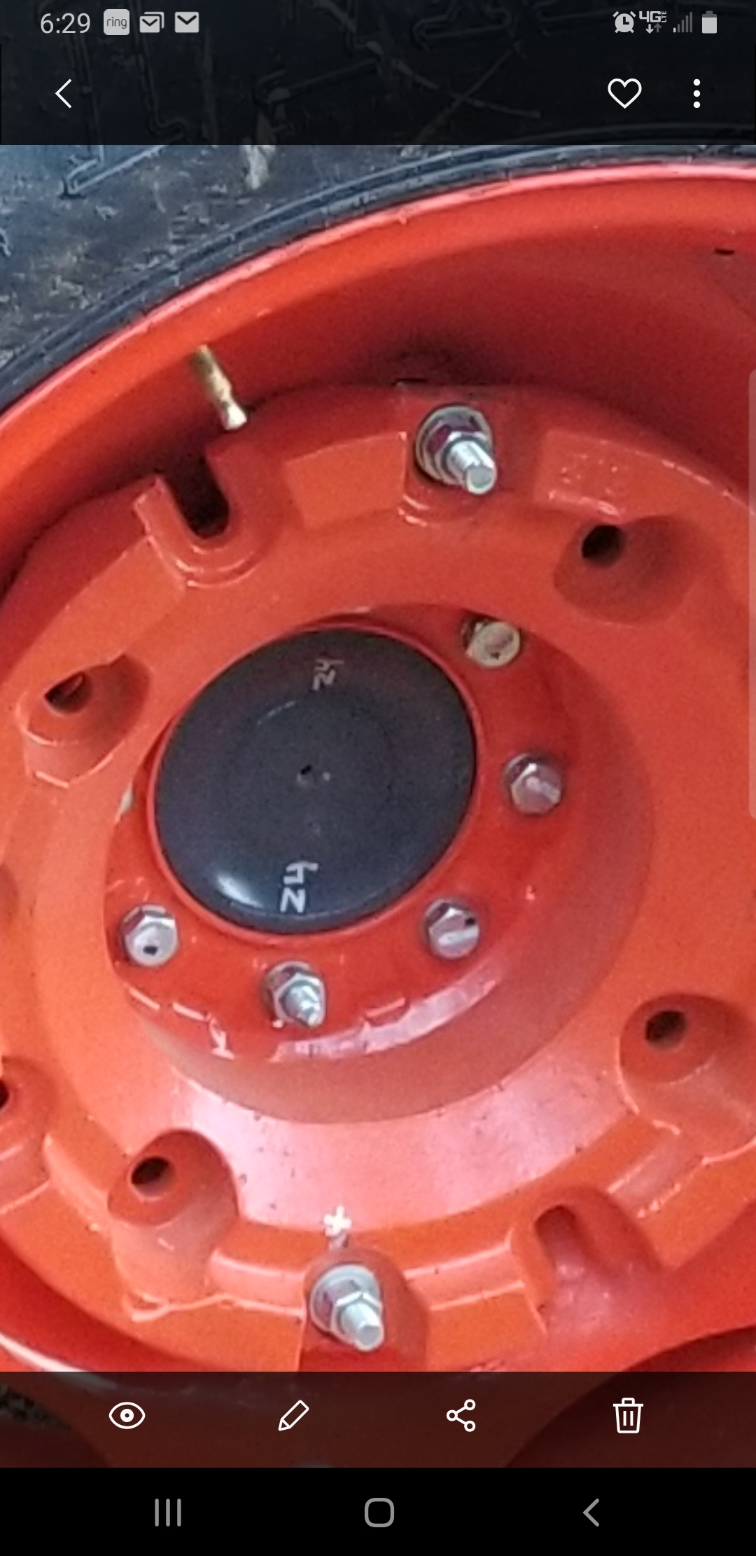

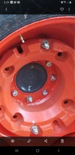

Need to purchase a set of sockets that fit my M7060 but need to know if the are SAE or metric sizes. Couldn't find anything in manual so thought i would ask the experts.
/ M7060 Lug Nut size #2
It's metric.

/ M7060 Lug Nut size #5
Wouldn't be a bad idea just to get a set of metric sockets probably up to 30 or 32 MM.
Everything on the tractor is metric, so a set might come in handy more times than you think it will.
/ M7060 Lug Nut size #6
I know this isn't much help to you but my mx5200 is 24mm. I went around my tractor with a paint marker and marked all major bolts/nuts with a paint marker for size. This is needed because my tractor is at a remote property and I have to specifically bring tools in that I need for jobs that I may do, and I can't be searching for the right size or bringing my whole tool box all the time.

/ M7060 Lug Nut size #17
The Kubota M7060 has two different sizes of wheel lug nuts - 24mm and 35mm. I bought a Tekton 24340 1/2-inch drive torque wrench for $57. Great wrench for the money.

You are looking at the N-m specs in the attachment on post #4, not the ft-lb specs. The Tekton wrench I mentioned does only go up to 250 ft lbs, which covers everything for a new Kubota M7060. I have a 2019 M7060 and the owners manual (M6060 and M7060) shows the following torque values for wheels and discs:
Front wheel mounting nuts = 192 to 224 ft lbs
Front disc mounting nuts = 180 ft lbs
Rear wheel mounting nuts = 191.8 to 224.2 ft lbs
Rear wheel steel disc mounting nuts = 180 ft lbs
Rear wheel cast iron disc mounting nuts = 191.8 to 224.2 ft lbs
I have steel discs on my rear wheels, so I torque the front and rear wheel mounting nuts to 200 ft lbs, and the front and rear disc mounting nuts to 180 ft lbs.
