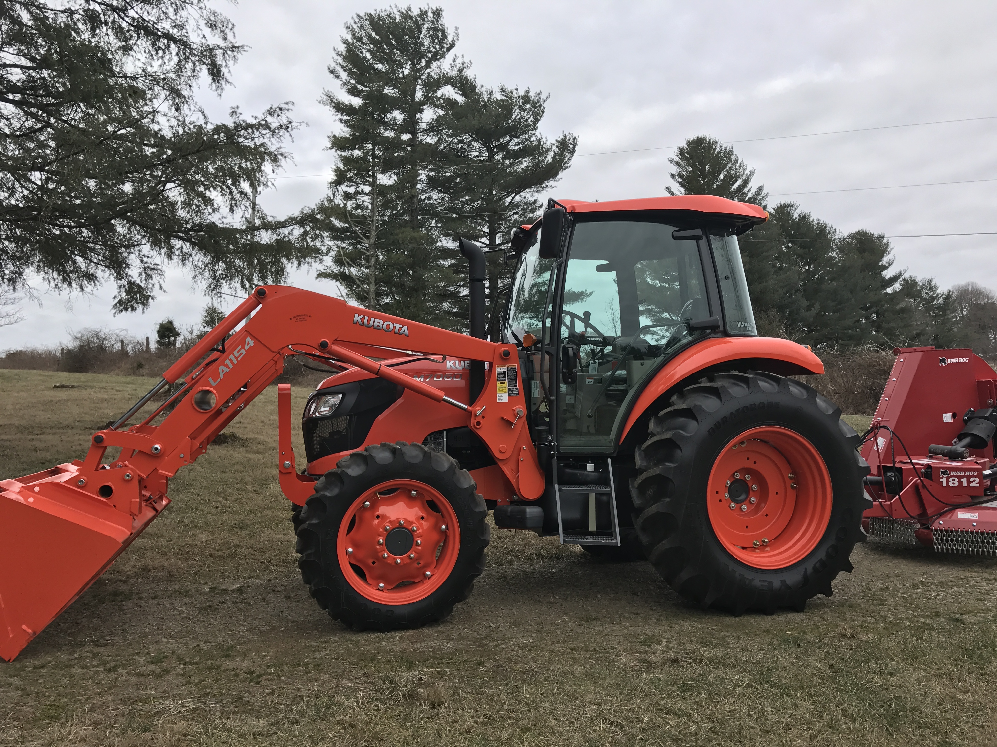

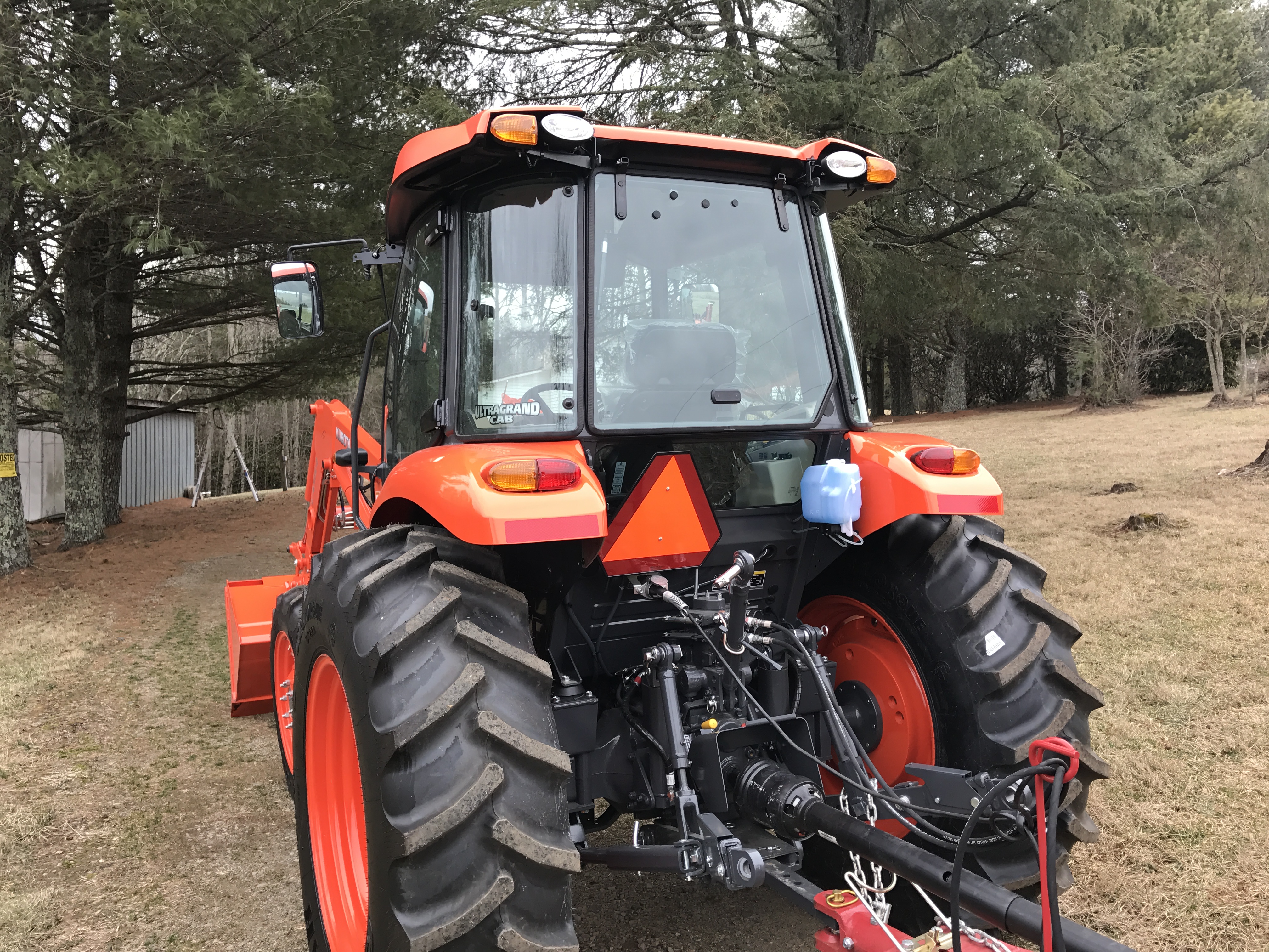

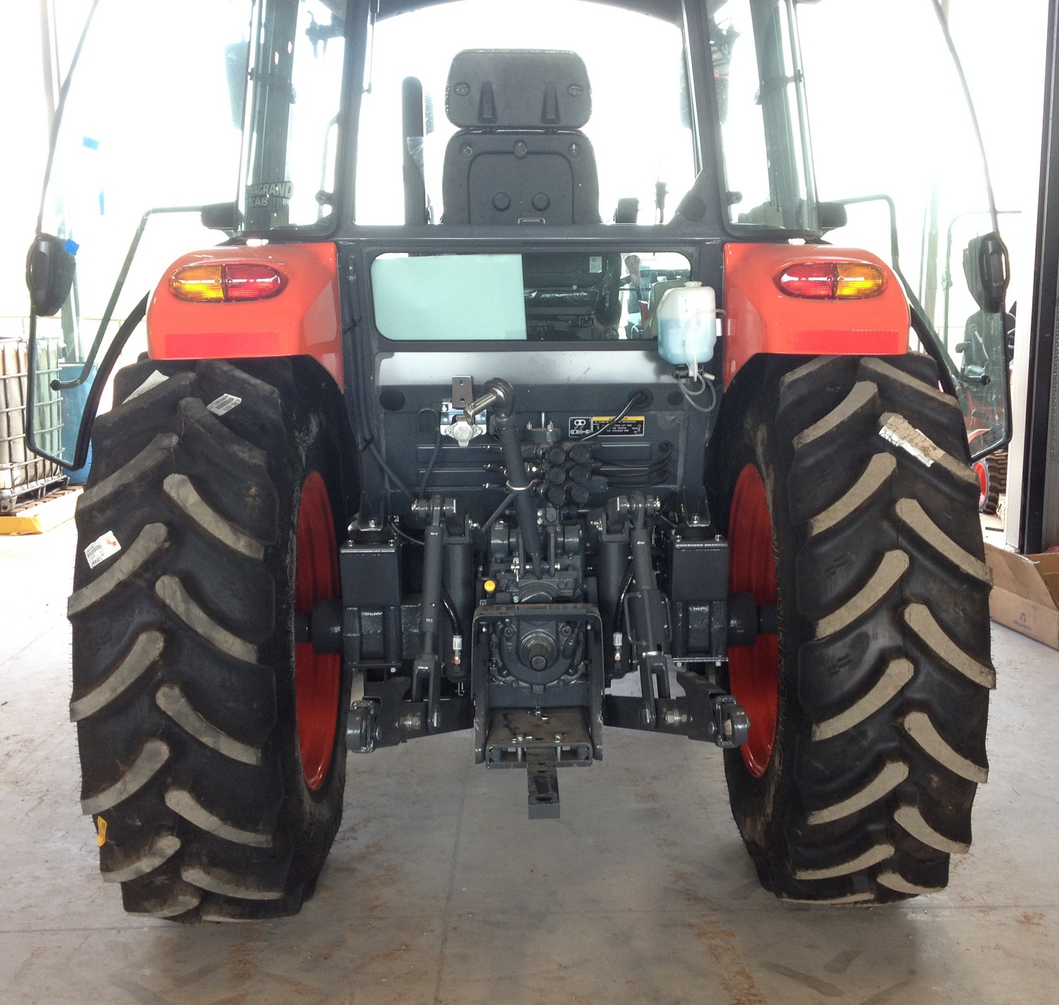

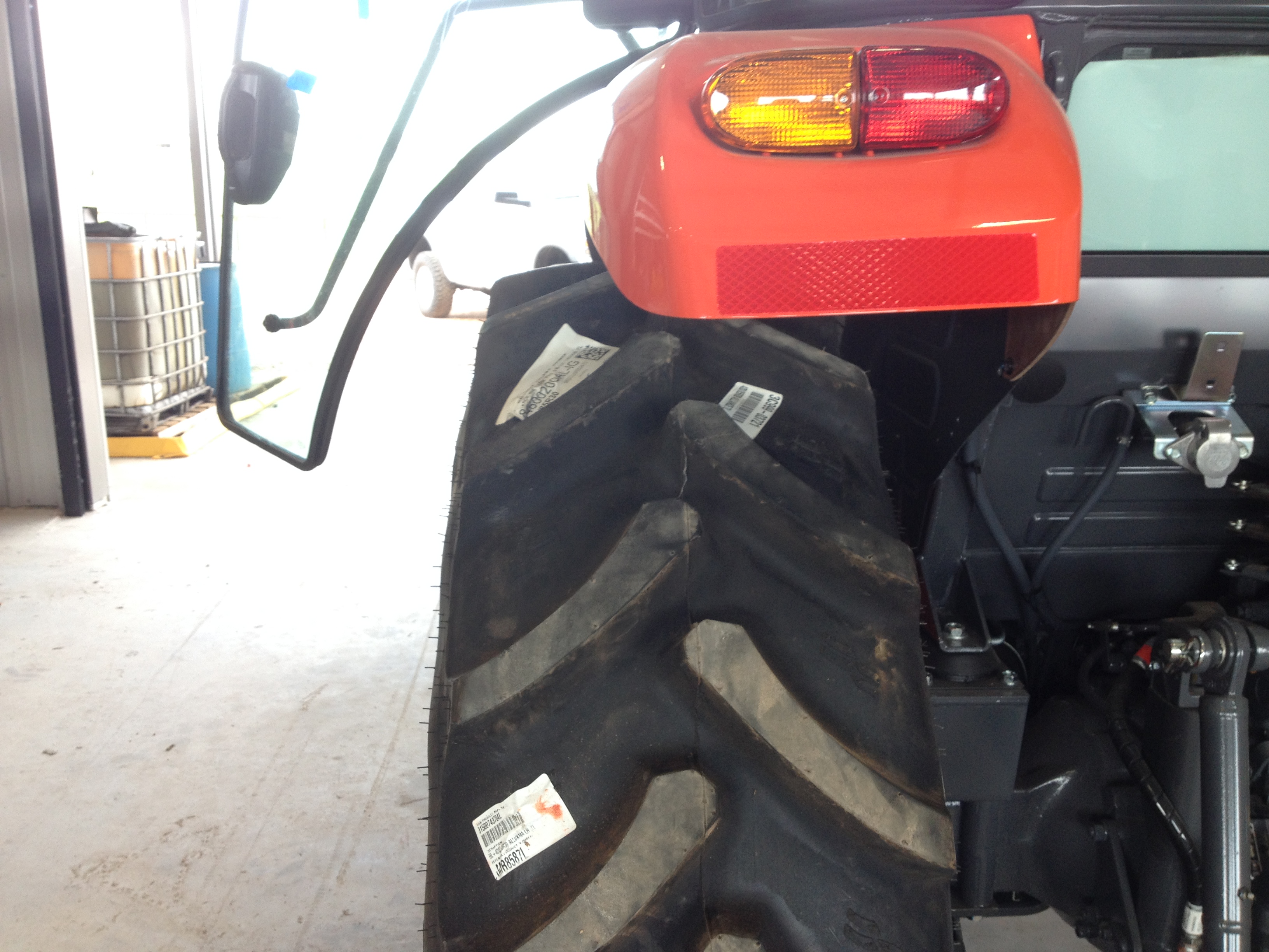

TexasBoy comparing photo's of your tractor's rear wheel tread & herkypilots tractor rear wheel tread the latter is wider. Plus your tractor wheels valve stem are outside & his are inside which makes a difference in location of mounting brackets on the rims. Relocating valve stem from outside to inside makes a lot of difference in wheel tread spacing.

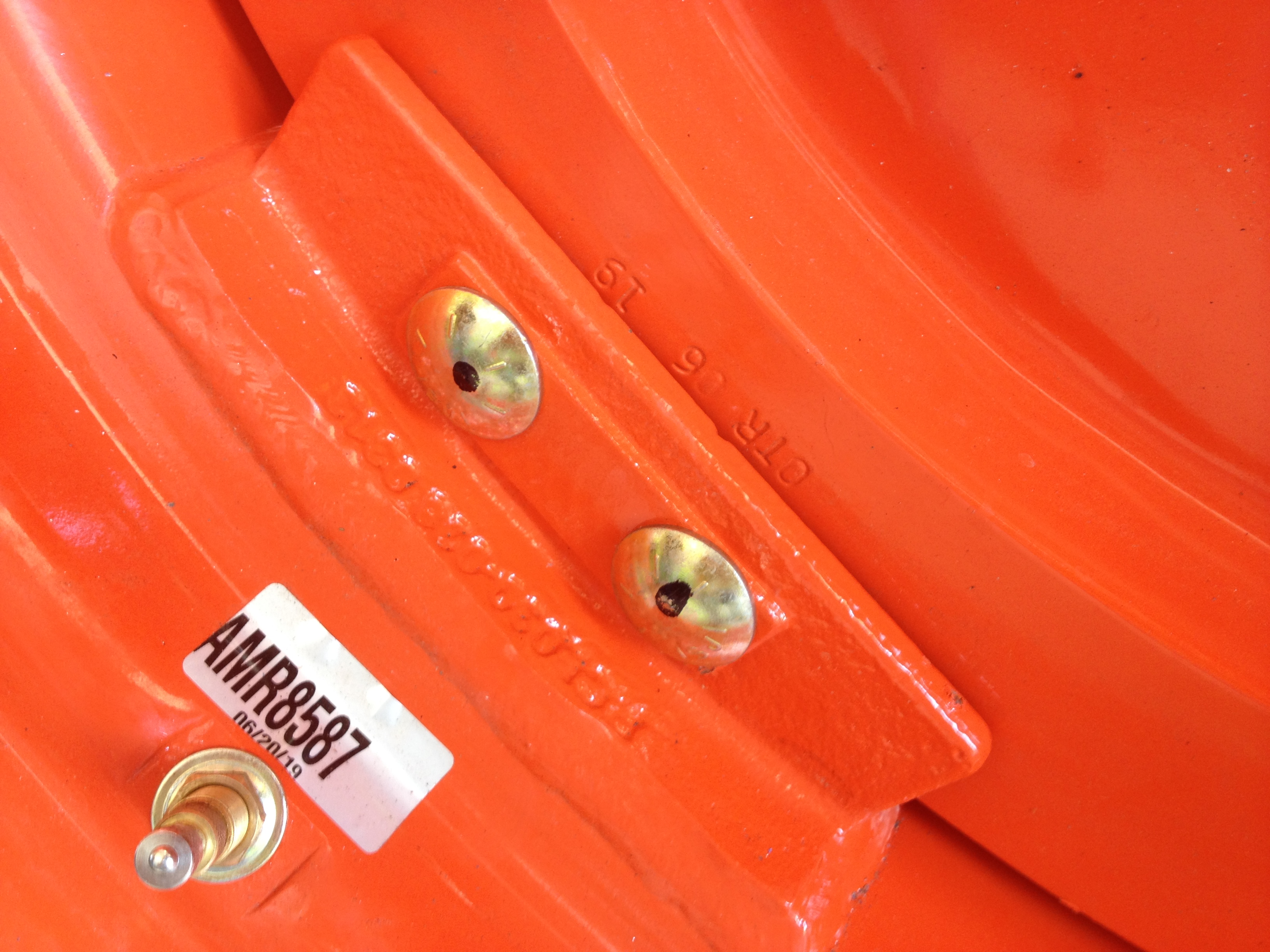

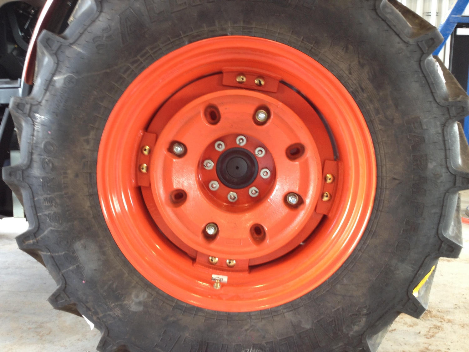

As I explained earlier in this thread, with the raised boss on one side of the tabs limits the options you can do. This is the point many are missing. As the tractor sits now, we did indeed take the left tire and move it to the right and the right to the left. And doing so gained us what appears to be a bit over 2" on each side. But that raised area on the one side of the tab limits how many options you get without taking the tire off the rim and moving it the other direction. That raised area cannot be put against the wheel center.
614313d1564014182-m7060-rear-wheel-offsets-img_4131-jpg

And due to this fact that the tabs are not centered, trying to put the dish out on my wheels would put the raised boss towards the wheel center and you cannot do that.

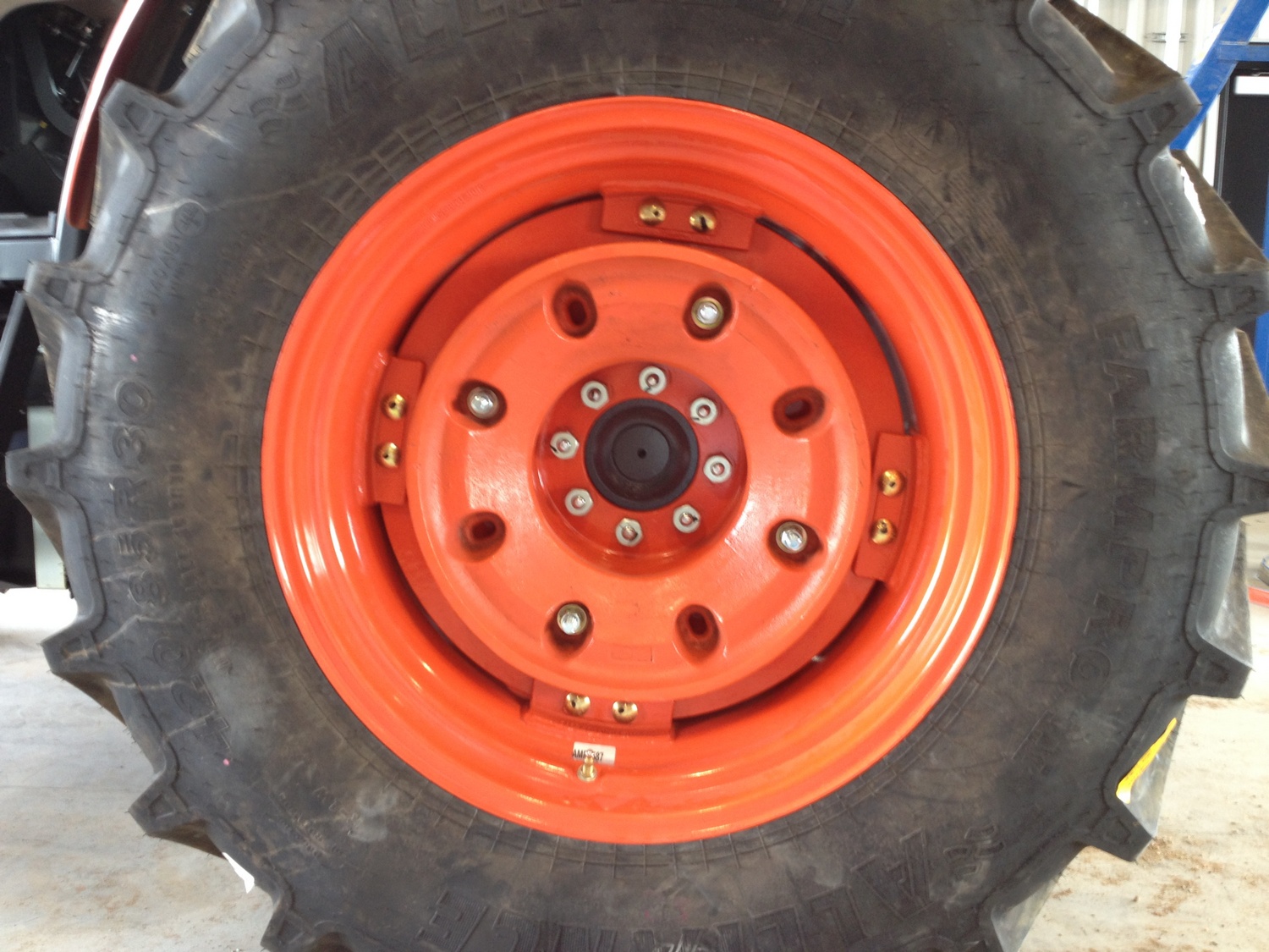

Texas Boy - the picture in your post#33. My tabs don't have that raised area where the bolts are. I would loose four width positions if mine had that raised area. Like you indicated - I wouldn't trust placing that raised area, only, up against the center disk either. The entire tab itself is a small contact area - the raised boss area is just too small.
If it were really important you could unmount the tire - scrape off the orange paint - weld on a "C" shaped chunk and bring the tab to the full height of the boss.
I wonder how much $$$ they saved by doing it that way. It would have been just as easy to make the tab full thickness.
Yes sir, that was my only point from the very beginning. I simply cannot put the dish out with these tabs not flat on both sides. It would not make a secure mating surface for the two parts of the entire wheel assembly and would be a weak-link. (and no doubt eventually fail) For this reason, we only did the left-to-right & right-to-left switch that gained me what seems to be about 5" overall wider stance. I would love to have the setup like Herkypilot but do not want to dismount the tires off the wheels on a brand new machine. If the time comes someday that I have a flat and there is a need to pull a tire off, I may go ahead and do it at that time.
You're right, really makes you wonder what Kubota was thinking making that tab in that configuration.

I contend, if the raised block on the rim tab prohibits the rim from being mounted in the outmost position, which would be offset out, rim fastened outside of disk, it is irrelevant which way the tire is mounted. That position would not be available to you. Removing the tire and reversing it would accomplish nothing. When tires are mounted the only concern is that they are mounted in reverse direction of each other. Nothing else matters.
Using the picture posted above, forgetting tire rotation, study the evidence. Note the raised block on the rim tab. Note that his are mounted with that tab away from the center disk. So, in this conversation they are mounted correctly. With this same study of the picture, note that you cannot ever mount the rim in the farthest outward position on the center disk without this becoming a problem. Regardless of whether a tire is mounted or not. The picture posted is a perfect reference because our view is not confused by the tire mounted direction. Great picture for this discussion.

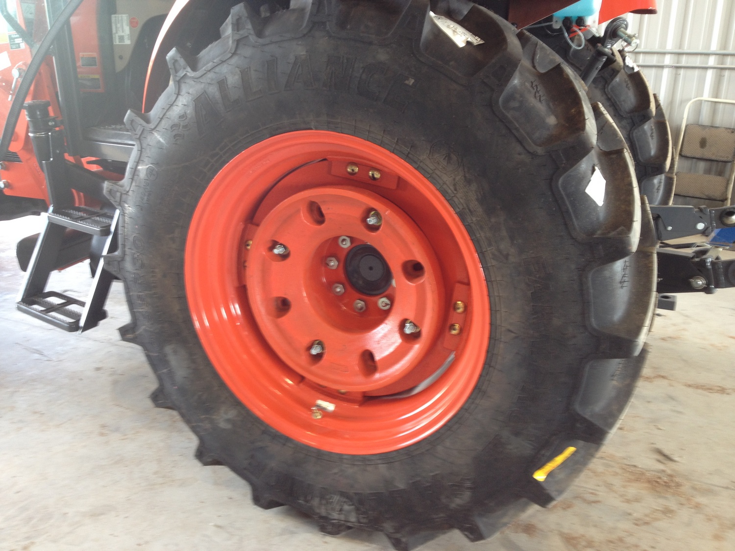

Here's a couple pics showing my current setting. Rim outward, mounted to inside of center disk. This positions the raised block away from the center disk. I mounted in this position to get the width I needed/wanted. Again remember, we don't care about the tire concerning the raised block discussion. Removing and reversing accomplishes nothing.
I'm attaching a pic from my owner's manual. It clearly shows the rim mounted in it's widest position, on the outside of the center disk, as being the farthest outward setting. So,,,, it appears the manufacturer is saying it doesn't have a negative effect to mount the raised block on the rim tab against the center disk??
No argument here, just discussion. Hard to dispute the facts of the pictures posted so far. :)
Again, remember one thing. When a pair of directional tires are mounted on a pair of rims there's only one standard the MUST be met. They need to be mounted in opposite directions from each other. After that nothing at all matters. And they never need removed and reversed for any reason. Proof of that is in this manual picture. No where does it mention tire rotation direction. Doesn't apply. :)
