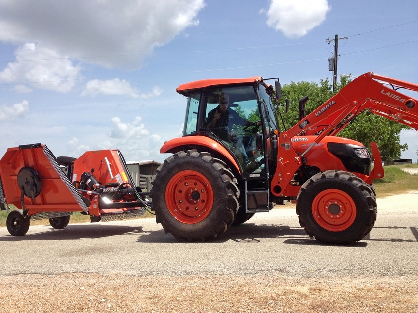

No - I don't think anybody has their shorts in a twist.
Agreed, no twists here. Im happy with the spacing I have for now and if I ever get a flat I and have to pull a tire off, I may add more spacing at that time.
Until then ole Texasboy is a happy camper, I got A/C and a radio ! :cool2:

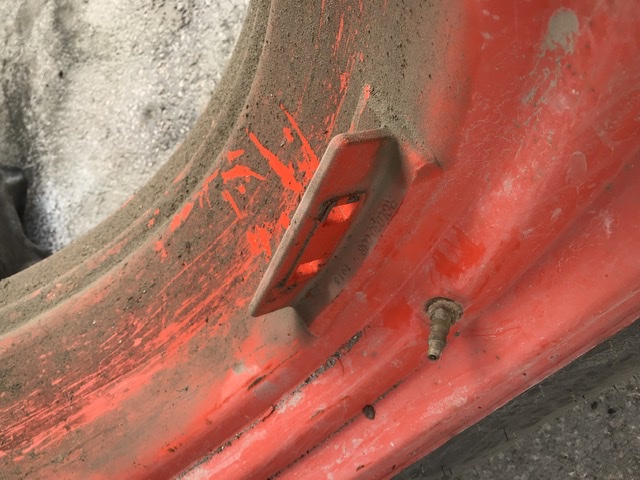

As I explained earlier in this thread, with the raised boss on one side of the tabs limits the options you can do. This is the point many are missing. As the tractor sits now, we did indeed take the left tire and move it to the right and the right to the left. And doing so gained us what appears to be a bit over 2" on each side. But that raised area on the one side of the tab limits how many options you get without taking the tire off the rim and moving it the other direction. That raised area cannot be put against the wheel center.

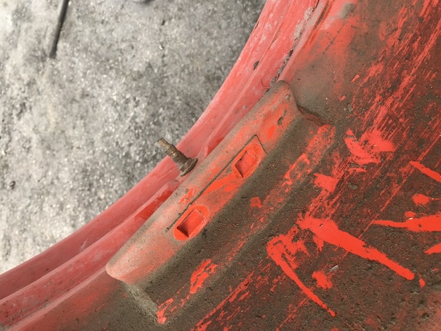

Hi Tex et el
sorry to drag up an old thread but it was one i found while searching on how to widen my tires and i want to share what I learned.
I have cast centers. I was seeking to have the width Herky has....
it would have appeared from your pic that i couldn't get that due to that raised spot on the tab. Well, once we lifted the centers out of the rims, low and behold, both sides of the tabs have that raised area.
I'm able to let you know that you can get 8 positions with the cast centers.... the cast dish can go on either side of the rim's tab.
I can say that this project was not hard but needed big equipment to lift the disks and rims, it's all heavy.
It made a huge difference in handling of this tractor. it feels how a tractor should, it seemed very tippy in in the narrowest setting.
That is great information to know and no way to get it without all the heavy lifting involved. Thank you.
How did you lift and handle everything? Any unforeseen problems? Any advice to someone who might be planning such a move?
   / M7060 & rear wheel offsets
#55
Hey Thunderchicken, thanks for posting that. That really IS good info. Thats really bizarre that the load from the tire is all put on that small raised area. I would have never guessed it was that way on both sides, so thanks for taking time to post that. Now we all know! Thank you sir !!
