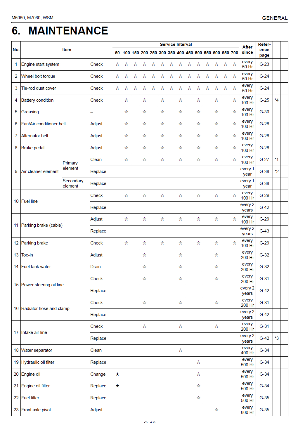

I've got a 2019 M7060 and WSM 50 hours is engine oil and filter, hydraulic filter change but not the oil, grease, inspect, check air filter, tighten bolts. Nothing really till 200 hours
   / M7060 Rops 50 hour service... $1100?!
#12
M9960 owner's manual specifies hydraulic/transmission to be changed at 50 hours. Would certainly expect 7060 to be the same.
SDT
I've looked twice now in the manual and there is nothing stated about tranny oil. Engine oil, wheel nut torque and looking over a few other things and that's it.

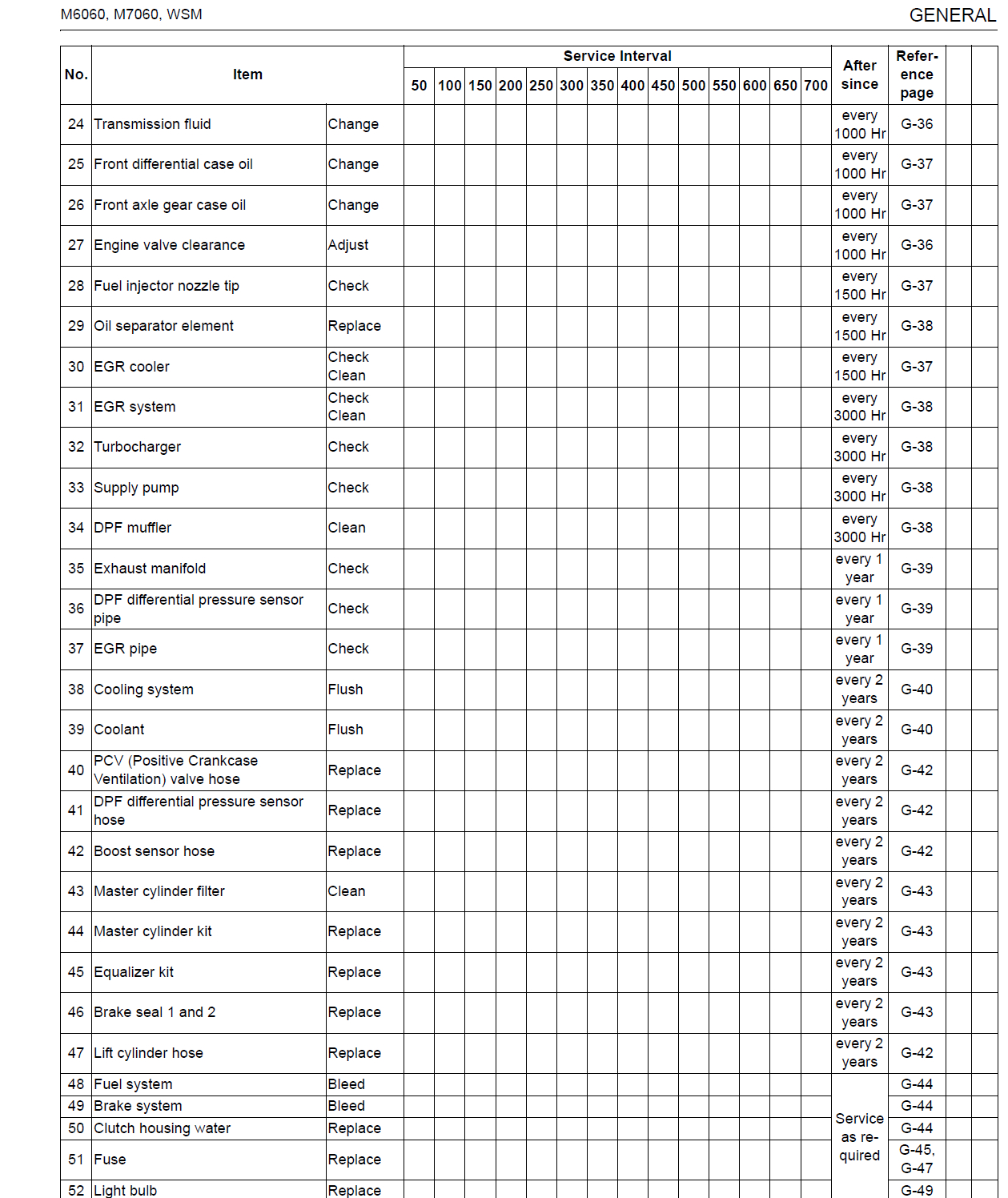

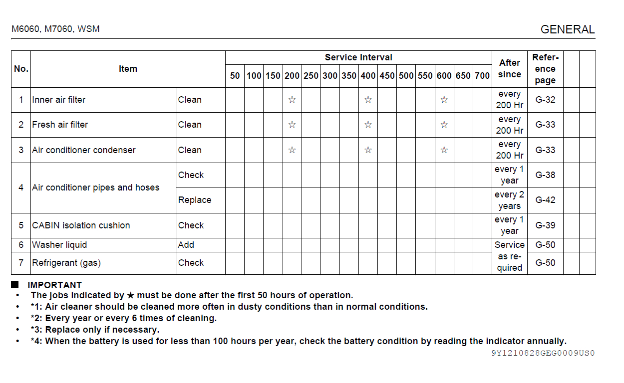

   / M7060 Rops 50 hour service... $1100?! #13
Here the scheduled from the WSM
