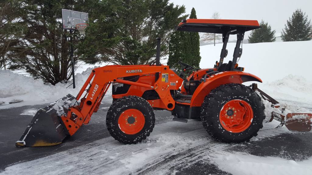

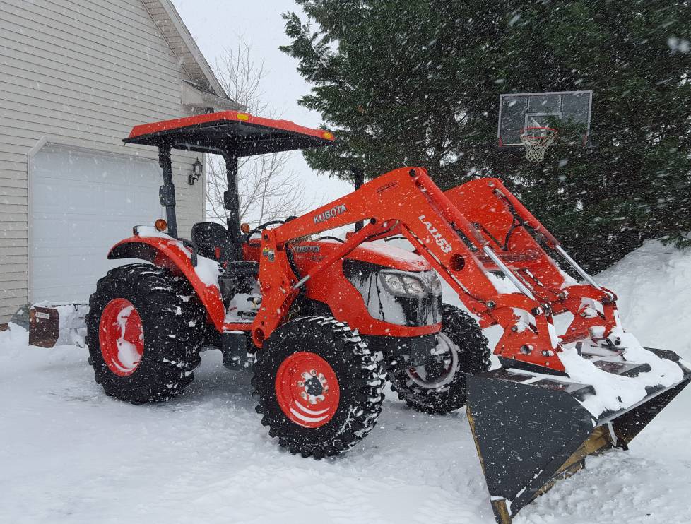

I had R4's on my m5040 for 10 years. They wear very well. Lots of snow...no issues 20170315_103403.jpeg20181224_113815.jpeg
