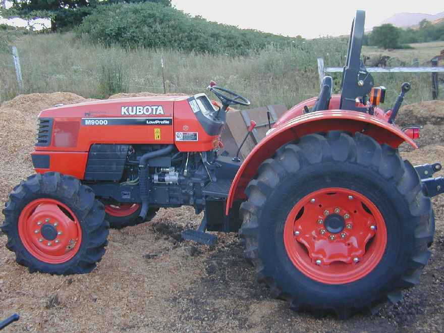

Attached is a picture that I have posted many times but it's the only one handy. Sorry

I think you forgot to attach the picture.
But in the meantime, here is a picture of my 1989 Kubota M8950 and 15' Rhino mower. My Kubota has just under 8000 hours on it. Still runs great!
   / M9000 50hr service
Wow Dave 8000hrs. Thats great!! I figure that I will only put on about 250hrs a year so it will take me awhile to get to that count.
Sorry about the picture. I'm not sure what happened. Let try again.
Eric
