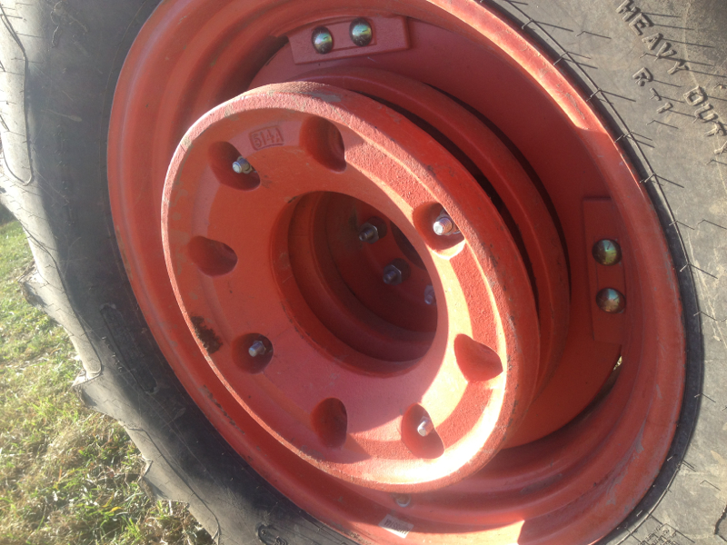

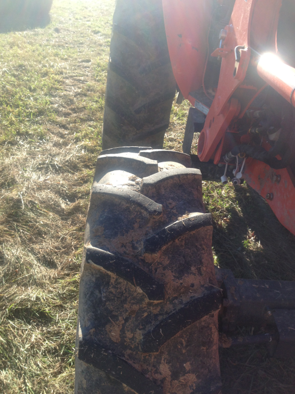

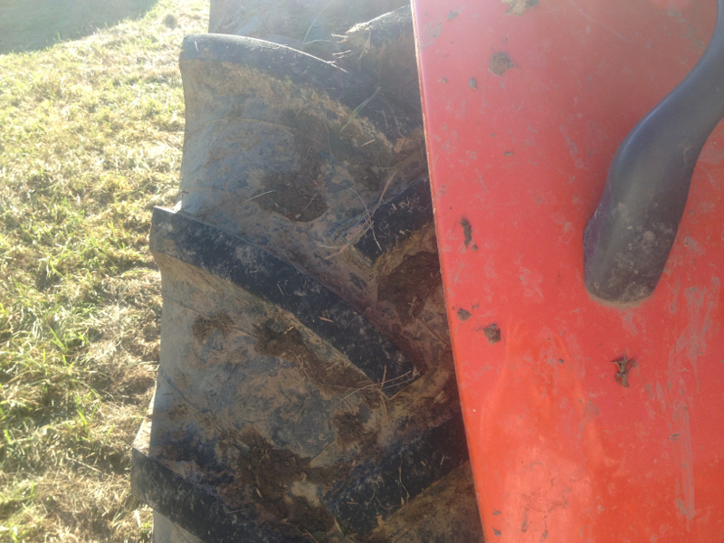

I took some photos of my wheels. The outside edge of the rears seem to track the outside edge of the fronts. I think both could be set out one notch farther if desired, maybe two on the front.
BTW, I have cast centers, two sets of cast weights and fluid in the rear.
As for the 12 speed, you'll always have a perfect gear for what you are doing. They also have an increased lift capacity on the 3pt hitch. 8,600 lbs vs 5,610 lbs with the standard 8 speed.
