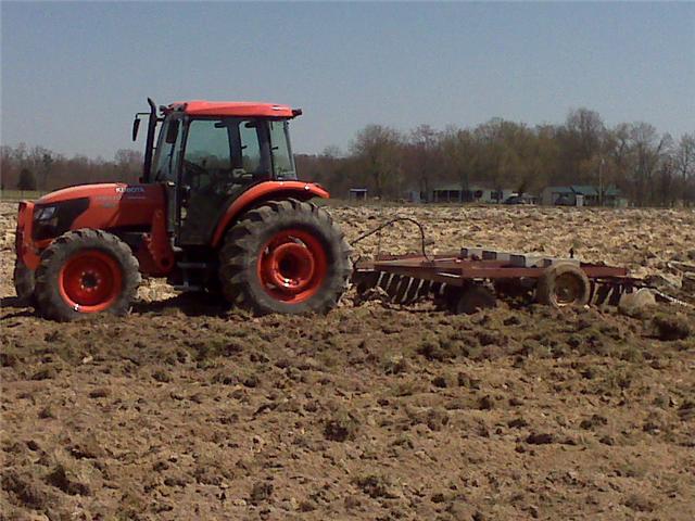

   / M9540
#20
I really can't say. I have since added additional rear weights for traction control when plowing. Also when loading hay to go out I no don't have to have one on the rear anymore. FYI with the added weight the vibration has completely stopped. The dealer said it was the NEW wearing off the tractor. (Not sure I believe that, but it has stopped.) Here is a pic of the rear weights, I was discing, sorry for the low quality phone pics.
