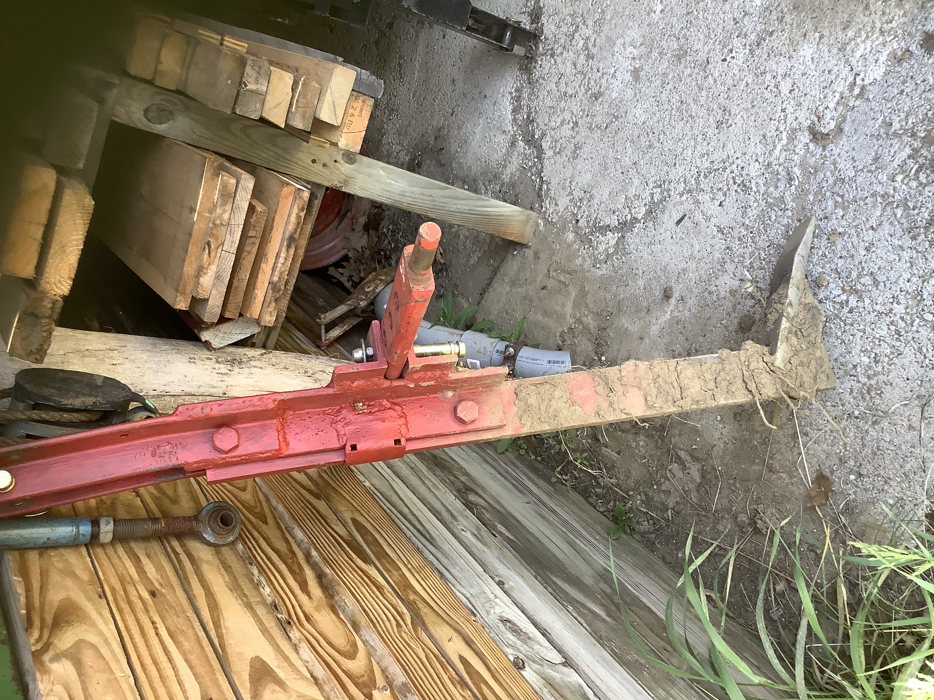

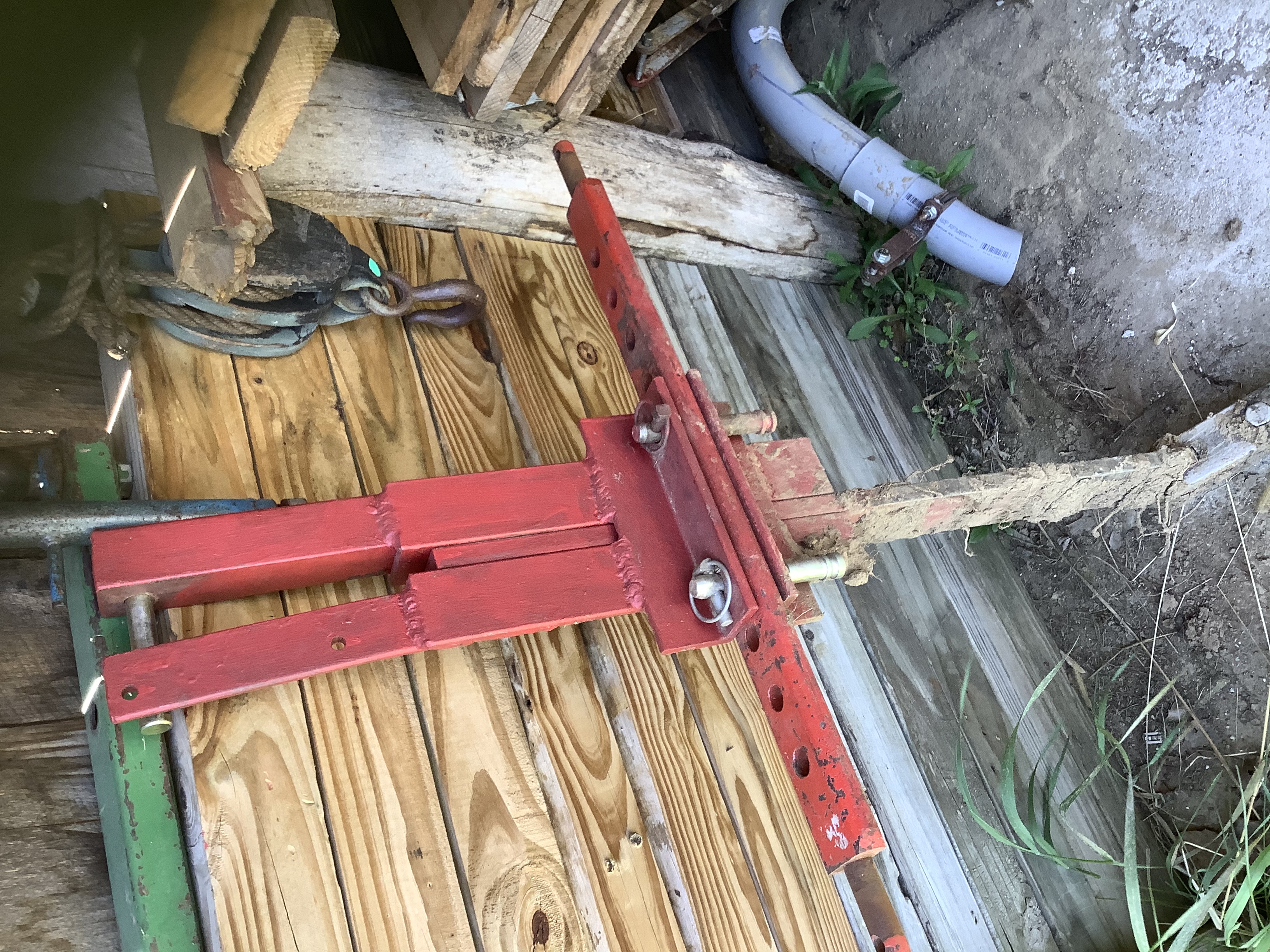

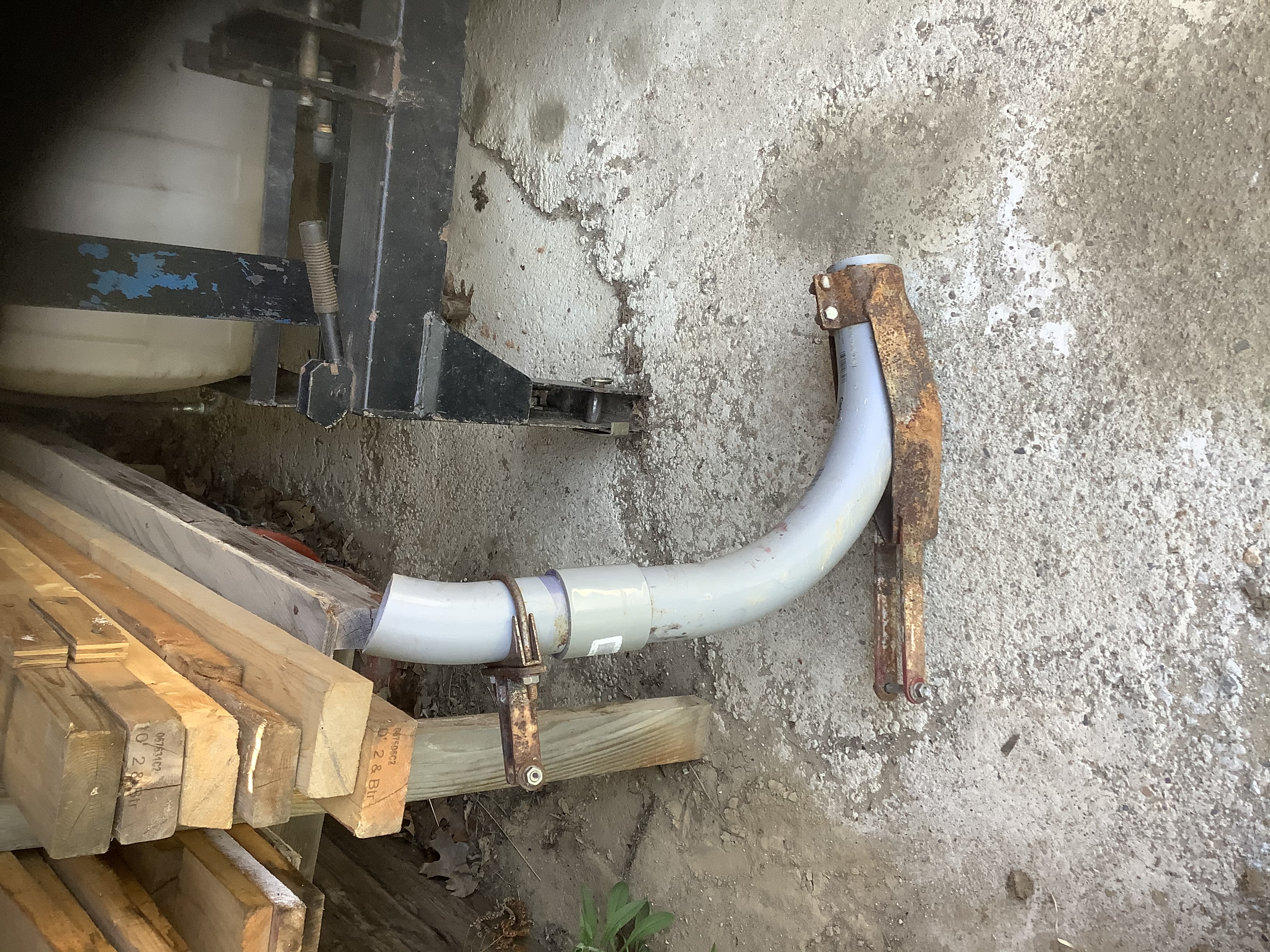

No trencher for me. I just pulled in about 800 feet of 2-inch PVC 12 inches deep with my subsoiler, in individual pulls up to 300 feet each. Have done miles of smaller diameter PVC the same way, as much as 900 feet per pull.
The subsoiler shank needs a sharp vertical front edge to slice the ground neatly and help cut through any tree roots. It creates very little ground disturbance and no backfilling is required.
Dry ground creates lots more drag on the pipe so moist conditions are best.
