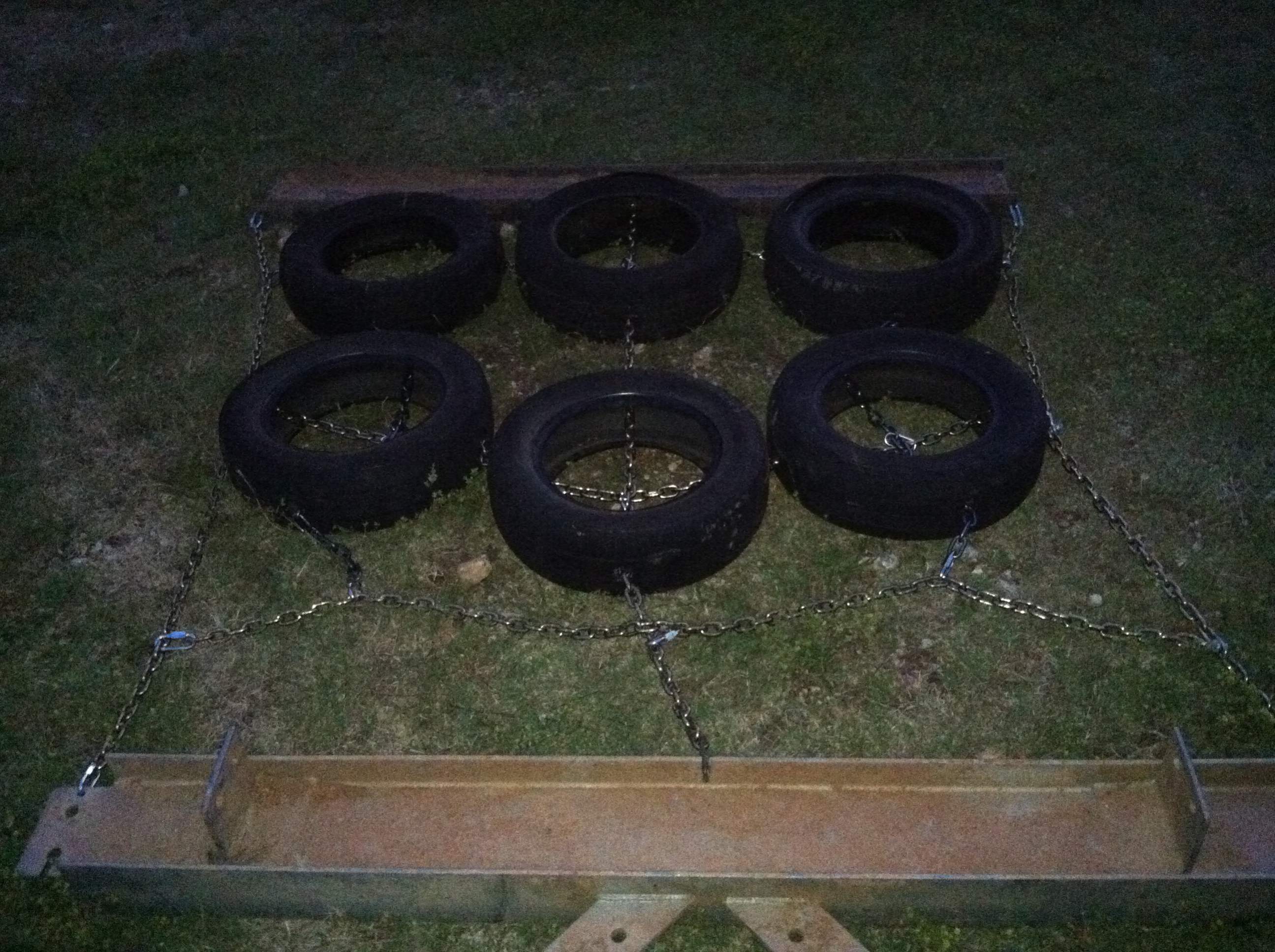

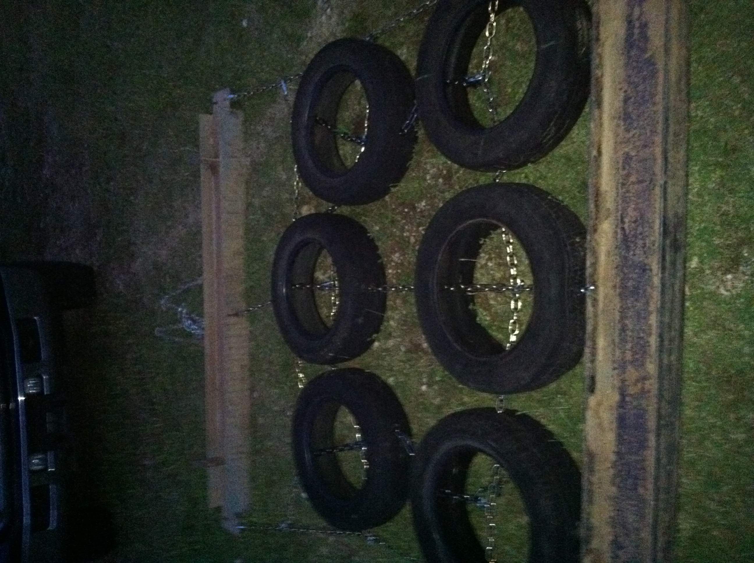

Here is my recent build using some scrap I beams, chain, and links. Tossed in 6 used tires. Was really cheap to build and works great for smoothing disked fields. I pull it with my tractor some but more often with my truck. I also made similar ones with heavy angle iron. As I pull it from field to field, it also cleans and smooths the roads. sorry about the poor pictures, but it was late and my cell phone camera.
