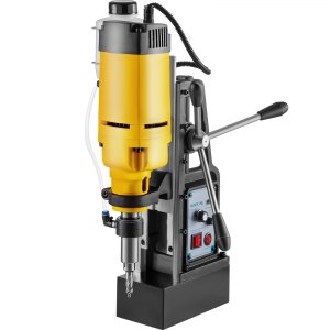

If anyone is looking for a discount on a 'basic' non reversible MAG drill Vevor has a 5 day sale on the model I spent just under $300 a bit over a year ago.
This one is variable speed 0-300RPM
It has the higher power magnet than some other models they sell, along with having the high power 1680 watt motor.
Rated for a 2" cutter and whether good or bad is heavy built at just under 50lb. So not great for placing it in out of position places..
47% off imo a bargain @ $151

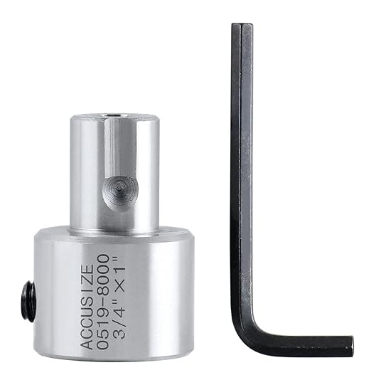

Replying to an old thread, but if you have one of the vevor mag drills with the Nitto quick change shank, this adapter should let you use regular Weldon style (read less expensive) cutters, if you have enough quill height available. Currently ~~$41 at Amazon (4-13-25).

Good post / paste but I use the Hougen Nitto shanked carbide tipped annular cutters. I kind of prefer them simply because while they are expensive. Hougen is a local company for me plus I can buy them direct from them.
The advantage to the Nitto shanked cutters over the Weldon shank cutters is there is no runout with them at all. The setscrew attached Weldon shank cutters will always have some runout simply because of the way they attach to the spindle.

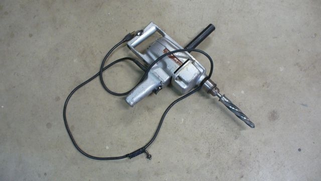

My old work horse (Montgomery Wards/Mcgraw-Edison) ) and 7/8 inch "bridge reamer" learned to dislike tools with specialty chucks that were non standard when in work world I need something and "management" could not get it for me..... Jacobs chuck is winner every time....
I have one of those too, Dad bought at a hock shop back in the early 50's. Those babies have some real torque..!! A buddy of mine was looking at one at an auction we attended 20 years or so ago, only it had a pipe handle on it that had to be 16" long. I told him they are one heck of a drill. He ended up buying it because it went cheap. He said the first thing he was going to do, was remove that long pipe. I told him to leave it on there, it's one there for a reason, because if you don't hold onto it. it will hurt you. He laughed it off because he's a pretty muscular guy.
Fast forward 3 months, saw him at another auction, he said you were right about that drill. He was drilling an old barn beam to hang a gate, bit caught, and handle came up and hit him in the jaw and knocked him out cold. Told me he's never had a man hit him that hard before. He said he remembered me saying to hang onto it, but apparently not good enough, but I do now..!!. Lesson learned..!!
Mine don't. I use Weldon cutters a lot in my mill. They make a cleaner and more accurate hole than any drill bit of equal size. I use an R-8 shank adapter. The dry adapter is a handful getting the "prickly" cutters in and out. :ROFLMAO: A whisp of WD-40 causes a heck of a pressure/vacuum. That's another benefit with the wet adapter with the coolant hole. If there's any slop at all, it's maybe a half thou. Coolant doesn't leak by.
I've been meaning to drill my dry adapter with a through/cross hole because of the mounting "problem". But I mostly use the wet adapter anyway.
