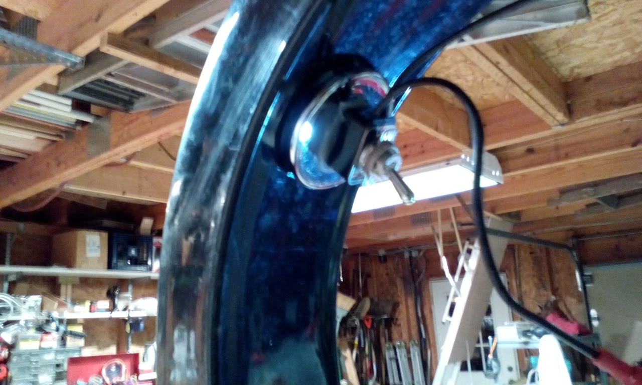

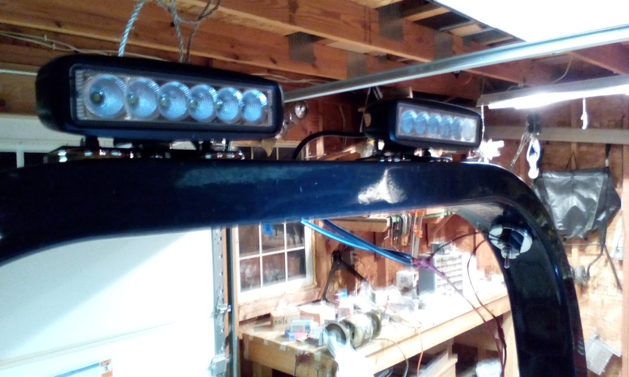

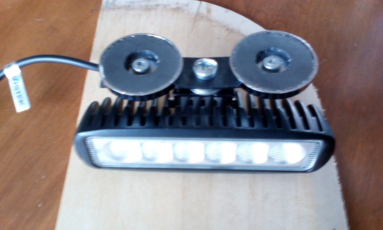

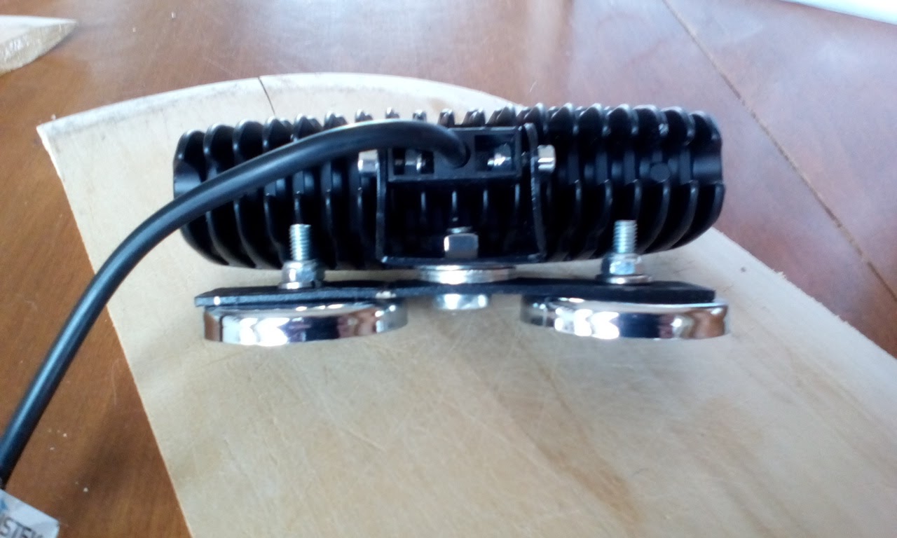

This idea and information motivated me to rig up ROPS lights for my Massey. Since the 2" magnets come in a set of six, I decided to just use two 2" magnets for each lamp which gives a wider footprint and more magnet-rops contact. I just used some metal strap I had to create the base as shown in the pics. This also gives a slight bit more height which allows full downward angle of lamps. For the switch, I decided to just use one of the remaining magnets as a base and mounted a simple toggle switch with plastic weld adhesive. Now all the components can be adjusted for position and easily removed. I plan to only use for winter plowing as I get into the woods quite a bit during summer and just don't need lights with the longer days. Thanks much for all the information and input on this idea. I love the magnetic aspect for the ROPS. I got both lights for $15 on Amazon.

This idea and information motivated me to rig up ROPS lights for my Massey. Since the 2" magnets come in a set of six, I decided to just use two 2" magnets for each lamp which gives a wider footprint and more magnet-rops contact.<snip>
Do the magnets with a mere 35 lb pull do the job well?
The neodymium ones I've been buying from CMS are rated for 112 lb pull but are only 1.6" diameter.
   / Magnet Mounted LED ROPS Lights - PICS #45
No issues so far. Very strong contact. A wider surface area and two magnets reduces the possibility of breaking the hold (my theory).
