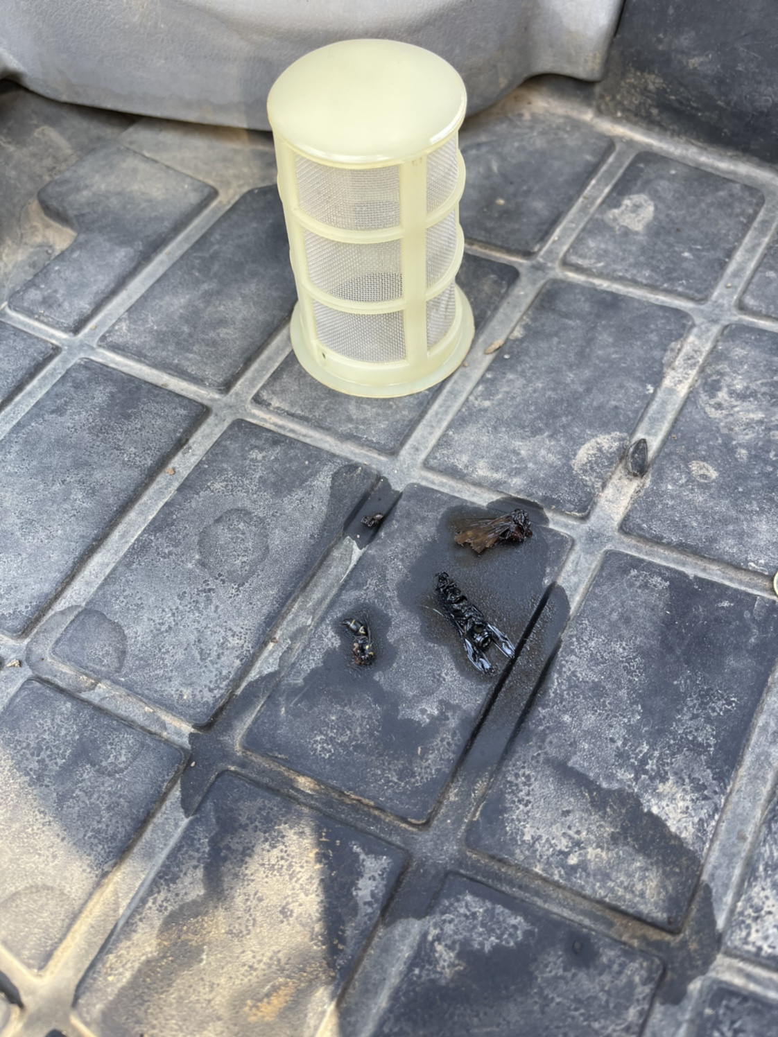

I started with the simplest fix (clogged fuel cap) first, wish it was that easy!
   / Mahindra 1526 clogged fuel tank #17
How would bee's get pass the tank filter, let alone the fuel cap, assuming both were installed. That a lot of insects.
At least one looks like a small hornet

In reply number seven, my hero, had the exact same thing happen and I used his remedy to resolve my issues. My best postulation would be the filter is shoved into the tank, true. Then the bees and hornets are attracted to the diesel in the diesel can spout, dying and then poured into tank.

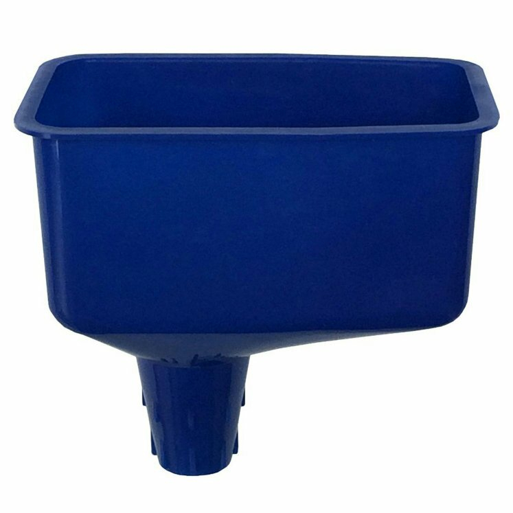

Not sure how you fuel your tractor but I use this type funnel which doesn't cause any issues with the tank filter, it doesn't go down very far and sits on top of tank opening and then I rest a 5 gallon container on the FEL arm.There like $2.00 at Fleet Farm.
