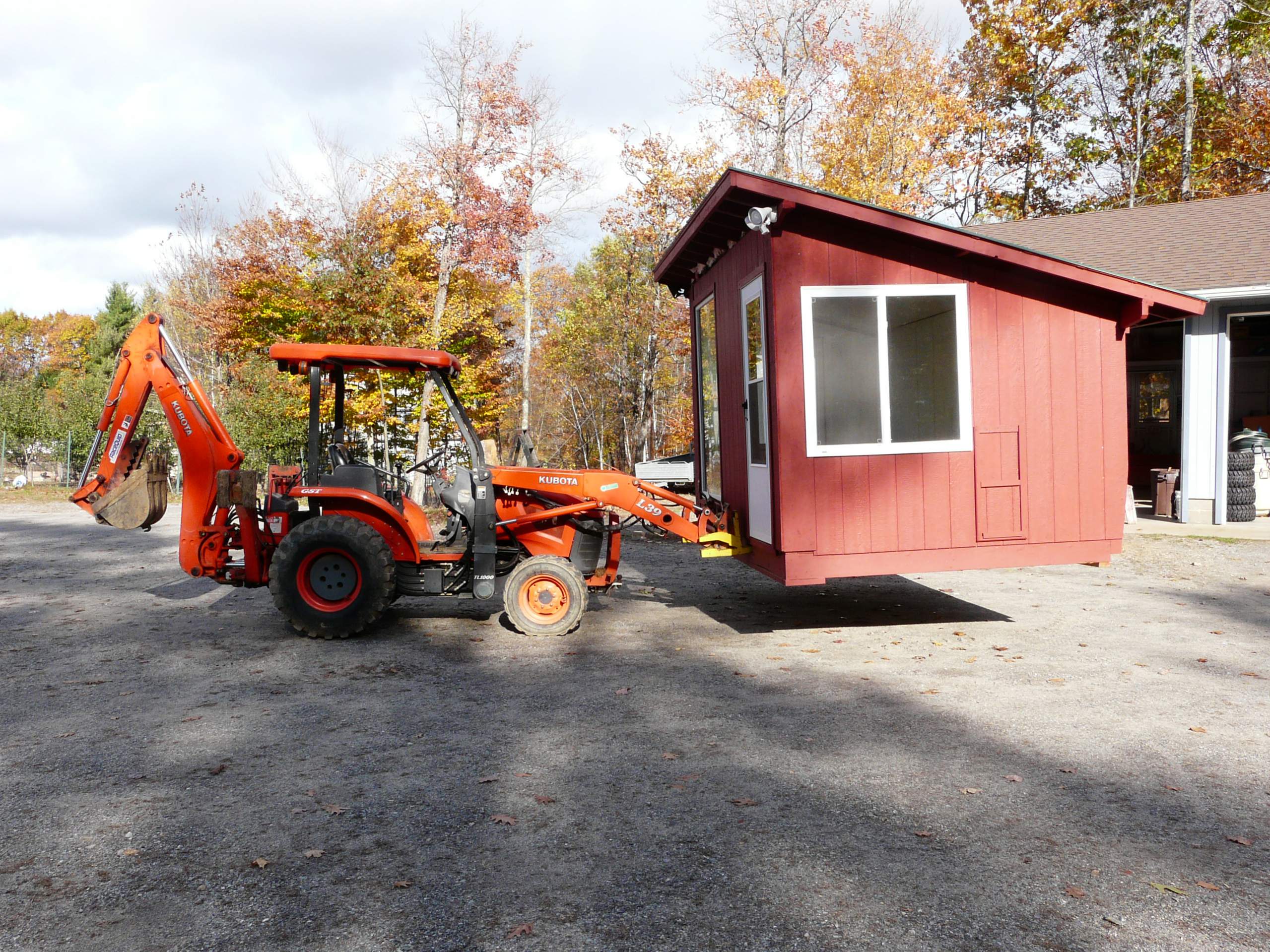

As a mechanical engineer for my entire career of over 40 years the factor of safety on a tractor axle I expect ot e at least 3, as bumps and shocks must be taken into account. so just don't get stupid with a lot of weight on the front axle and stop worrying.
