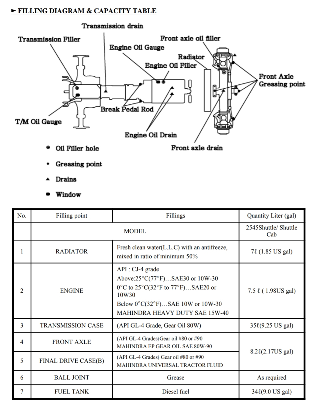

Wait, now i'm confused.. the chart in the manual states:
Transmission Case: 9.25gal gear oil 80W.
Final Drive Case: 2.17gal UTF.
Where is the final drive case? In the section on changing fluids it only mentions the transmission. And on the fluids pictorial diagram final drive case isnt shown, either.
I actually thought transmission fluid was shared with the hydraulics from skimming the manual.
[Edit] For clarification I added gl4 80w90 to the transmission as per the manual describes (at rear of tractor). I planned on ordering the 80W in bulk and doing the 50hr swap for transmission fluid early since I added some and potentially mixed fluids which I know is not recommended.

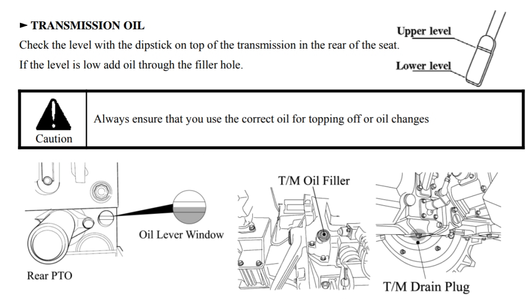

#118
To add to the trainwreck this thread has become, here are the items in question out the manual. I wonder why you use the dipstick to check tranny fluid level if there is a sight glass?
   / Mahindra 2545 on sand #119
I dont know which part of your manual to tell you to either ignore or interpret in some non intuitive fashion. That sight window looks way too low. Does it agree with the dipstick??
Final drives may refer to front. Does yours have planetary gear reduction out at the hubs? Those and the center differential fill separately.

I am beyond confused. The manual clearly states 80w in transmission. I just watched a guy do his 50hr service on youtube and he pumped it full of hydraulic fluid which is basically 10w-30.
Is there a separate sump for the hydraulic fluid? I'm about to go look at the tractor shortly. The manual doesnt seem to mention it..
