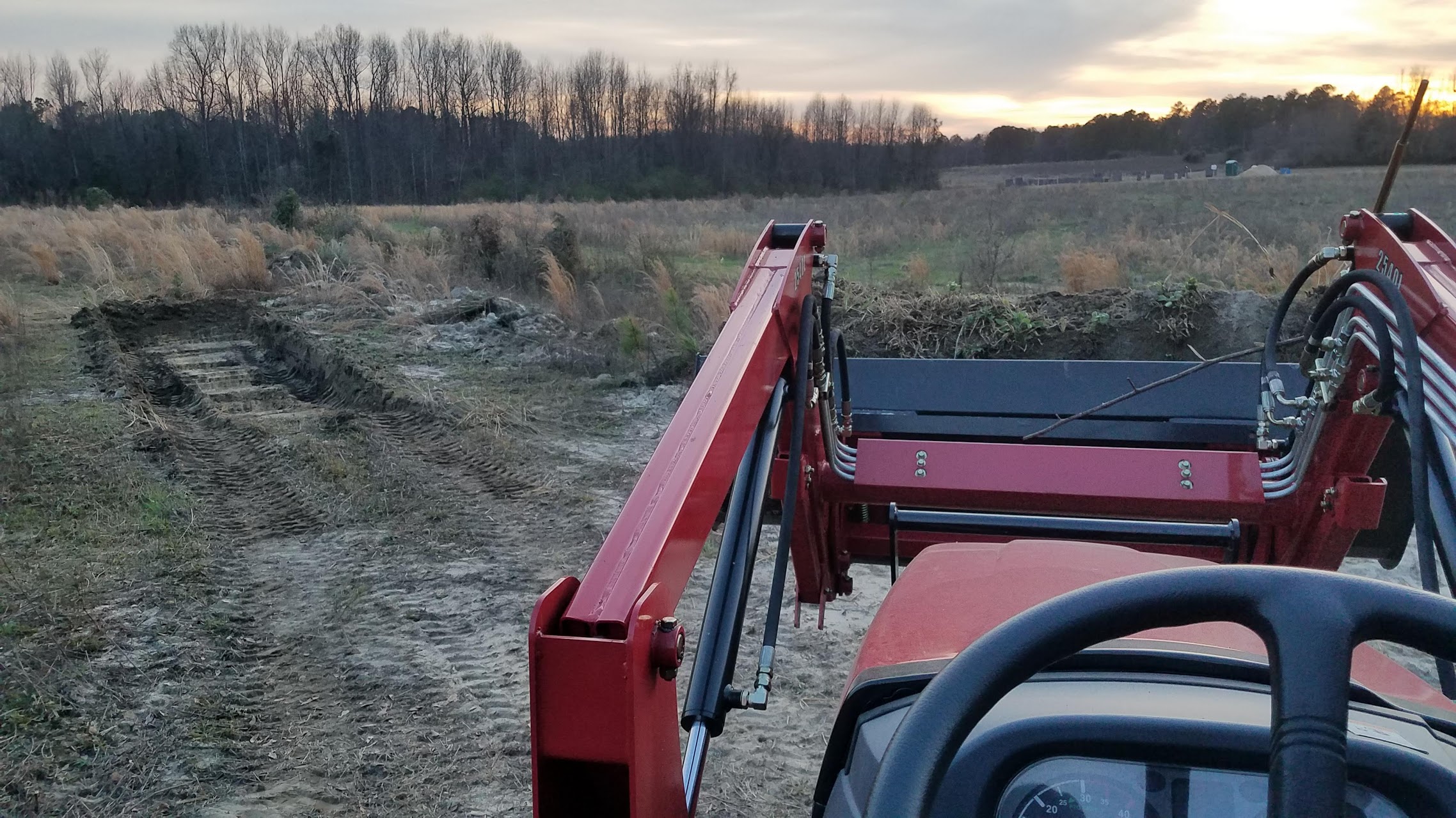

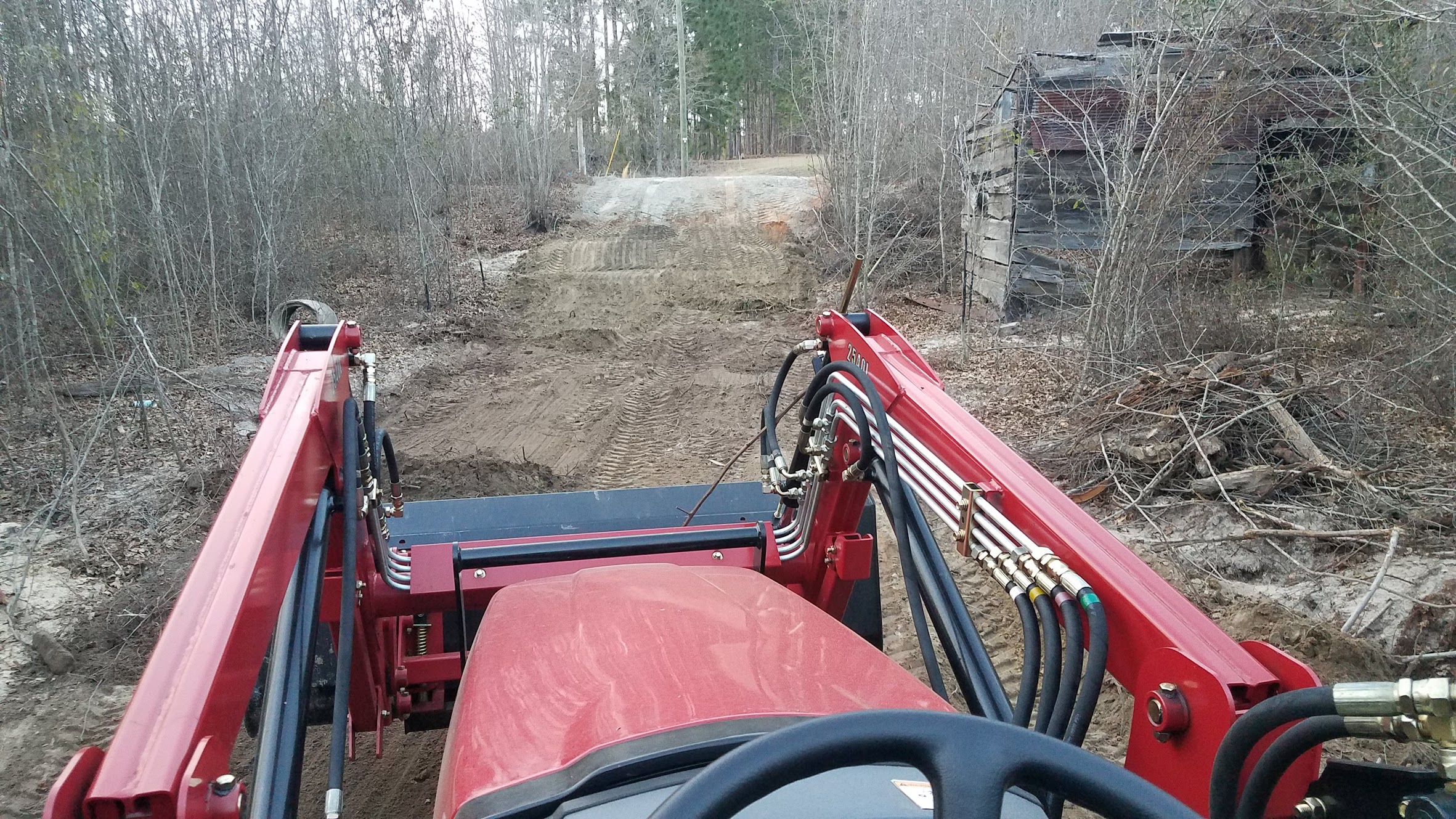

Valve and fittings come in today, I've been thinking about ways to fund a grapple purchase since I literally don't have a reason to buy one other than to clean up a bunch of dead trees at my mom's property. Come to find out, she was just quoted $5500 dollars to clear 15 dead trees, not including stump grinding. My buddy offered to spend a weekend helping me out and it looks like she is going to reimburse me the cost of the grapple if I get rid of the 15 trees for her. In this case I would actually get a good grapple (some of the trees are rather large).
I went ahead and told her it would be between $1500 and $2500 for a grapple after referencing everythingattachments. Anyone have any input on which grapple would be best for the 2545? It comes with a 66" bucket, I'm not sure if it makes sense to match the OEM bucket width or go more narrow. Also, I'm not sure if it would make more sense to get the wicked root grapple V2.0 or the wicked root rake.
Anyway, I did some FEL work yesterday, we got our driveway installed by the state. I'm filling in the incline with dirt from an area near the drainage ditch (I'll fill the hole back in with the junk I dig out the ditch). Pics attached.

Ah-h! I see you were smart and bought yours equipped with the SSQA carrier. I didnt see that you ever mentioned it . . . But essentially youre home free now. :thumbsup:
I think you will be near universally thankful in the future if you get a narrow strong grapple with one/center claw.
. . . Same capability and enhanced maneuverability over a wider one.​
Ive got a 60" bucket conversion for the 7520. That and the Tilt Tatch makes it surprisingly non cumbersome when obstacles are present.
