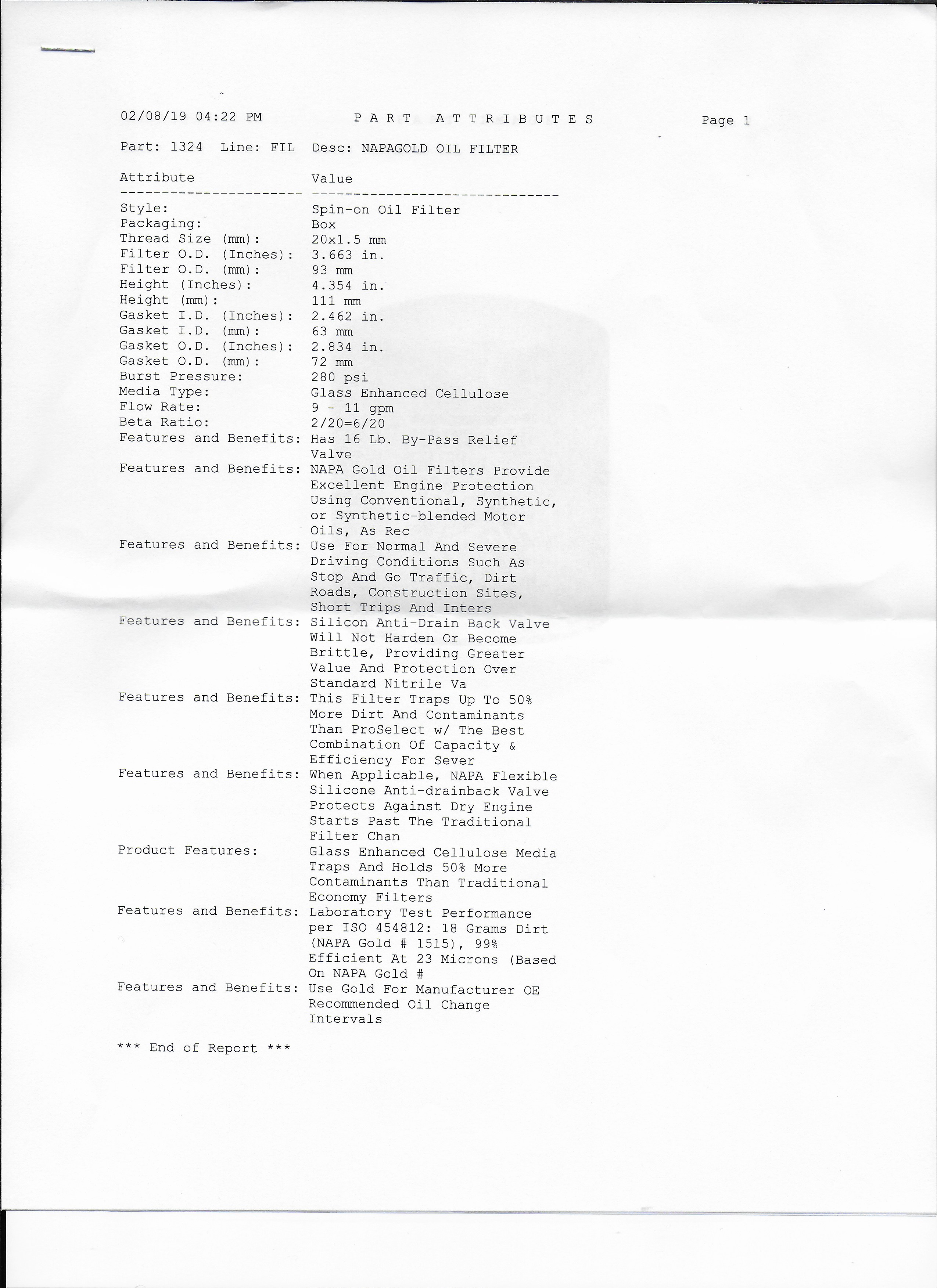

I bought the new oil filter, part # 006016642V91 that Mahindra is recommending for the 2555/2655 tractors. It's a shorter filter than the older part number 006008803F1. The new filter cost $30.19 and shipping/tax was another $15.75, $45.94 total. Just too much money! I took my new Mahindra engine oil filter to NAPA today. They researched the filter and found one that looks very close. The center threads on the filter are 20x1.5 mm. The NAPA Gold filter part number is 1324 and it's under $8.00. The gasket matches up perfectly to the Mahindra. I list the fact sheet for this filter. Please read it and let me know if you think this filter will replace the Mahindra on a 2555 HST. I'm not sure about how this specs out to the new Mahindra oil filter.
I did call Shell customer service and they recommend their T6 Shell Rotella 5w-40 full synthetic oil in the Mahindra Tier 4 diesels. This oil has an API CK-4 rating, the same as Mahindra brand oil. Thanks!
