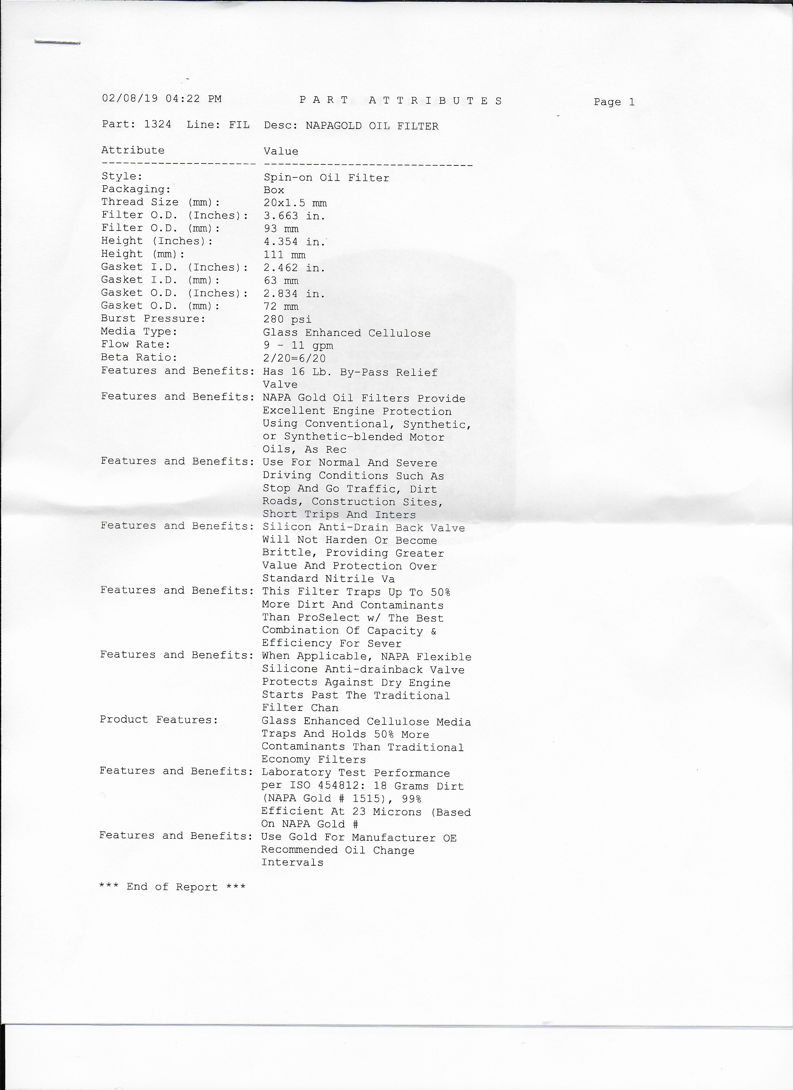

I bought the new oil filter, part # 006016642V91 that Mahindra is recommending for the 2555/2655 tractors. It's a shorter filter than the older part number 006008803F1. The new filter cost $30.19 and shipping/tax was another $15.75, $45.94 total. Just too much money! I took my new Mahindra engine oil filter to NAPA today. They researched the filter and found one that looks very close. The center threads on the filter are 20x1.5 mm. The NAPA Gold filter part number is 1324 and it's under $8.00. The gasket matches up perfectly to the Mahindra. I list the fact sheet for this filter. Please read it and let me know if you think this filter will replace the Mahindra on a 2555 HST. I'm not sure about how this specs out to the new Mahindra oil filter.
I did call Shell customer service and they recommend their T6 Shell Rotella 5w-40 full synthetic oil in the Mahindra Tier 4 diesels. This oil has an API CK-4 rating, the same as Mahindra brand oil. Thanks!
View attachment 590903.
I wanted to add some info on my post. The NAPAGOLD 1324 engine oil filter is use on many diesel engines. Kioti tractors, Bobcat, Isuzu diesel, Ford small diesel, Dodge diesel and several more. I didn't install the NAPAGOLD 1324 at this date, but I plan to use it. Does anyone know any filter specs on the Mahindra engine oil filters? Thanks!

The Mahindra engine oil filter, part # 006016642V91is made by Mahle Corp. Their part number is OC 1139. I called Mahle USA and they said they manufacture this filter for Mahindra and it has a copyright on it. No specs are available.

Thanks for the info. That's about what I did. I took the new Mahindra engine oil filter to my local NAPA store. The counter man, who I'm friends with, researched the Mahindra filter size in his book and he came up with the NAPAGOLD 1324. I have been trying to get the specs on the Mahindra filter, like the pressure relief valve, if it has one and flow rate. I want to try the NAPA filter, but I don't want to damage the engine. I really don't see how the NAPA filter could damage it. Any thoughts? Take care!
