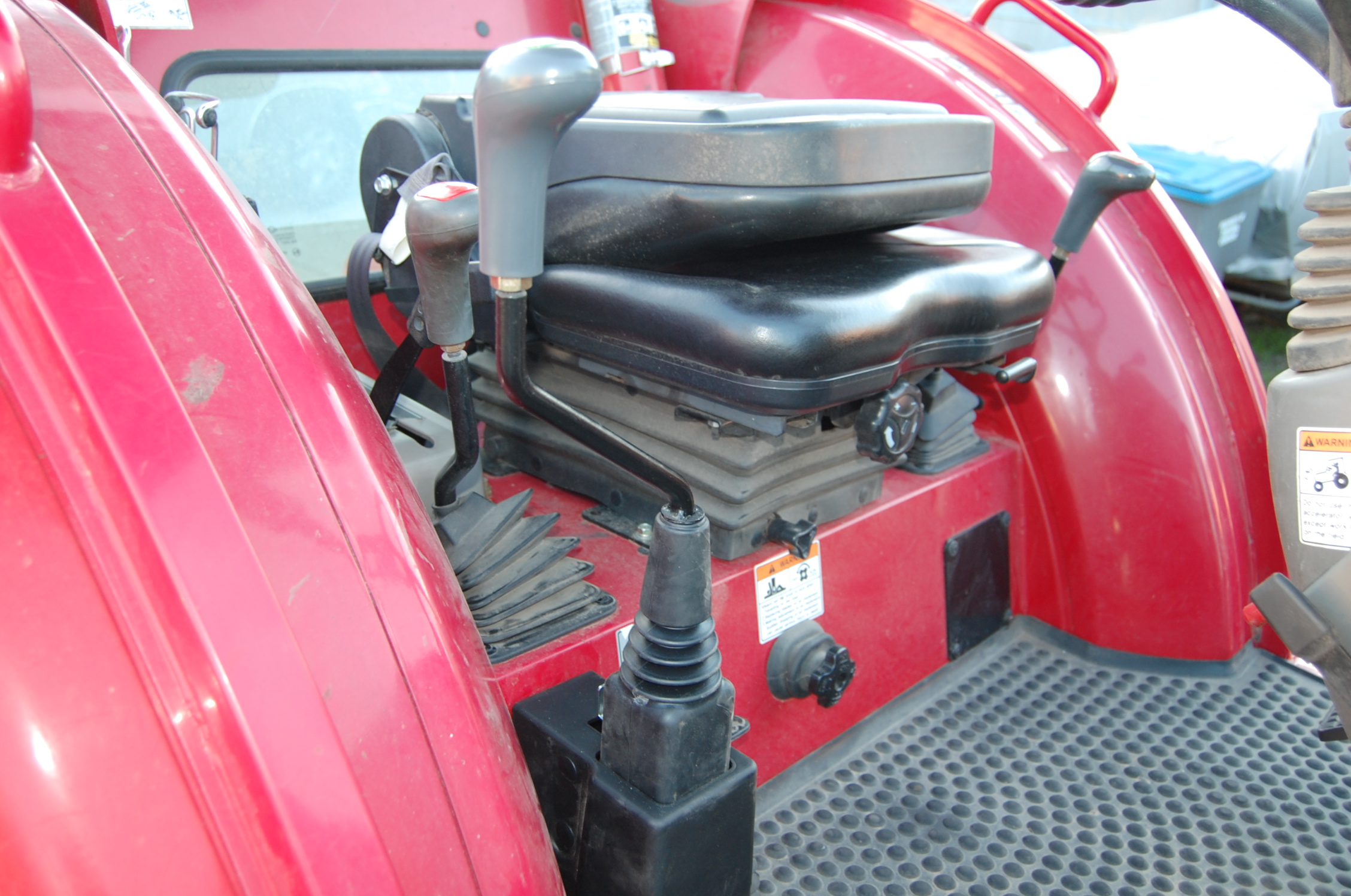

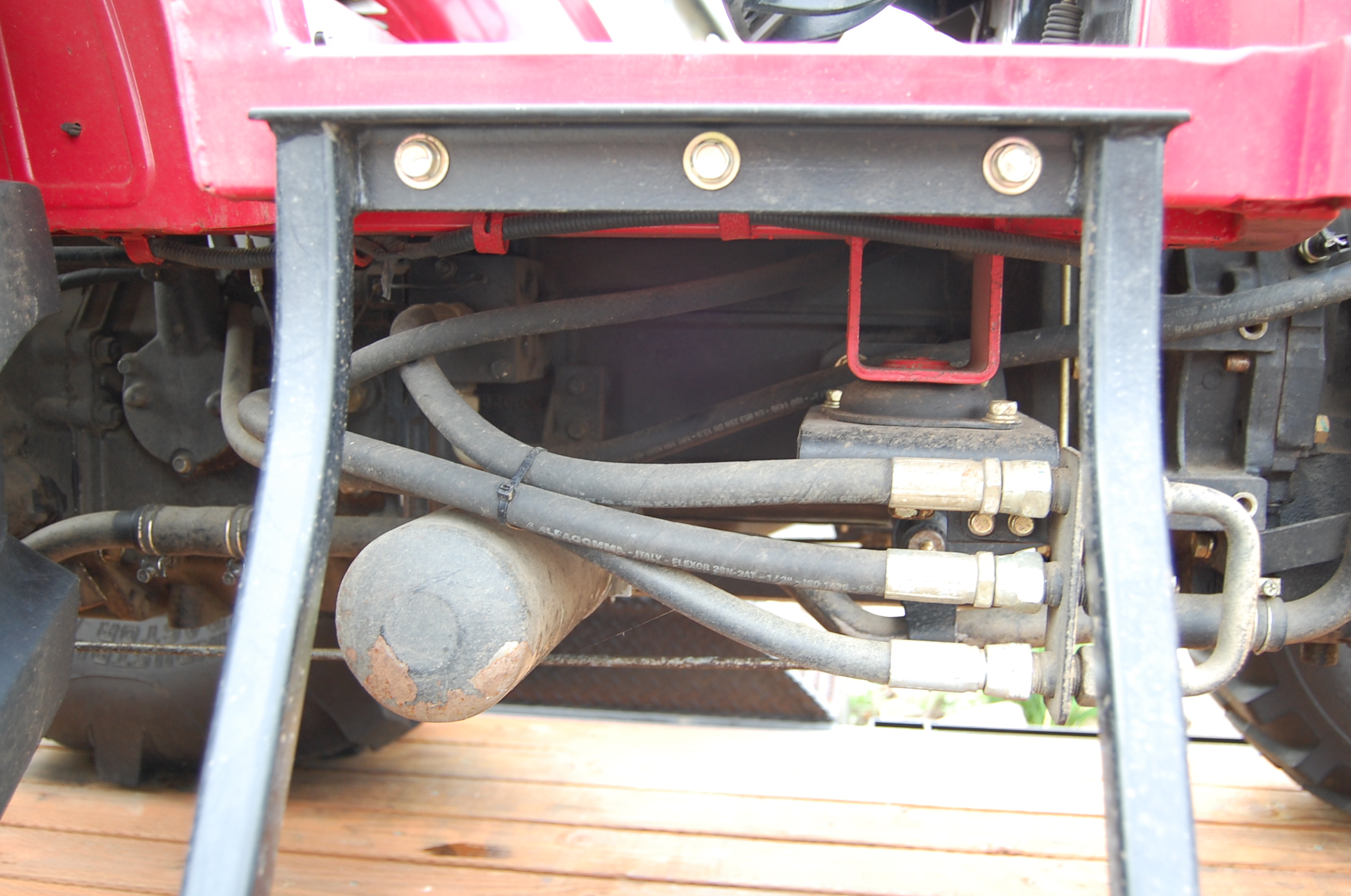

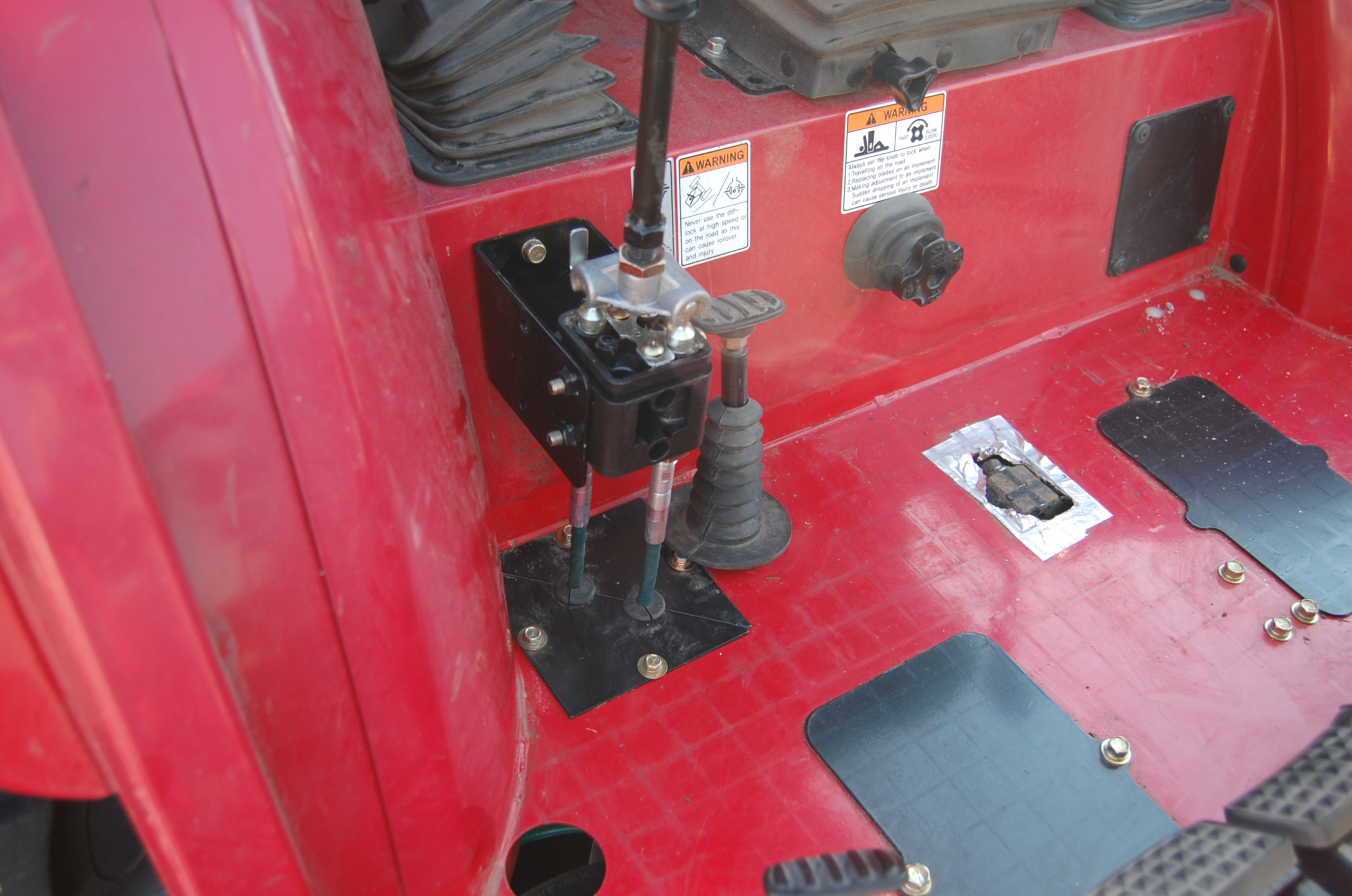

   / Mahindra 2555L Loader - How many positions is the loader controller? Relocation ? #12
O.K., finished the joy stick install today (relocation) on my 2555L. Here's a few pics.

Is there a reason you chose the T454 over the T554 parts? Or are they the same ? I don't have a TYM dealer nearby so I will either have to drive a couple hours to get the parts or find somewhere online to order the parts. Do you have a list of the parts you ordered ? Did you purchase them online somewhere or at a local TYM Dealer.
TYM/Mahindra. TYM O.E.M parts (TYM T454 tractor) and Mahindra 2555/2565 CL
   / Mahindra 2555L Loader - How many positions is the loader controller? Relocation ? #19
They should be the same. Only difference between the T454 and T554 is a turbo that make 10 more hp.
