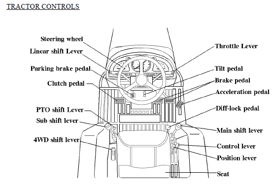

Is there a lever for the locker i keep hitting or is it mechanical and locks when it feels spinning?

It located direct behind your right foot. It's lever you push down on with your heel to engage the diff lock.

I'm missing the lever. See a shaft sticking out that moves in ant out about a inch, is that how it engages?

Should be a flat pedal that you step on with your right heel pressing it towards the ground. If you don't see that then something is amiss.

Does anyone have pictures of the pedal so i can try to see how it works? Trying to figure out how to make a pedal.

Here's a pic from the Service Manual for my 5005 (4055, 4505, 3505 & E350). Fig 14 below shows the pedal, it may be similar on the 485.

It's located on the right side behind the heel of your foot.
