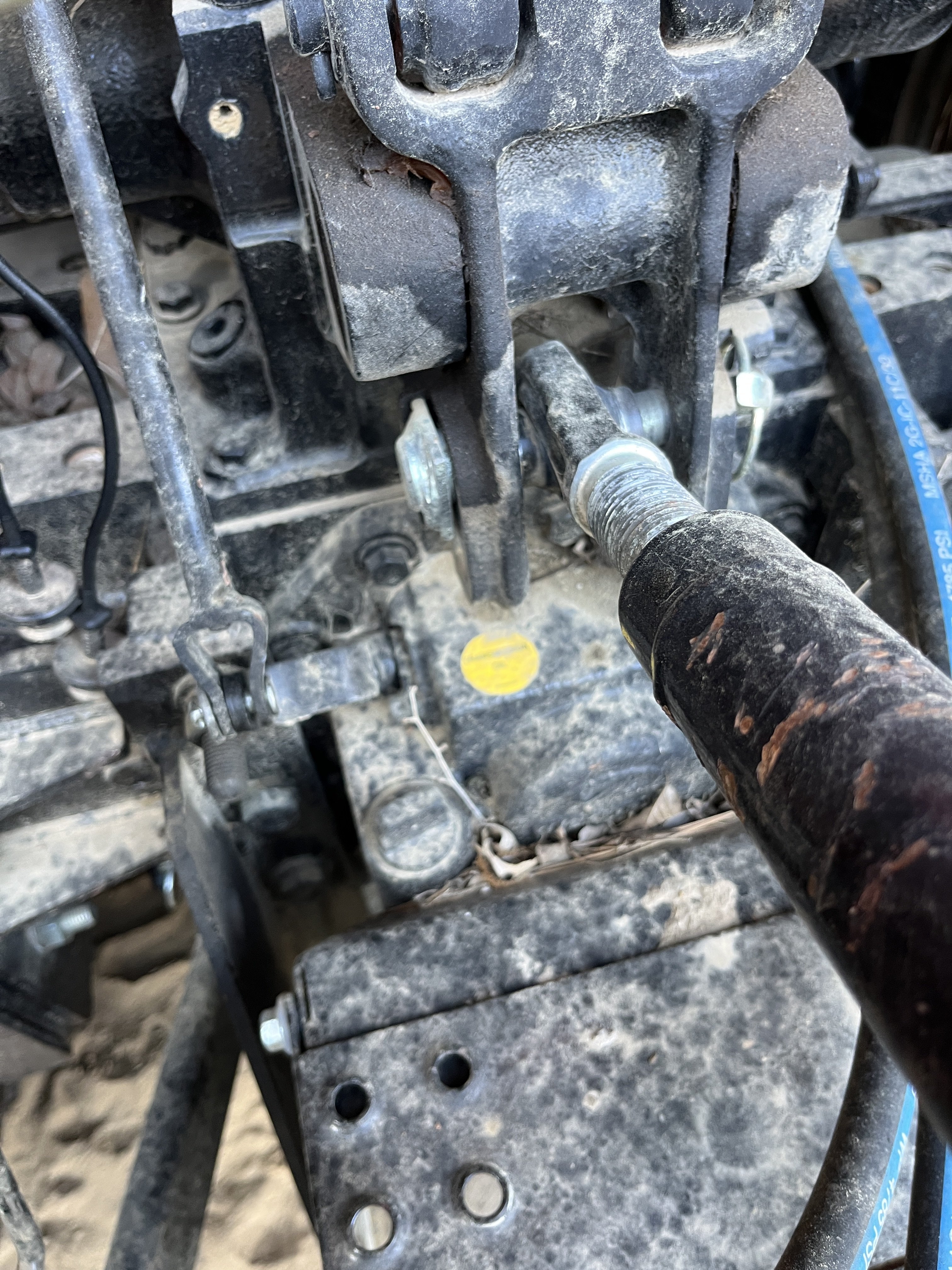

I am mounting an auxiliary, two spool, control valve on my Mahindra 5145. It is an open center system. I have to run a hose from the "t" port on the auxiliary valve to the fluid reservoir, which is the transmission/differential housing, on the tractor. I have looked more than once and can not find a plug or anything similar to connect to.
Can anyone tell me where I can attach the hose to the transmission/differential housing to return the fluid on the 5145 Mahindra?

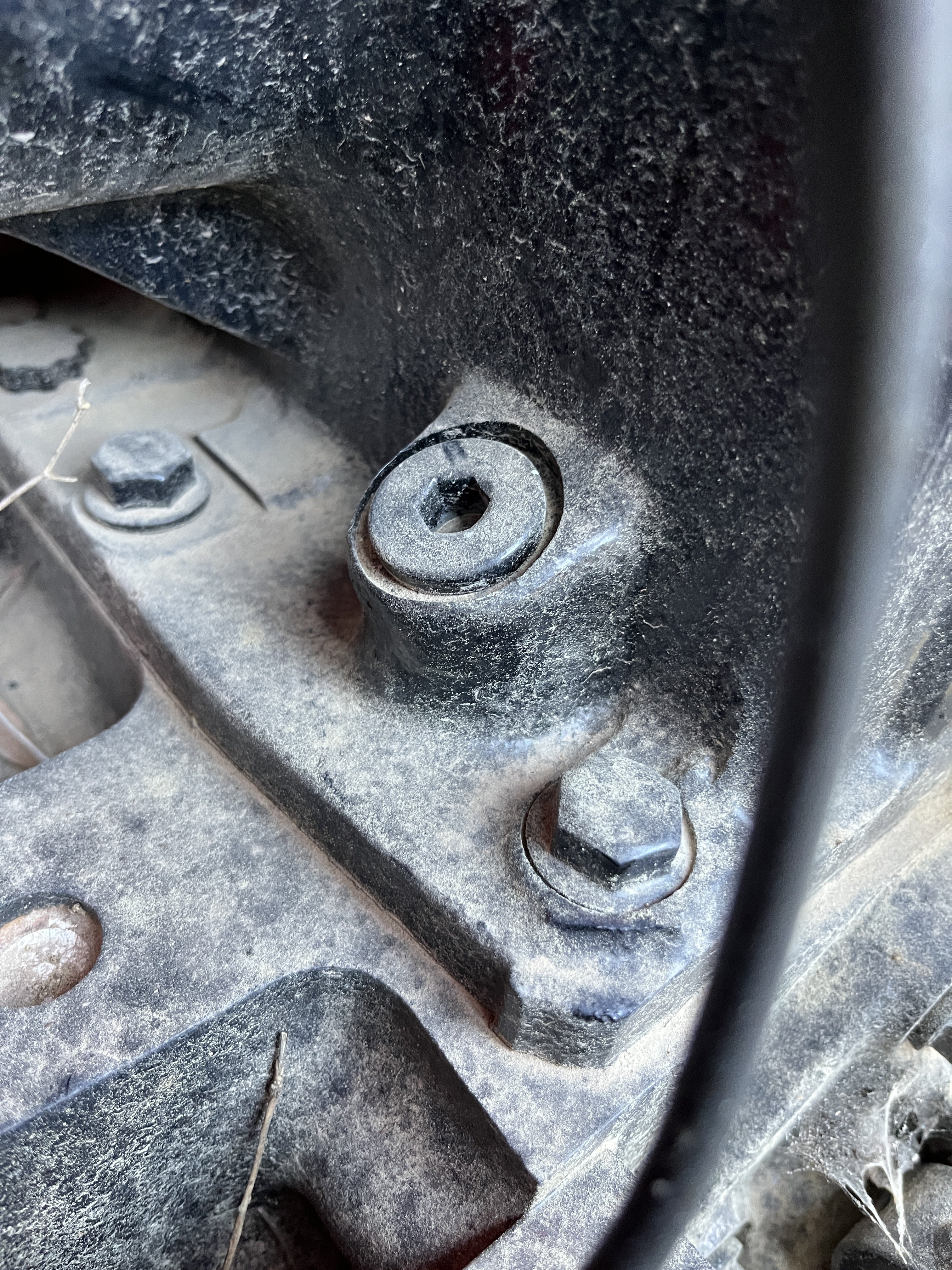

   / Mahindra 5145 Hydraulic Fluid Return Port
This is the only plug I can find. I am pretty sure it opens into the differential housing.

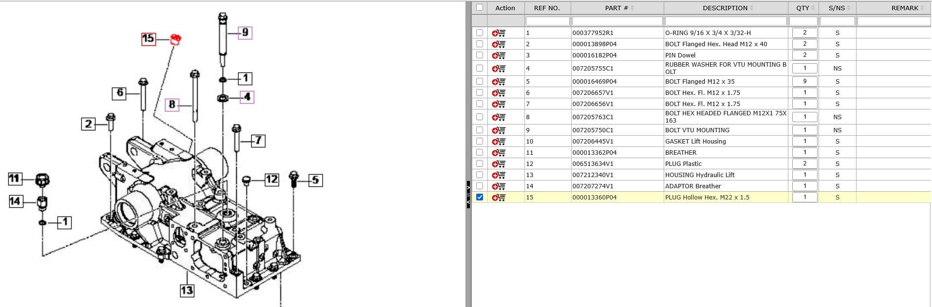

   / Mahindra 5145 Hydraulic Fluid Return Port #5
That could be it indeed. Accordingly to the parts catalog, it's just a plug (#15) and not some sort of valve. Looks like the threads are M22x1.5.
