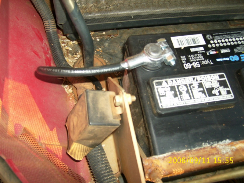

Get the quality ends that are crimped on or soldered on. I solder these on, heat the end with a torch, melt solder in end, fill half way full, then insert wire into molten solder. Wear gloves and hold end with a vise grip. I also use large heat shrink tubing to seal connection. Install the felt washers on the post and spray the terminal with the thick red protective coating, this will outlast the cheap factory connections.

I had a similar issue with the negative side and I was able to just replace the whole short cable with a new one. Since your dealing with the positive side I think your only option is to replace the end.

My 3016 wouldn't start this weekend. Checked the battery and the terminal bracket was corroded away. The problem is the bracket is a think piece of metal instead of solid metal like car brackets. Dissapointing construction.
Sorry, but that's nothing more than a lack of maintenance.

Frequent checks of the battery is just as important as other tractor maintenance. Because mine is under the air filter container, it is hard to get a good look at it without a strong flash light. Those battery caps can vibrate loose, especially if they weren't firmly tapped down with a light instrument. I suggest looking at the battery, and cables, no less than once a month.

First tractor for me. Thought it would be similar to autos but Achingback is right. You need to check these cables more frequently. But I know the new cable I installed has a more traditional end which I don't think will ever corrode like the cheaper style they are using on everything now, even autos.

My Nissan truck is almost 20 years old and has almost 260K miles on it and those exact same type battery terminals look like they did when I bought it new, just takes proper maintenance. My 4110 terminals are now 11 years old and on the 3rd battery and they are still in great condition too. The acidic gasses leak up around the posts on all batteries, some worse than others, that's why I use the little felts under the terminals on every battery of mine that I additionally soak in the spray protector and then spray the the whole post/terminal once it's complete. Been a pro mechanic for over 40 years now and this has ALWAYS worked for me. Grease is NOT good for this, it will eventually get between the terminal & post and cause connection problems. The spray stuff doesn't melt and get down between the terminal & post and will not give this problem. Have dealt with this on literally thousands of autos over the years. Permatex and CRC both make good spray protectants and a can will last for years ...
