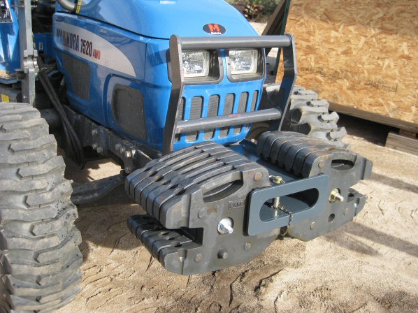

I can hardly believe that they do not have front weights any more. The tractor works awesome with them and the FEL is off. I would think that they would be a big seller over in India where FELs are not that common. Please let us know if this is true or not. In fact I may call Dave and check on this myself.
Here's some pictures of mine, but I modified it a little. :rolleyes: :laughing:

The salesman did say I can get it all from an outfit in S.C. The photo of 8 weights in my ops manual is way different than yours pictured. Yours has a lot more than 8 weights. The salesman said (if I heard him right) I could buy 96 pound weights for around $96 each with a $3.95 bolt kit for each weight and it could carry 9 weights. But I get free shipping for $900 in weights. I will just keep the loader on for that $$$. Once I trade up in trailers I will load the tires.

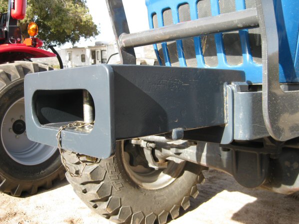

Brandi, I made the bracket that will hold 16 Mahindra weights sideways. I got the original 8 front weights with the tractor. Back then the front bumper and rear wheel weights came with the tractor at no additional cost. Now I had to scream and yell to get them, but I did indeed get a complete set of tractor weights for no additional charge. I should have yelled about the locking gas cap and the horn too. Back then all that stuff was supposed to be included with the purchase of the tractor. I actually think that the only OEM tractor option there was when the 7520's first came out was the 3rd rear remote. seems like the next year is when they started making the accessories optional items.
Anyway, I figured that the 8 front weights worked so good that it would be even better with 16. :thumbsup: I was able to purchase a second set of weights in the crate from Dave at Dave's tractor. Messed up when I made the bracket though and it is really tough to get 8 weights on each side, so to keep it simple I just use 7. :eek:
The price you got at a dollar a pound is not a bad price, cast iron is expensive. 900 pounds would be a lot of weight up front, I know that the Mahindra weights do not weigh that much. When you load your tires, you won't believe the difference that it makes.
