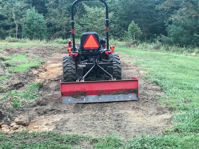

Month 3: Adjustments Done. Next project: FALL GARDEN.
Tractor was picked up last Tues and returned on Thurs as promised. No more "creep" and the parking brake seems to set fine now.
I've basically been fussing with the driveway for 3 months off and on, whenever the moisture level was right, trying different implements and techniques, making mistakes and fixing them. It was time to call it DONE! Here is one short section:

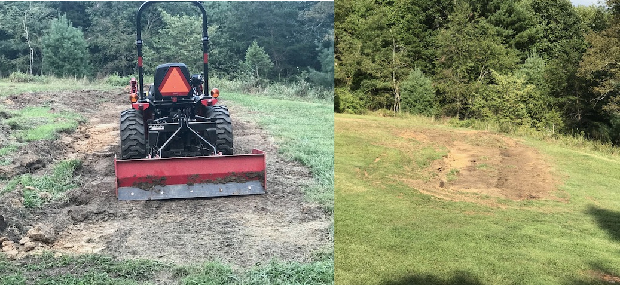

Month 3 con't: Work continues on the Battle of the Somme (aka my garden)
Made a little progress today consolidating the compost pile. Looks a little better. Before and during:
Once the garden is laid out I plan to slap on the scarifiers, set them all the way down, and hopefully break up the hardpan. Particularly in the carrot bed, as they never grow well here. They hit the hardpan and get discouraged I guess. It's nice to see even digging down deep, how good and black the soil is after 5 years of gardening/composting. And full of fat earthworms. Quite a contrast with the rest of the red concrete they call soil around here. :)
Also filled in a couple of bad dips in the sloped yard above the garden. These are a couple feet deep and rather unpleasant to negotiate with the riding mowers. Dropping a wheel into one on the tractor with a FEL full of dirt is not something I want to do. So scooped about 8 loads of my handy fill dirt and got it filled in. (Would have taken me a week by hand.)

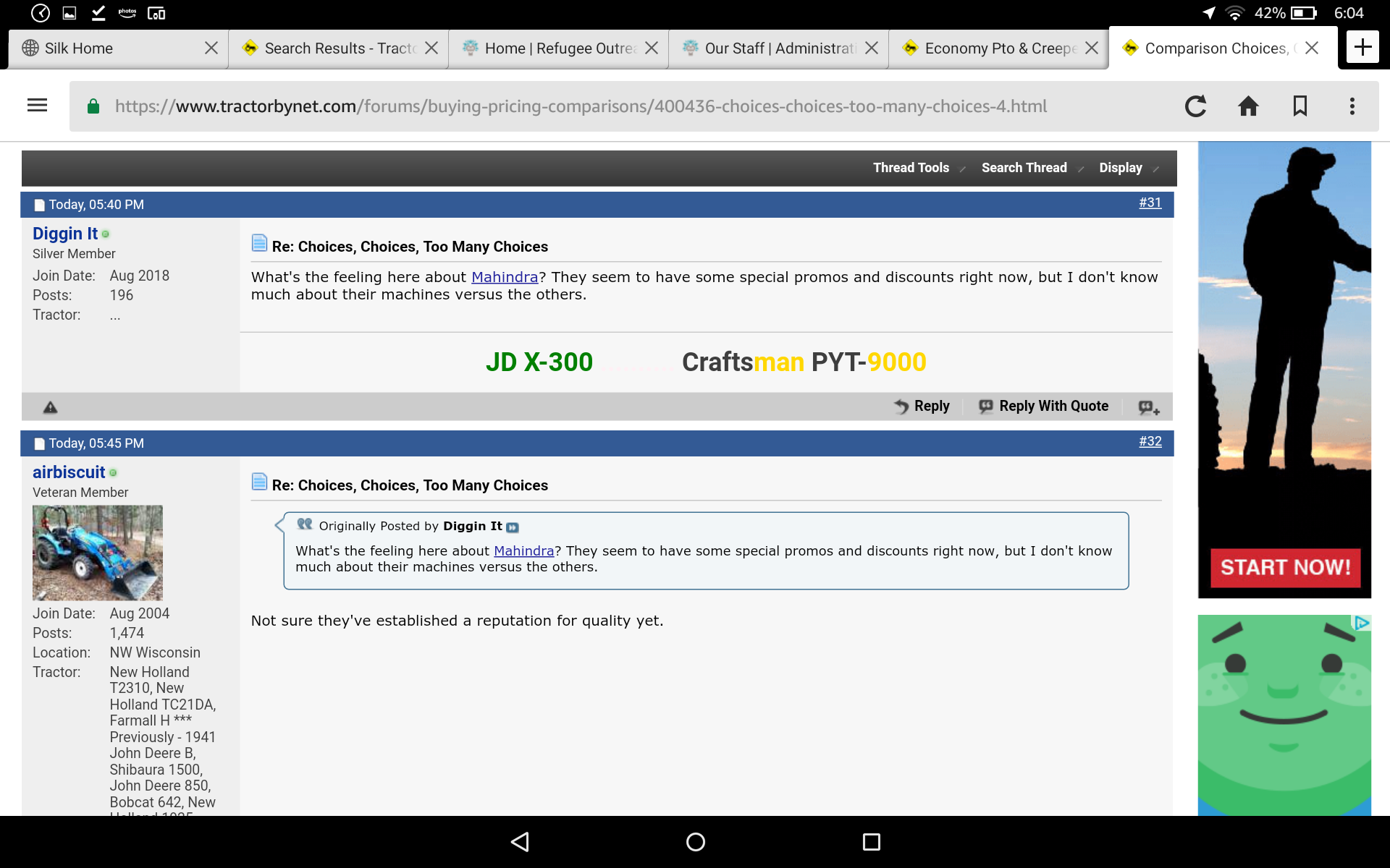

Guess I can't really express my thoughts about the message in the post, screenshot, below w\o receiving a message from Mohammad
The thread containing the message appears at top of screenshot.
