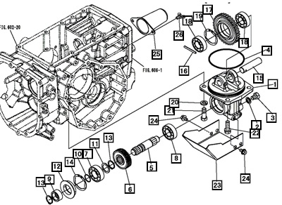

If it was the rear PTO that's probably what I'd do. It's pretty straight forward. This is the mid PTO which hangs down below the transmission. Access kind of stinks. So I assume I need to drain the fluid. The seal is like the rear PTO so that seems like a pretty typical replacement. From the diagram, it looks like there's also an O ring that seals the ID of the bushing to the shaft. Probably need to pull the c clip and bushing out to get to the o ring if that's what it's for. Just makes things a little more complicated the further you tear into things.
   / Mahindra Power train warranty #14
Well, you could try the "vacuum cleaner on the transmission oil filler" trick to keep leakage down. If the seal is fully visible, sometimes you can poke a hole in it with a sharp punch and screw in a sheet metal screw to get purchase upon. Then remove the bushing and the o-ring, and replace the parts (using the big socket on the seal, unless you have a driver kit.)

Ahh yeah id drain it then mid ptos suck to work on... enough for me to get a finish mower

I think a PTO shaft seal is going to be considered an "external seal", excluded from the powertrain warranty. Any seal exposed to the environment is usually not covered in any warranty on any equipment I've ever owned.
   / Mahindra Power train warranty #17
The gasket would be inside of the housing so I would think it is covered.
   / Mahindra Power train warranty #19
A case gasket, yes. A shaft seal, no.
The wording is kind of "hinky". I think that there's a good case for coverage. However, as noted earlier, transporting a tractor to replace five bucks worth of seal isn't worth the trouble.

Have a good dealer. On warranty work only pay 50% of transport costs. Seal and oring costs about 30 bucks my costs on transport would be about 32 bucks. Still waiting to hear from Mahindra on their decision and I agree the language is not clear. If I have to do it myself oh well I'll chalk it up to another issue with Mahindras customer service. Im getting near my 200 hr mark to change hyd fluid so I'll do it when I drain the oil
