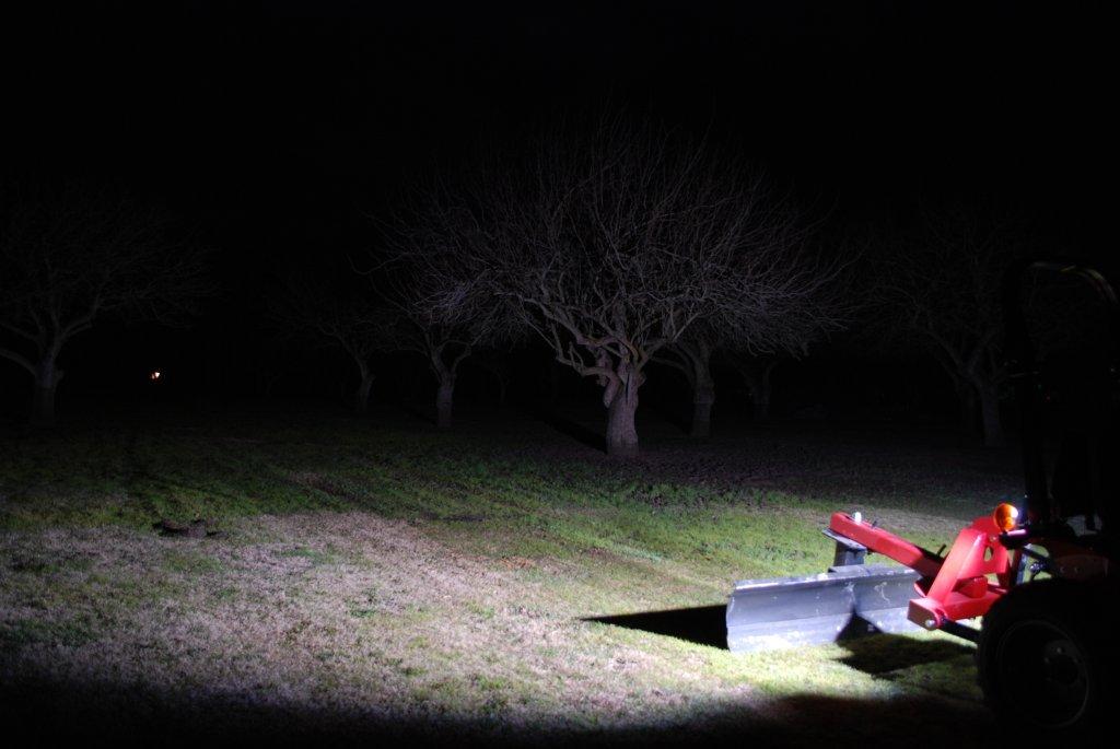

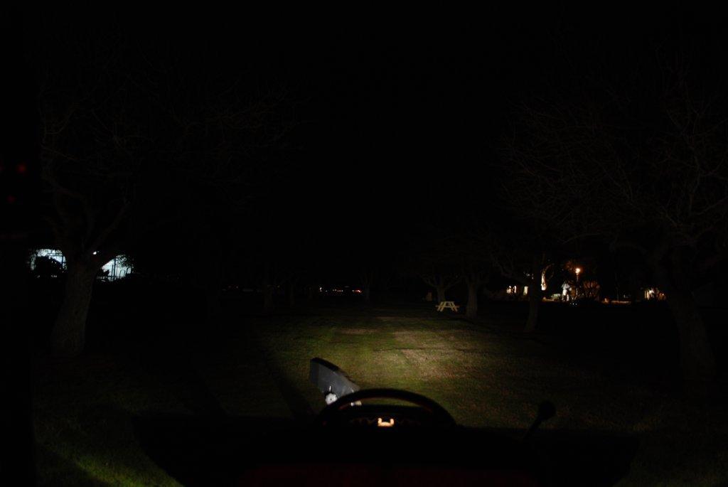

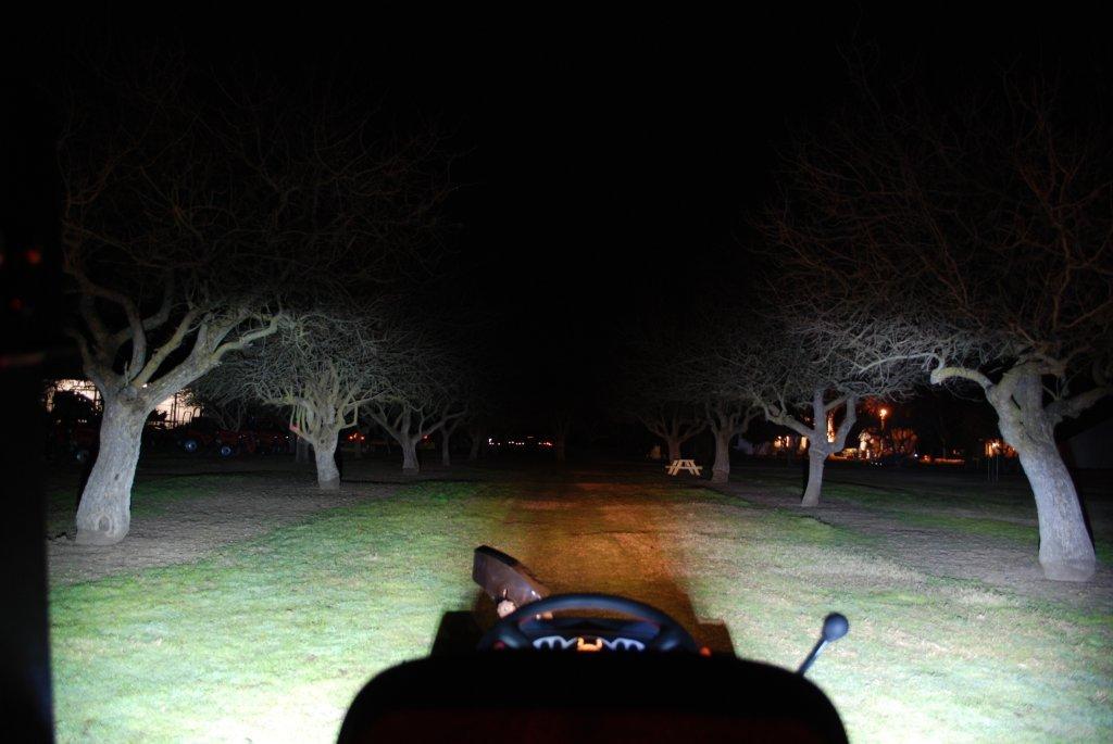

Go with LEDs if you want some serious light. The first picture is the normal front lights. The second is a pair of Rigid Dually Floods. The part in front of the hood is a snow blower that you can just see the top of. For the rear, one Rigid diffused covers a very wide area. The problem with LED lights is that once you start, they end up on all of your stuff. I have one on my Exmark for mowing, a pair on our golf cart, several pairs on the Jeep....I'm light rich and dollar poor!
View attachment 328356View attachment 328357
oof those are nice Dave. That rear light if I got it would put the front lights to shame. Is there a plug and play situation for the rear light or does it have to be wired in with tape and shrink tube and solder etc ? I figure there must be a wire or two going back on the 3016 tractor. I also like that rear scraper blade. I think the 6' one I have now may be too narrow when angled with the ags kicked all the way out. Of course that's saying that the 3016 could even handle a 7' rear scraper blade with 17" mod board. (I like the higher mold board for snow as it piles over the 13" I currently possess)
/ Mahindra rear work light #7
Good question on the wiring. We always go to the battery and run a fresh wire with fuse and switch, or on the higher amps lights with a fuse, switch and relay. We should do some research and figure out if there is an existing wire that would work with a switched light. In the past we have had issues with tapping into an existing wire, so we sort of made a rule that all new lighting gets its own circuit. If you order a Rigid light from anyone, it has long wires, a fuse and a switch, so it is a matter of routing the wire and generally you do not have to do any splicing. If so, we solder and shrink tube as you mentioned.
