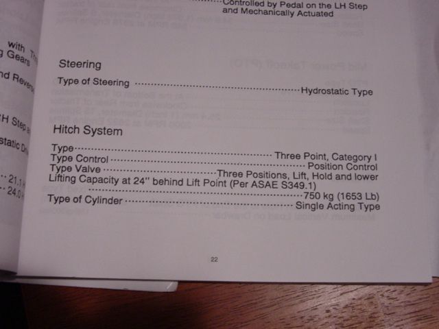

O.K. heres what I have found, I am replying to your post Bob because you seem to have put the most time and research in.
I have a Mahindra 2615 4WD HST......
This attachment is straight out of my Mahindra operators manual. That 1653 Lbs @ 24" behind lift point in the operators manual is the same number listed in the brochure for the 2615 4WD but not the 2615 4WD HST which lists 2205 Lbs.
The interesting thing about the Mahindra material is the none of the printed or online marketing literature says anything about where that lift capacity originates. It only states in the operators manual "Lifting capacity 24" behind Lift Point" The brochures just say "Lift capacity" and give the number.
I think that answers at least one of the questions (do they list that info somewhere?) but opens up a new can O worms. So does that mean that the number in this manual is only for the HST which would mean that the brochures are overstating the lift capacity by about 25% or is the brochure a missprint and both versions of the 2615 should be at 1653?Another thing is that the 3015 HST (next column in the brochure) lists its lift capacity at 2205 Lbs also and that is the next model up. The operators manual cover says "operators Manual 2615 & 3015" no distinction between HST and gear.
Just thought I would throw this in and muddy the water a little /forums/images/graemlins/grin.gif

Larry what I've found is that often the owners manaul/operators manual has the detail. The marketing material has fluff. JD does some similar things with some of their numbers on their smaller tractors too. I'm getting a bit confused as to where what was said because this same issue is being discussed in at least 3 threads over the past 3 days, but I know that Massey does the same thing with their 3pts too.
