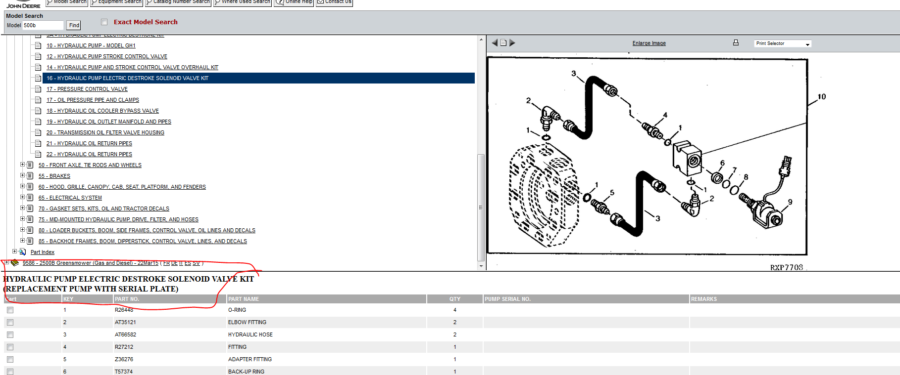

Not something we ever saw/used on a green unit but was an option on many of the yellow machines. Would have been kind of similar to 50/55 series mfwd solenoid.
   / main hydraulic pump leakage.... EVEN AFTER REBUILD! #32

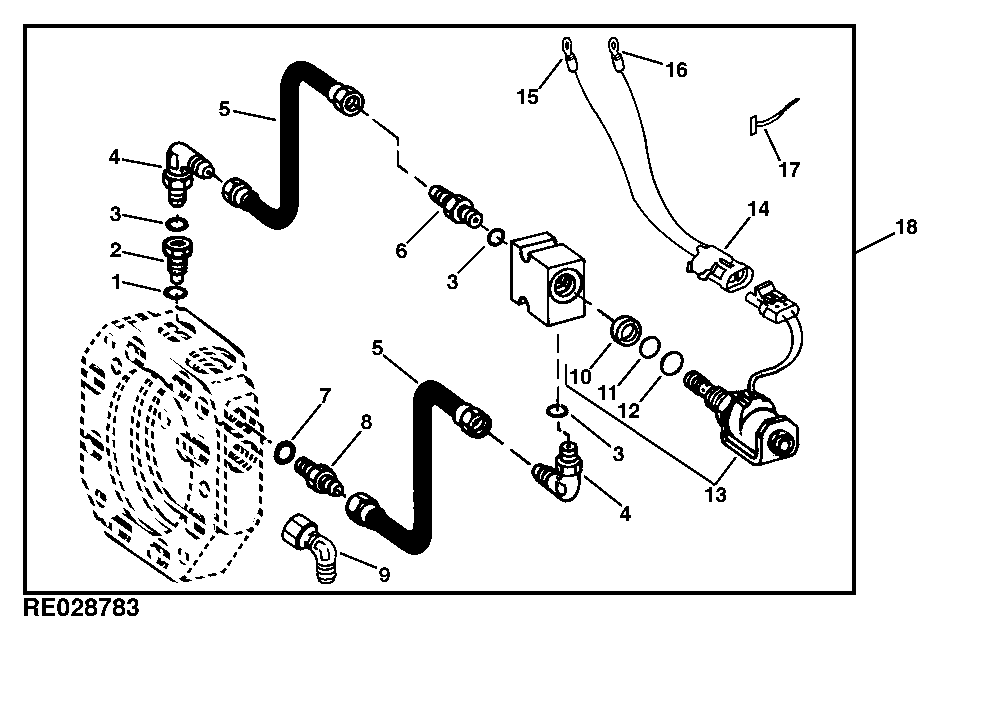

re40463.gif search re40463, it would be correct for the 500b, 4440, 4010 lots of applications could use it.
   / main hydraulic pump leakage.... EVEN AFTER REBUILD! #33
Photo you posted is an electronic destroking device to be utilized as a starting aid BUT isn't what JD or I would call a stroke control valve that can be utilized to adjust stand-by pressure.
