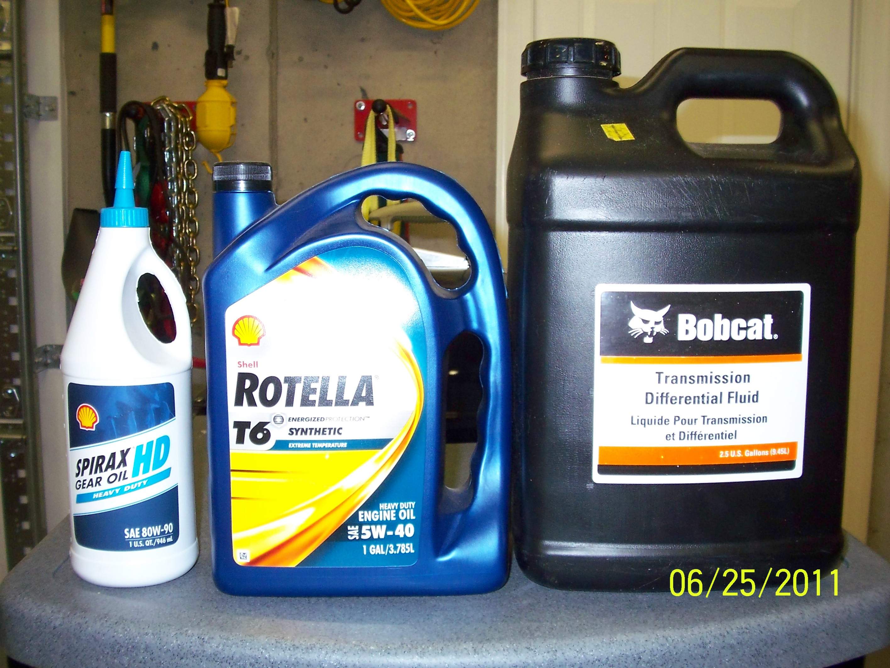

These are the fluids that I used on the 50 hr service. I'm gonna stick with the Bobcat trans/diff. fluid even though it cost more. I'm already stocked on filters and fluids for the next service.
