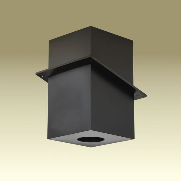

You know, I didn't think we could do an internal chimney, either, but all it took was a 16" square of floor space. So I put it in the basement, up through the floor joists of the 1st floor, up through the ceiling joists and out the roof. Piece of cakes. We used some metal boxes made by the chimney pipe manufacturer similar to this:
duraplus-all-fuel-square-cathedral-ceiling-support-box-for-chimney-pipes-with-a-6-inch-inner-dia.jpg
Only it was for flat surface instead of for cathedral. Anyhow, it fits between the joists and also provides the proper spacing for framing, so you just build some two-by- framing up against all 4 sides and frame it in, they drywall over the frame. It provides the proper fire-rating distance from the drywall automatically. Pretty much fool-proof. One of these boxes in the floor and one in the ceiling, framed it in. Works great.
Anyhow, just something to keep in mind for the future should you decided to go with an interior chimney. ;)
