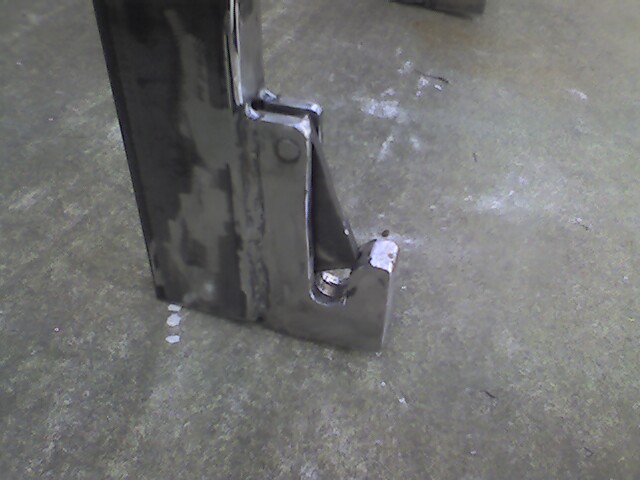

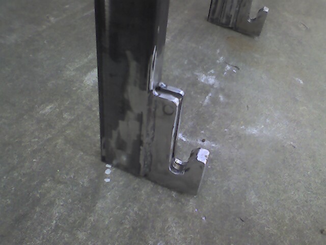

I have been fascinated by the quick hitches that guys have sworn by or at here on the forum--the Harbor Freight example in its 2 versions of different widths is a favorite or a curse--depending on who you talk to.
I now have several tools that I have made and have had occasion that I wanted to swap back and forth, but the hassle has stopped me. For example I might haul a few loads of dirt with the scoop, and then want to level it out with the blade or the rollover BB.
Although I have not seen one of the QH up close, I have pictures from you all, and I have given it some thought to build one for myself, for my 15 hp Yanmar, but had not taken the time to do it. Until now--it is not finished, but I had a few hours so got started on it. I made the "J" hooks out of 3 pieces of 10mm flat stock. I used a hole saw to cut the 7/8 hole and an angle grinder to cut the slot. Then I welded the 3 pieces together. The latching mechanism will use only the weight of the metal to close the latch. The center piece was left out on the back of the "J" to allow a place for the latch.
Now if the QH does not fit I will not be able to blame manufactures of the implements or the hitch--it will be my fault. :eek: I am going to have to modify the BB toplink connection so that I can use the QH, but the other implements should work.:confused: We will see how well I conformed to standards when I made my implements!!
Mike

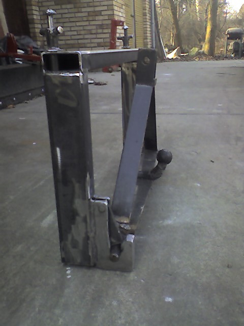

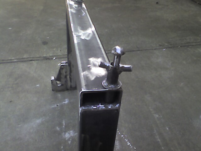

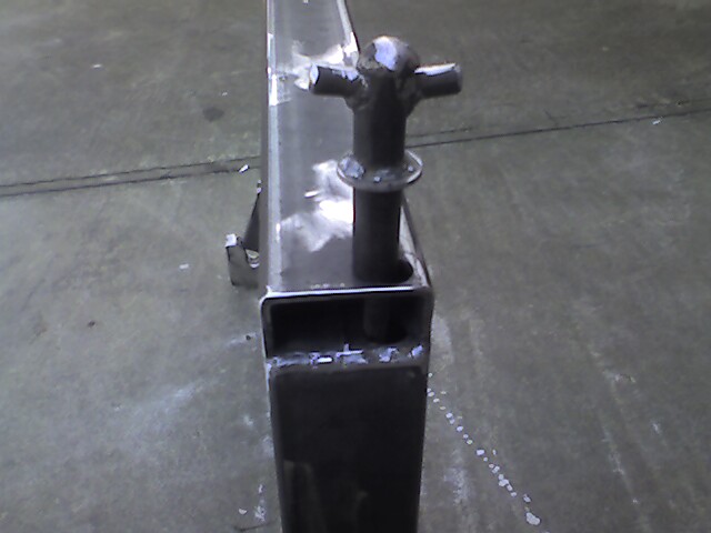

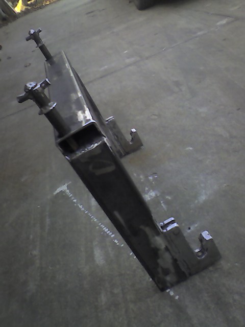

After getting the "J" hooks like I wanted them I had to figure out a latch mechanism. I think that what I did will work well--time will tell.:D I attached an arm on the latch which extends inside the frame. To that arm I attached a rod that extends out the top of the frame and I capped it with a knob that I can push down on to force the latch into lock position.
The latch can be held in the open position by the little pieces of pipe that will just clear the top of the frame when the latch is fully open. It is simple and it should work--I think.
I tried it out with my simple 3 pt ball hitch for a utility trailer and it seemed to work well, so far.
Now I have to make a top hook and fabricate the tractor side. Maybe later in the week I will get to finish it.
Mike

Very nice work. Nice and clean. I like your latch assembly. Hopefully it'll still work after it gets some dirt in it.
