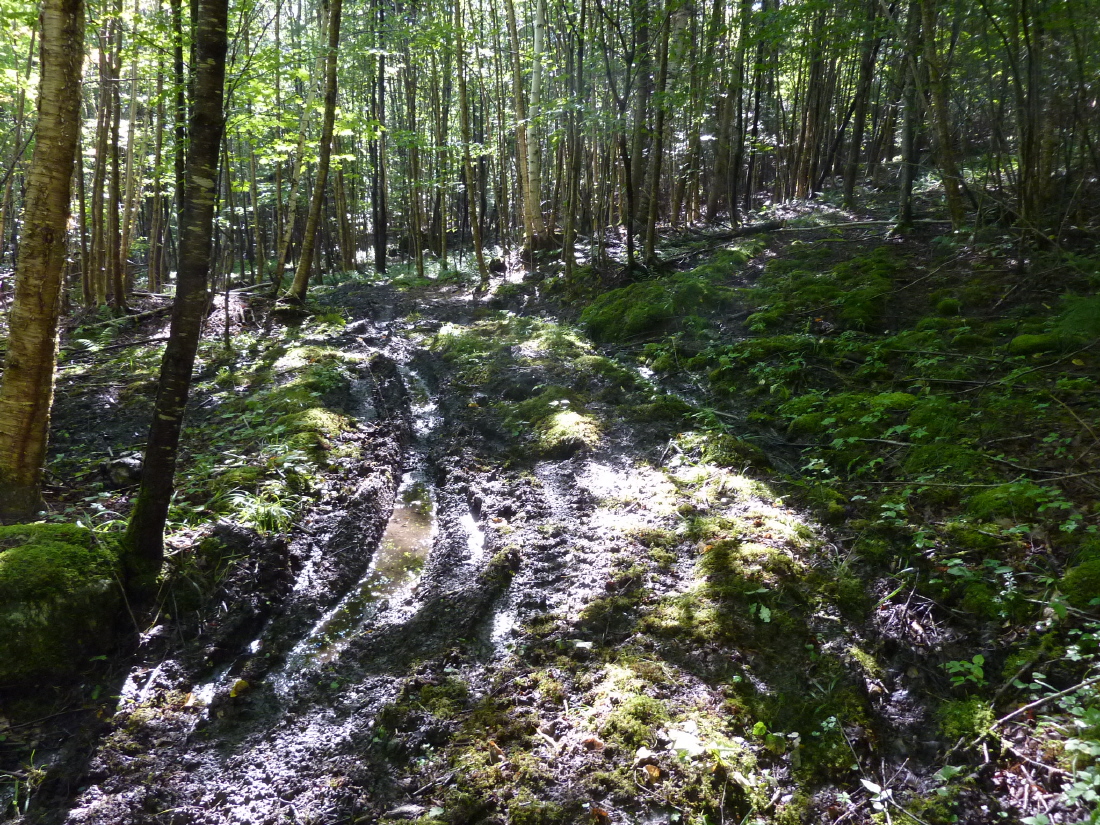

Past years I have worked on sandy and gravel soils. No sinking no mud. Not the case now. It is a loam type soil and I sink evan when fairly dry. Some clay and lots of soft spots. I am falling smaller trees making a corduroy road. Using branches to travel on. I better get skid plate for my l4740. Anybody ever use geomaterial? Suppose to keep everything afloat and keep soil stable?

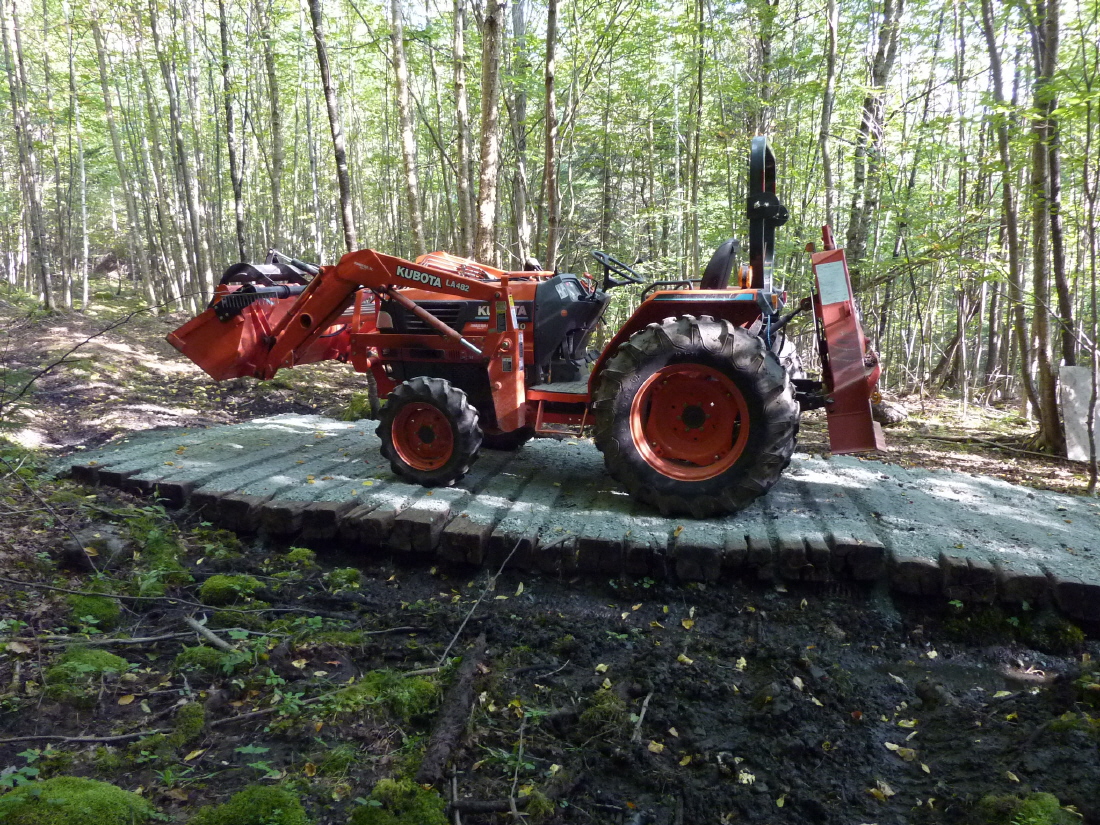

When I need a temporary road I just do what you are doing. If I want something more perminent I have used old RR ties which are often available free. They sell the best ones but there are plenty that are good enough for the taking away.

There is a rail yard close to where we are that has mountains and mountains of old ties that they have replaced. The good ones they sell to dealers for landscape timbers the not so good one just pile up. It is pretty rural here. The yard forman said he wasn't really supposed to allow me to take them but on the other hand it cost him (the RR) money to get rid of them. ( Probably why they let them pile up) So if I could use them go ahead and take them. They are heavy. You need more than a p/u truck if you want more than a few. I used about 50 in this seep hole that never freezes. I put some gravel in the spaces to keep them from rolling. My neighbor has a section of road built with ties that has been there 40 years and it is still solid.
