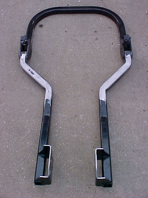

Let me reiterate........I don't think they make a heavier tubing than this, as I've already said, it appears to be well made from very heavy wall, high strength steel tubing, mandrel bent, gussetted and reinforced - already. All I'm doing is drilling a few holes and making a couple of small bends to make things line up. Then I'll reinforce as needed to make sure it's sturdy. I'm mounting it the same way Yanmar does, using their mounting points and bolts. Now how would a welding shop do this any better? I have the same TIG welder they do, I'm using the same tubing (or better!) that they would and so on. You're saying that at least someone could sue someone else if it failed?

Here's what it looks like now, if you refer back to the pic in my first post you can see that I just increased the angle of the bends to bring the attachment points inboard to match up to the width of the Yanmar's case. I've also made some additional brackets that will attach to the rear of the Yanmar's case and provide additional support, but I'm doubting whether I need them at this point. I still need to straighten out one more spot that causes the ROPS to tilt too far forward, where it interefers with the seat placement, I'm plannnning on doing that over the next couple of days, then give it a good coat of paint and mount her up.........
