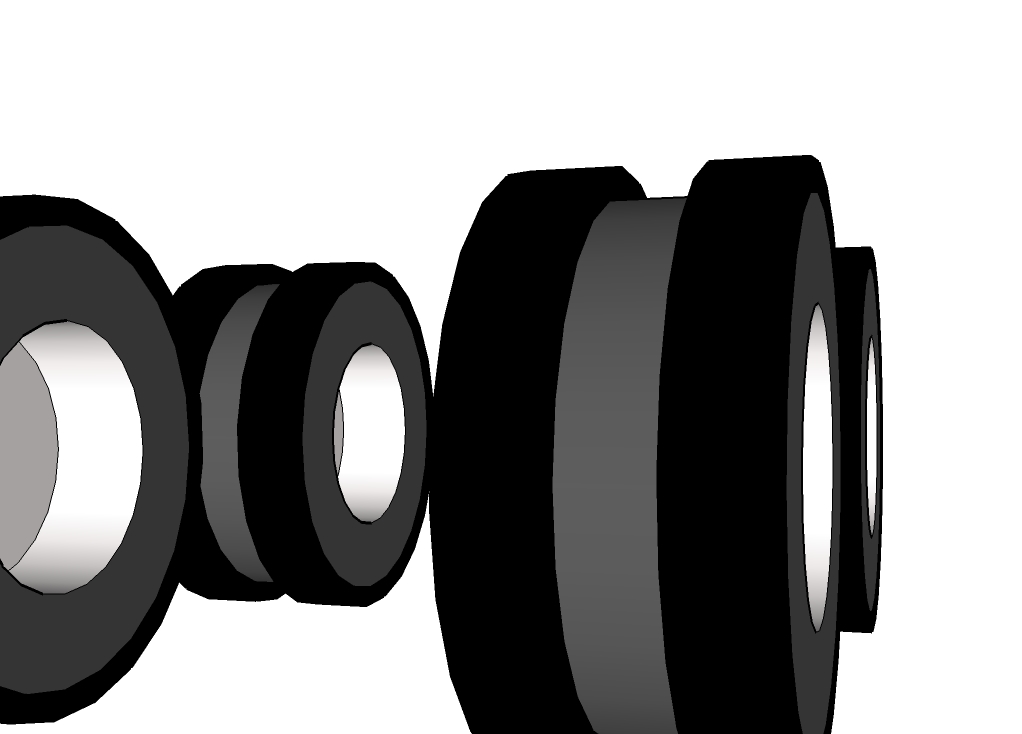

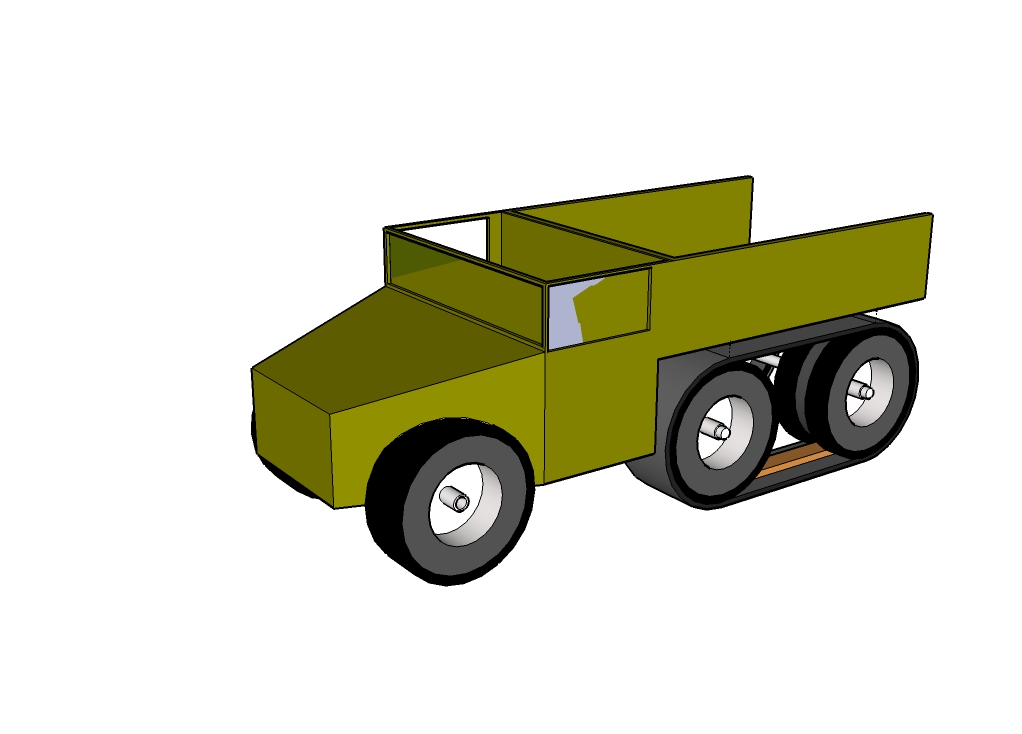

Dear Sir
I viewed the photo of the track and wheel profile. I believe there are going to be greater forces at work on the tires than you hope for and the rubber tire assembly will fail. I built a scale model of a Case 450 under carriage in metal. When you look at army tanks they use 2 wheels to run the track profile that you are using through. These are mini digger tracks and slow speed and heavy. I have some tires that came from an airport ground equipment that are the size of camper trailer tires but solid rubber 4 bolt pattern. Somthing similiar could be matched front and back = 8 tires. Or cut the middle sprocket out and make skid steer types on thick tires.

How do you plan on steering this contraption if you do succeed in getting the tracks on? You have to have independent control over each side so that one side can be either stationary or in reverse while the other is going forward. Otherwise it goes only where it happens to be pointed and that's it.
What did the tracks come from? A little walk behind skid steer? Maybe you should just look for one of those and skip the science project.

Finding a little walk behind skid steer is much easier said than done. I've had my eyes out for a junk mini excavator or any kind of small tracked vehicle. There just aren't any that I've found unless I wanted to just buy a working one. For that money I'd just get my kids an electric power wheels car and spend our bonding time building plastic models in a cute little cookie cutter house in the suburbs. That's not my style, though.
I understand the concern about the tracks needing to move at different speeds. That's the point in using the lawn mower axles. These axles have a differential built in.
It's a halftrack, so there will be wheels in the front that steer the vehicle. The tracks will provide the power. With the differential, one side can even be stationary while the other side powers the vehicle through the turn.
I've attached some images from a Google Sketchup sketch that I did to get some ideas regarding size and scale. There's an image of the vehicle as planned, and there's a closeup of the tires as currently planned.

if you're still undecided...
Regular epoxy would fracture and break up...you might check into "poly" epoxy...
What first came to mind when I read the original post was silicone but that application would take several days to cure....
Another option may be a fibered casting resin (polymer)

A few days is not a problem. We're only working on this project one day a week, and we figure about a year to complete it. Is there a cheap source of silicone besides tubes of caulk?
