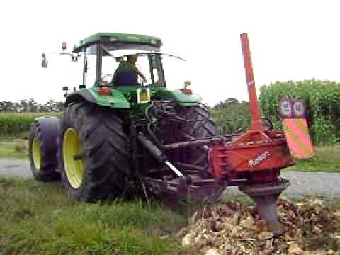

This seems to be a splendid invention, is it already available in US?
Phil
[ame=http://www.youtube.com/watch?v=QVAJT2ThP-4&feature=related]John Deere 8100 and Rotor S stump grinder - YouTube[/ame]
