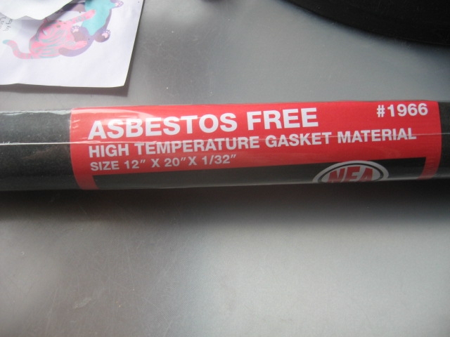

Yes the #3 product would be fine. Without physically looking at that unit I suspect changing thickness a couple thousands of an inch would not matter a 0.03 thick gasket would affect the pre-load on the rotating group(s) and may cause excessive leakage.
I found 1/64" gasket material which is a 0.006" difference. If you figure the original compressed a bit over 60 years that puts me close enough. I am picking it up today. Apply a little permatex Form-A-Gasket No. 3 and I should be good to go. Crossing my fingers. Thanks for the advise, I will post up the results in a month or so after it has had the test of time.

I am sure it would be fine, but I have also heard horror stories about RTV on pumps / motors / hydrostats which is why I thought I would focus on using the Aviation form-a-gasket No.3. When you said stick with form-a-gasket, I assume you meant the Aviation form-a-gasket No.3 like I mentioned in my original post.
In my search for the part, I did come across a guy that focuses just on the the older cubs and he said that thickness does matter. I also suspect the group is right about finding the appropriate material that is made to handle the oil so I will go on a search tomorrow for the correct gasket material and thickness. Better safe than sorry, sometimes I just need somone to keep me on the right path.

I think that the thickness does matter - in some cases, the gasket thickness is included in the shims that determine the bearing preload. Of course that means the gasket thickness is only important if the preload is important. In old style manual transmissions with ball bearings the preload is not all that important. In front axle assemblies or even rear axles that that have tapered roller bearings it is.
In pumps for hydraulics, and for the hydrostatics transmissions the gasket thickness not only matters but is critical. Their gaskets are often thin metal sheet that are stacked in layers to make a specified thickness. Soft metal is used without a sealant. There the gasket thickness affects the clearance of the pump rotors and directly impacts the output pressure.

Update - Thanks for everyone's comments. I was able to find 1/64" paper gasket material and I was able to recreate a perfect replacement gasket using a retrace of the original, a new razor blade and cut/sharpened firearm casings and a hockey puck for punching out the holes. I cleaned all the surfaces perfectly, applied form-a gasket then attempted to assemble everything. Several internal components needed to be lined up before the two case end would come together.....but only after dumping all the internals on the bench, having to reassemble everything, and getting oil all over the surfaces I had diligently cleaned up. The struggle was real, lol, so I slapped it all together in an annoyed state of mind. I have a feeling I will be doing it again but the second time around I will have a better idea how it comes apart, I will know what to do and what not to do. Plus I will have everyone's product recommendations to guide me. I hope to have everything together by next weekend so I will test it out, let it sit for 30 days and report back the result.

I am attempting to fix all the oil leaks on my Cub Cadet 127 tractor. I have most of them fixed with the exception of a leaking gasket on my hydrostatic transmission case. I thought I could order the part based on various web searches, however, after making several calls nobody seems to have it any more (Part# 394865-r1 or 3102875) so that means I have to make one. My first attempt success rate in fixing oil leaks hasn't been great so I thought I would post my plan and let members tell me if they think it will work or if they have a better idea.
The original gasket measures 0.0095 thick. Although I haven't scoured the earth looking, the thin gasket material isn't easy to find, however, I have heard of others using file folder material. It measures 0.010, which when compressed makes it perfect. So my plan is to use this file folder material with a very thin coat of permatex Aviation Form-A-Gasket No.3 on both sides of the paper gasket. I am not using the file folder material to be cheap, I just think it should work.....but again I don't have any real world experience in this and I would love to hear the opinion of others that have more experience than me. This is a huge PITA to take apart so I want to do it right the first time.
