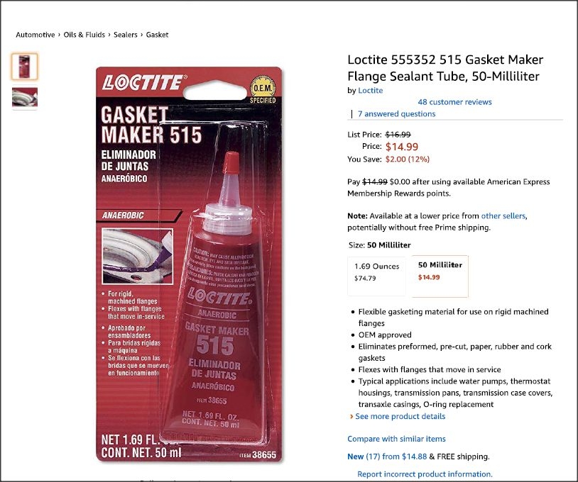

I disassembled my high-hour Kubota F3060 range gear transmission, differential & HST couple of years ago due to couple of leaks and used Locktite 515 Anaerobic Gasket Maker for the HST, together with a paper gasket.
I used Three Bond for the other surfaces since that is what Kubota recommends, but I am sure there is a Locktite / Permatex product that will work just as well.
(Kubota recommends Three Bond for-sure, both being Japanese products!)
Zero leaks so far.
   / Making replacement hydrostatic transmission case gasket to stop oil leak (Cub Cadet 127).... I really don't want to screw this up. #24
that is the best to use as it will cure without oxygen, when the 2 halves are put together it will still cure when air is blocked off, it's expensive though. I used it many times in the lower bedpan's of engines and overhead cam caps on the ends of cams. also between the 2 halves of the air cooled Beetle engines
