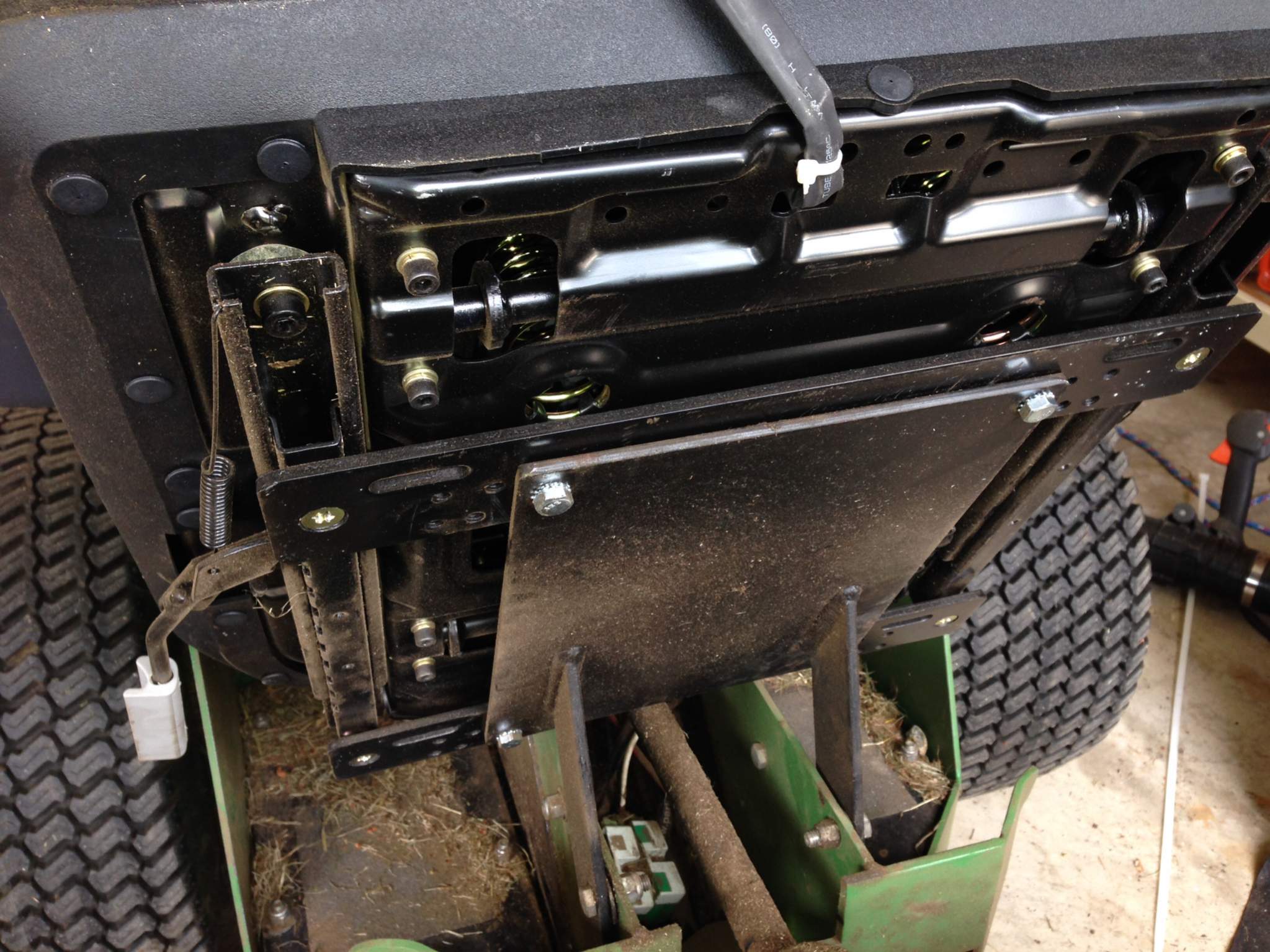

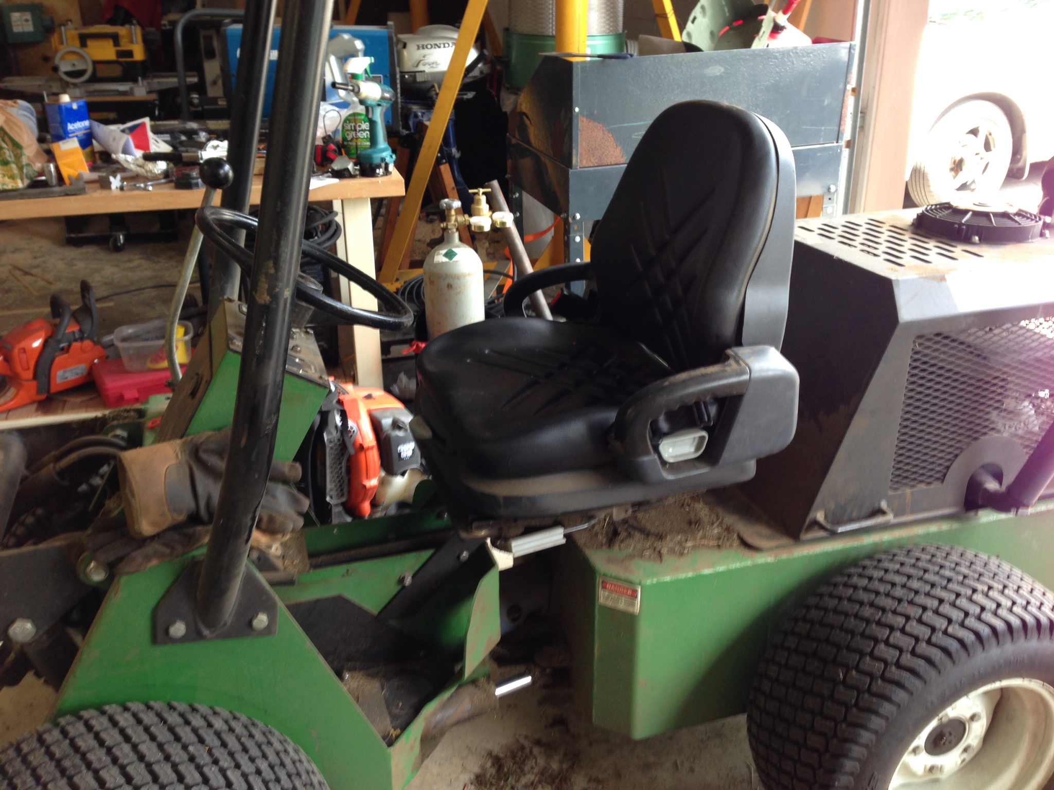

I bought a suspension seat and installed it.
Very straight forward. The seat itself has drilled/tapped holes that lined up with the mounting plate that PT uses.

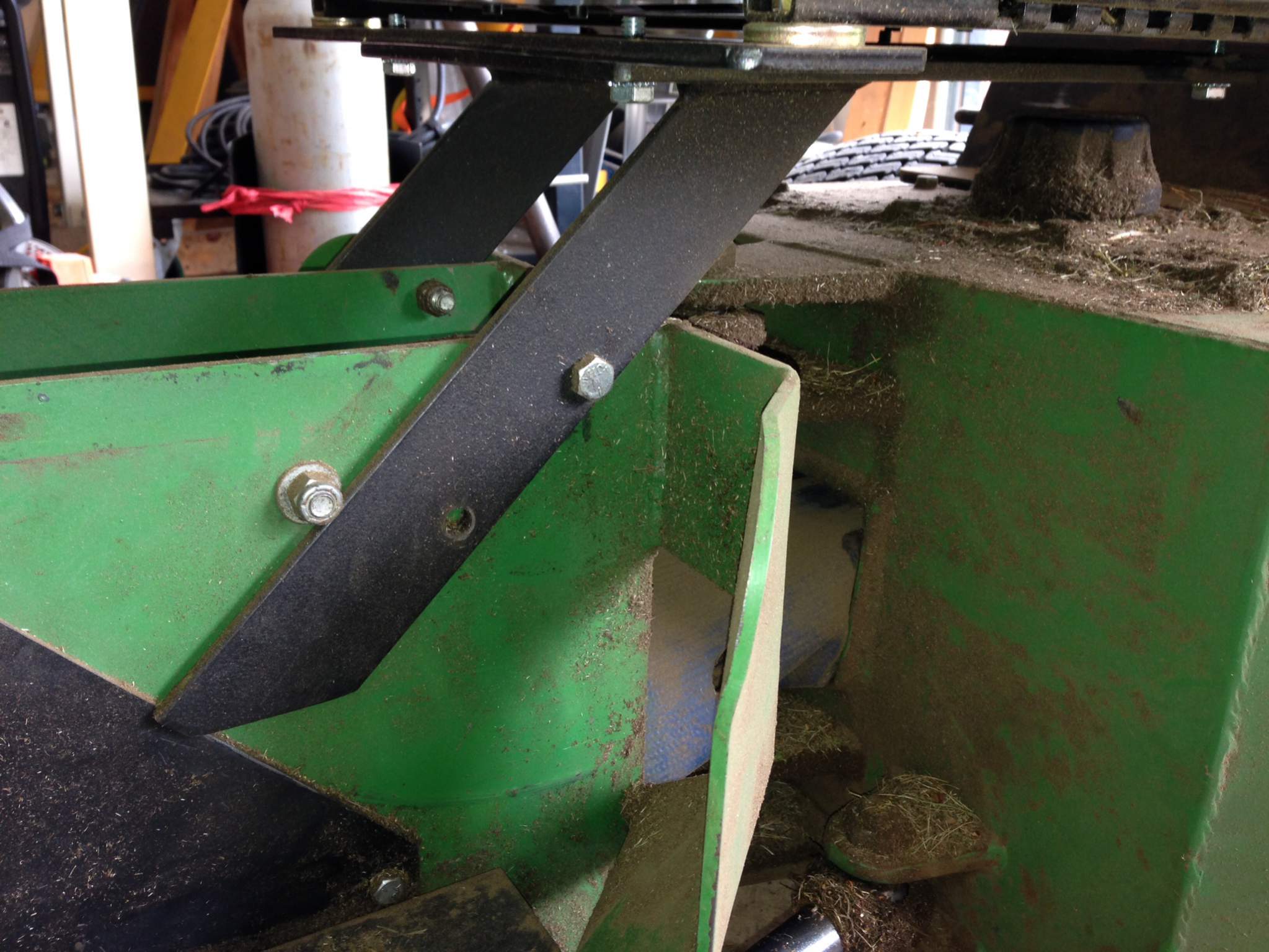

Since the seat adds about 3" height, I drilled new holes in the mounting bracket for the pivot bolts about 3" away from the old one (you can see the old hole on teh bracket below).
This allow the seat bracket to clear the hydraulic tank filler cap by about an inch, and it didn't make impact from articulation during my last mowing session. This solution wouldn't work for everyone... I am 5'10" and I now have maybe 1" under the ROPS, but didn't bump my head on it once in an hour of rough mowing.
Happy with the results. The seat suspension has about 2" of travel, and has a scissor frame with horizontal springs. Very effective, I was able to drive much faster without the corresponding pain from wheels falling in the random gopher holes in my pasture. I bottomed the seat out a few times, but the jolt wasn't painful as it would have been with the PT seat.

Very nice looking seat installation! Only 1" head clearance - I would be a goner on my trails.
   / Making the PT Seat more comfortable #17
time will tell, haven't hit my head yet. The seat actually has a height adjustment (probably an inch of travel). I can get another 1/2"-3/4" if I take the seat rails off, but that would require me to weld up a custom mounting bracket.
I was pleasantly surprised that the existing bracket bolted on effortlessly to the seat; I has thought I would be doing some welding this weekend to make it all fit.
The original seat only gave me maybe 2" of headroom.
