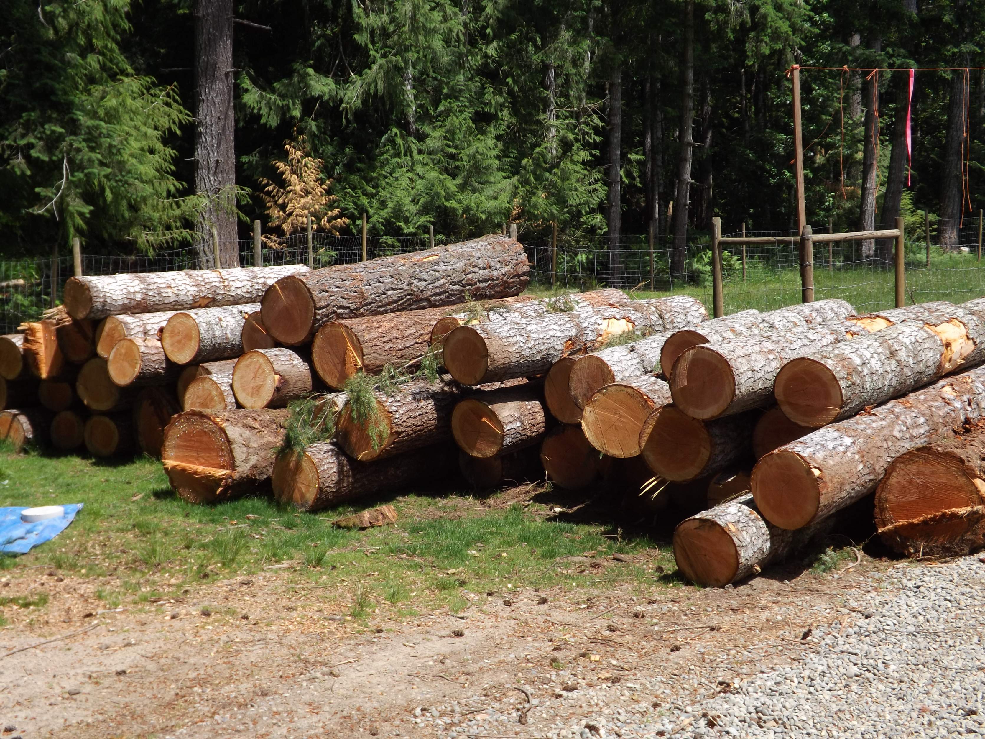

Thanks for the reminder. I try and be carefully when I pull out my logs with chains. Usually I have been able to get right up to the log which keeps the chain very short. :)
