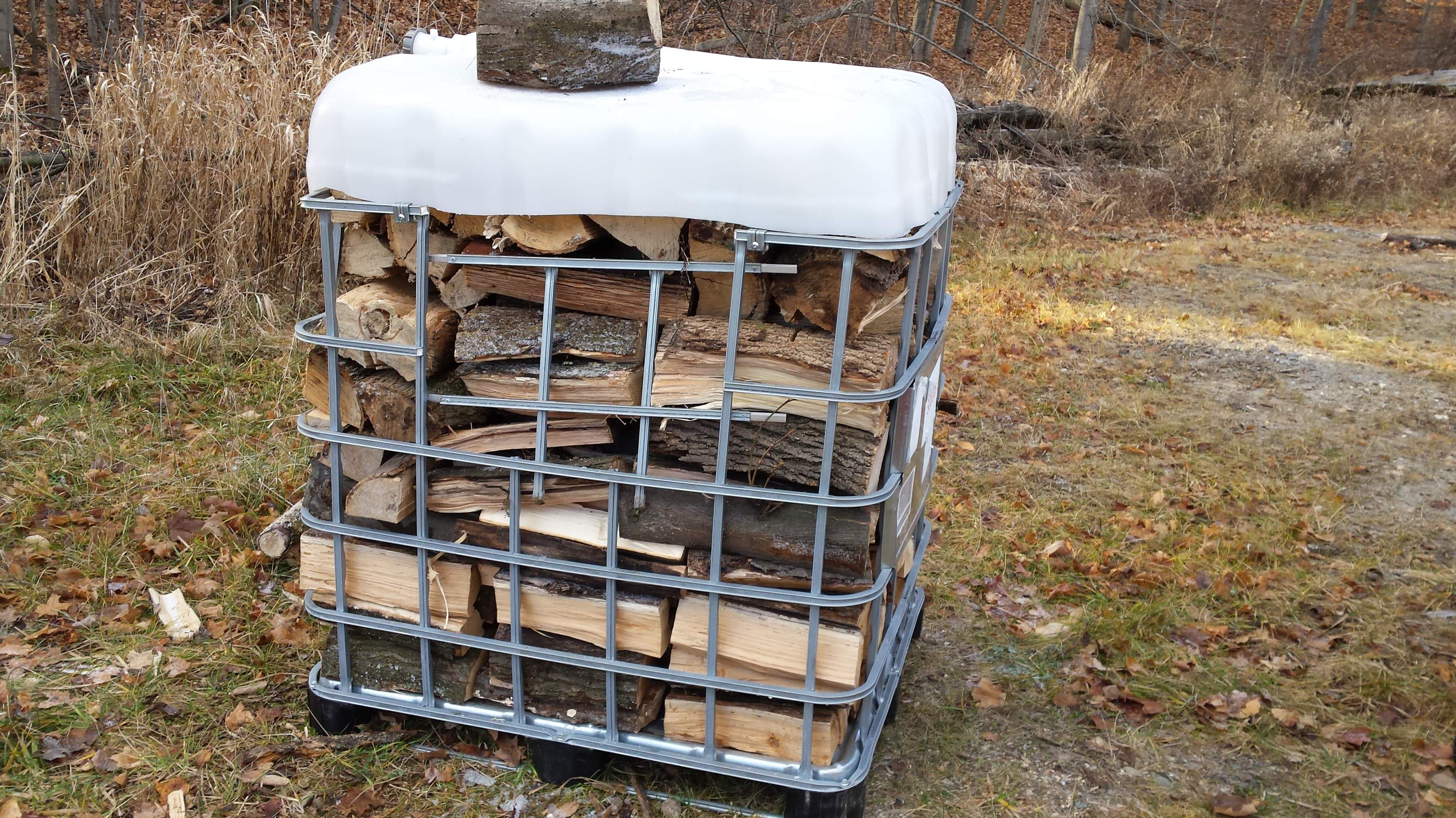

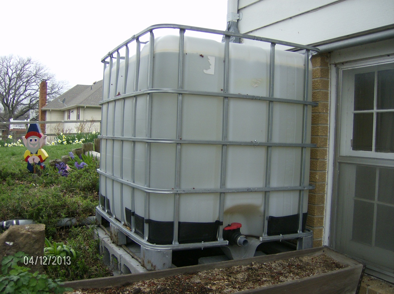

Find one of the plastic totes, the kind with the metal cage around the tank, & cut the top out!

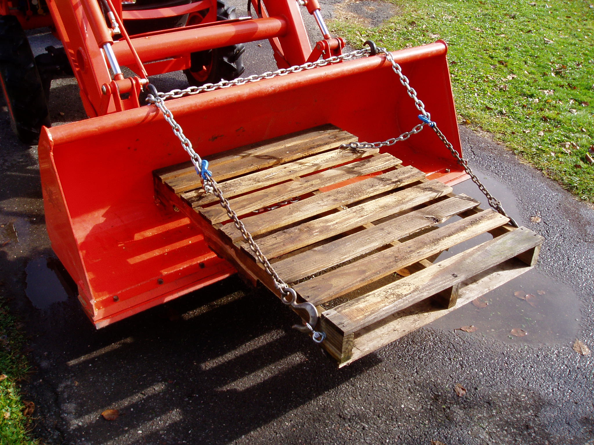

Safety police, please avert your eyes ...
I used this arrangement successfully for a quick pruning job:
   / Man Lift ideas
That's a little less stable than I want to go I think. I have solid pallet forks, and would love to find one of the totes Lowell has. If not I'll go with a reinforced set of pallets with some sort of rails. I still think they are safer than climbing up a ladder with a running chain saw.
