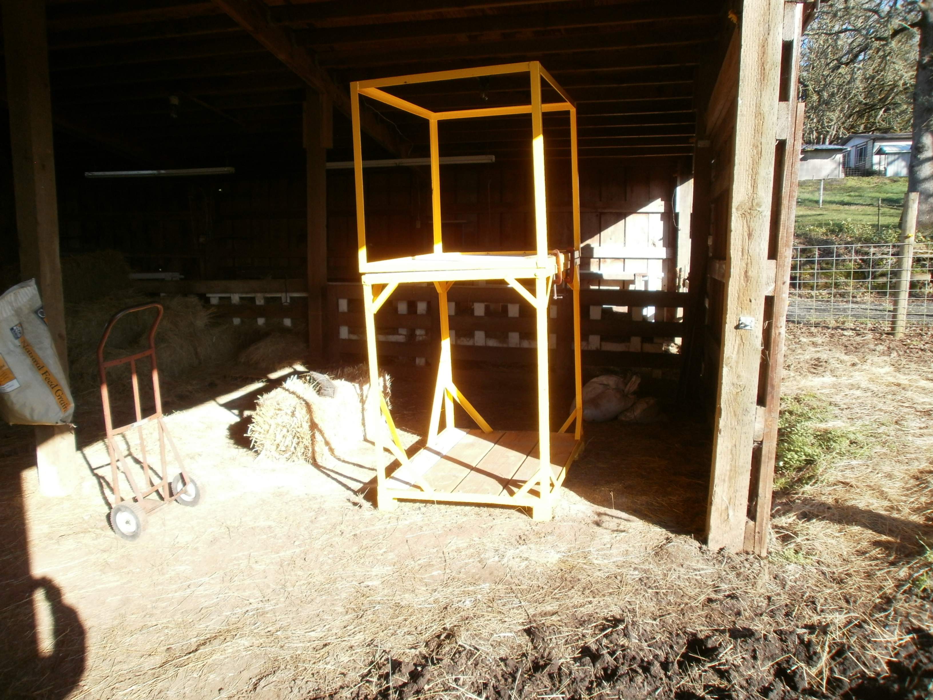

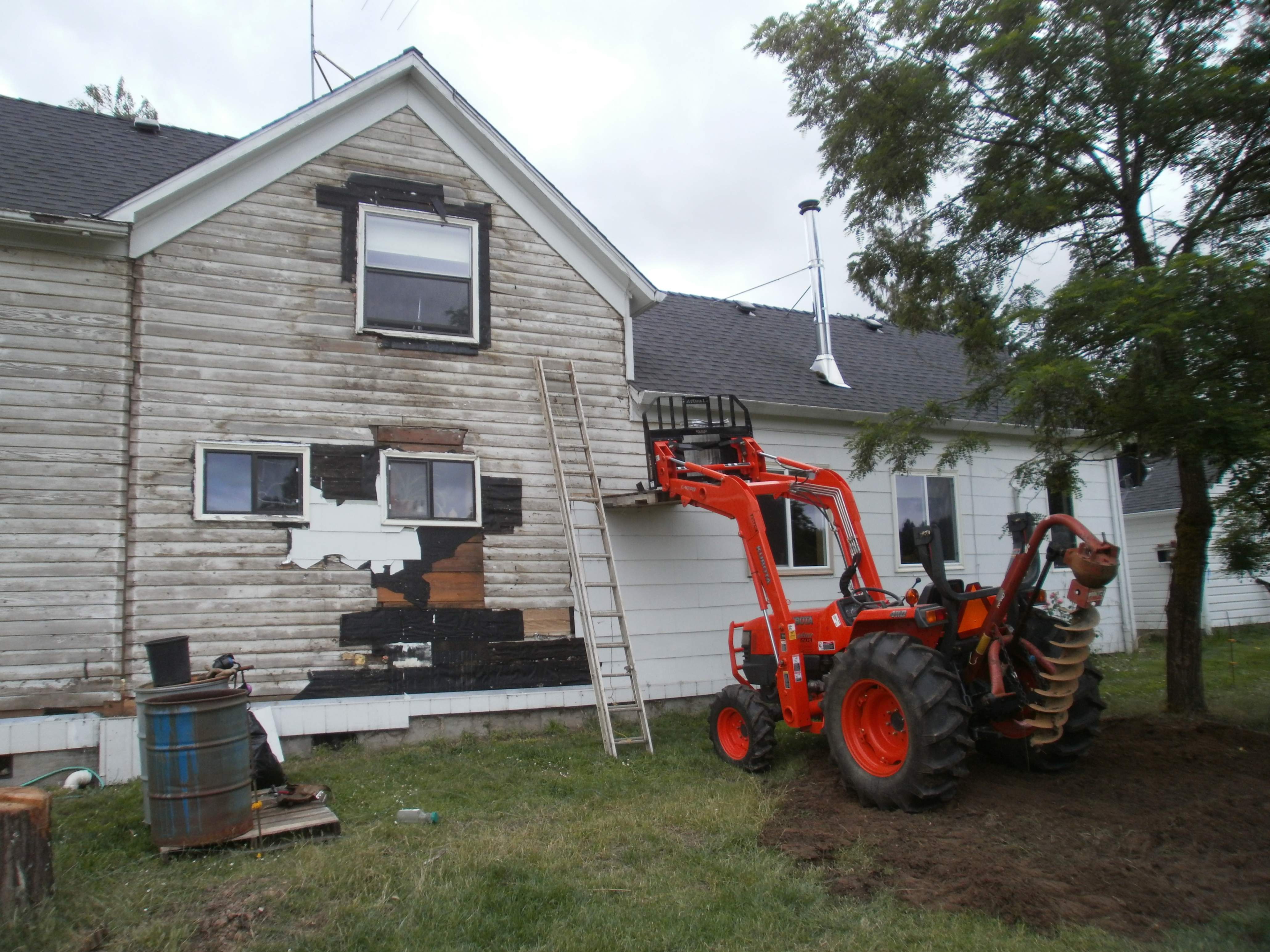

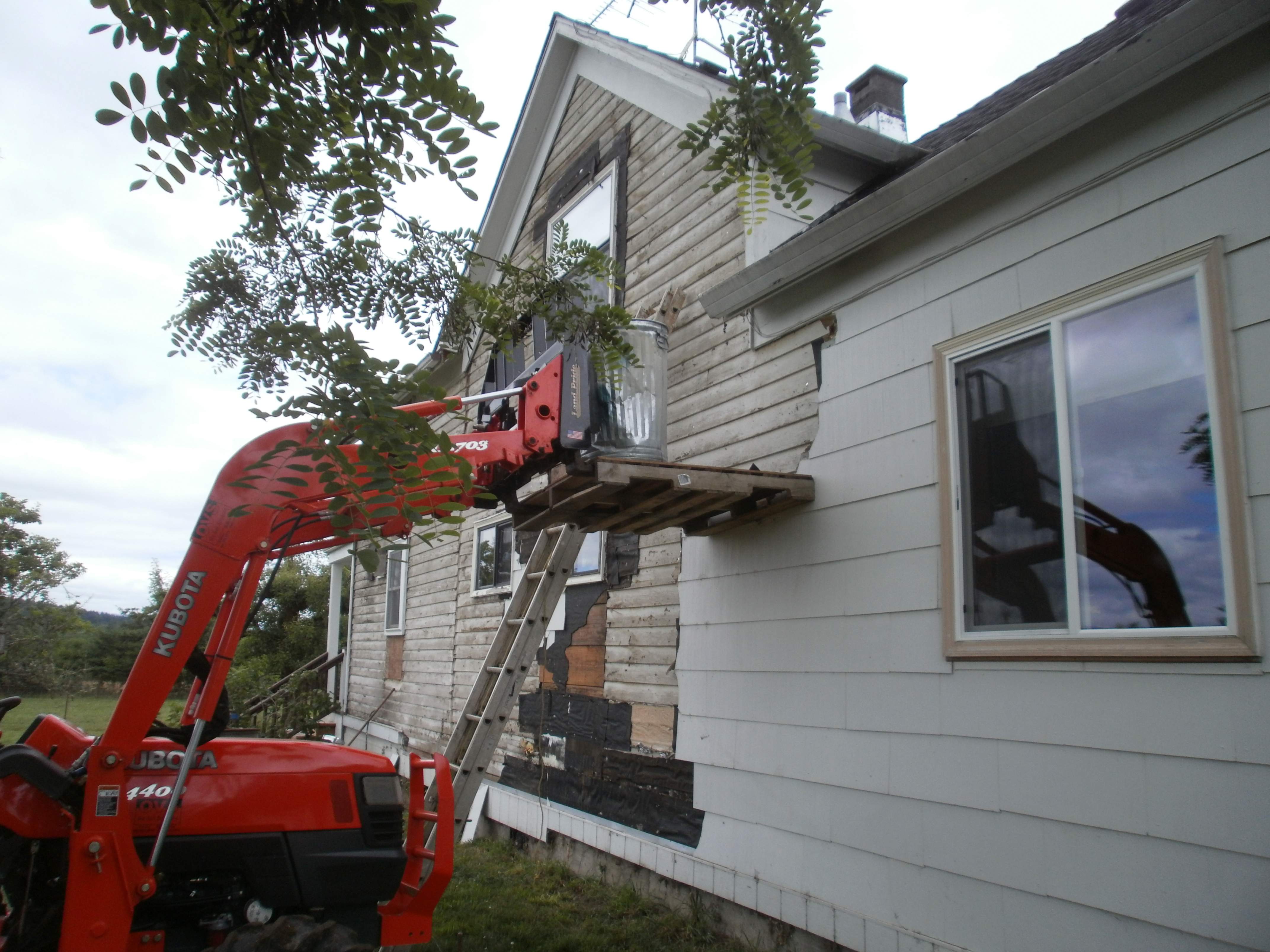

   / Man Lift ideas #20
My first attempt was taking a solid pallet, putting a plywood deck on it and some short side pieces. I had it secured to the forks
This was a couple years ago. Worked fine, but a little dicey
This winter I made a convertible single or double deck man lift plat form.
Completed with slots for the forks. Again, to use it, simple secure it to the forks assembly using chain and binder, poly ropes or straps
