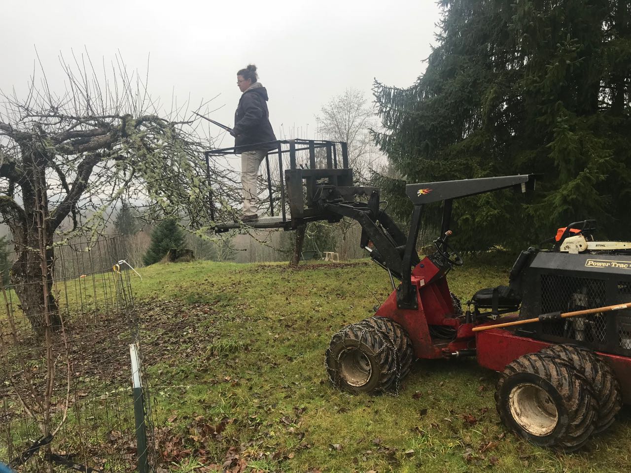

I built this a number of years ago to trim the orchard. Works great. Not too concerned about the safety police.

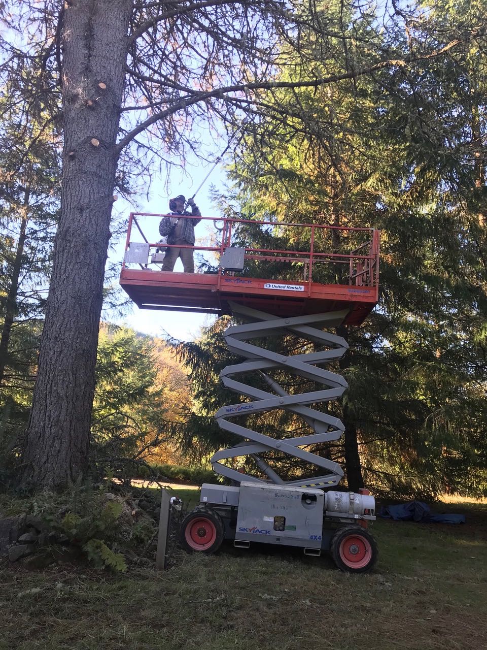

Earlier this year we needed to trim up a couple of taller trees. Neighbor who builds metal buildings dropped this by. I have to say this scared the s out of me. It was 4 wheel, we made sure it was always level. But you get that bad boy 40ft up in the air and it swayed way too much for my liking.
   / Man Lift #28
Those lifts usually have outriggers. It appears they are missing from the one you were using. I don't think I would have used it on uneven ground.
