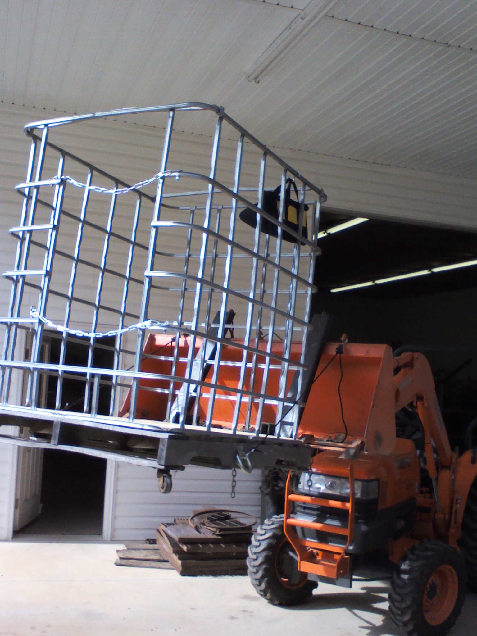

Built myself a man lift out of a 1-ton cargo container frame. I ditched the plastic base because 1) the floor wasn't solid nor smooth and 2) the cross rails on the bottom had one that was broken.
In simple terms, I simply unbolted the aluminum frame from the plastic base and threw away the plastic tank. Took a 36" x 48" pallet, decked it with 3/4" plywood and mounted the aluminum fame. Cut out a doorway and added safety chains, put wheels on the pallet for easy moving around when not on the tractor, and added a couple of healthy D-hooks on the side to prevent dropping the rig accidentally. My total cost was about $50; $35 for the tote, $8 for D-hooks and used salvaged chain and casters.
Here's a picture of my "finished" product. Comments regarding additional mods needed are welcome.

About the only thing it needs would be toe boards at the bottom, not so much because OSHA says so, but it might prevent a dropped tool from escaping.
It's always gratifying to repurpose something that would be staggeringly expensive if you had to buy the "approved" label.

Chains thru sections of plastic water pipe make it easier to hook then up. Maybe a tool tray to hold nails, tool bits, extra natteries for cordless stuff, paint sprayer parts and supplies. and a carpenter's level visible from the operator's seat to save time (use with a truck mirror). Is that an IBC tote frame ?
/ Man Lift
I'm sorry but I don't know what an IBC tote is. Its one of those that you see with the plastic tank inside the cage on a plastic pallet. I bought two 330 gallon size that had been used for food grade products for $35.00 each, delivered. I had both filled with potable water "in case of a power outage" since we didn't have a generator that put out 240v for the well pump. Now that we picked up one of those DuoMax generators for $650 that does put out 240v, we really don't need two tanks in reserve. So, I took one to make a man lift.
The toe board is definitely a great suggestion. I will do that el pronto. I have canvas tool bags for tools that I plan to hang onto the rails via 'S' hooks. Hopefully that'll suffice for my tool box, however if not, I'll build a nice wooden box for such as the items you mentioned.
I'm not totally satisfied with the chains either. An expanded metal gate might be safer, or something like that, especially since my operator (Significant Other) doing the lift control is totally inexperienced. I can just see myself getting dumped out.
The main uses planned are for power washing the workshop outside walls which are 27' to the peak, and for trimming trees. I would, of course, much preferred an OSHA approved lift, but that just isn't in the budget.
Many thanks for the suggestions.

Yes, I do have two 500# work load rope pulleys, one on either side, going to 10K D-rings. Each is independently connected to the bucket.
Re Working in a man lift being safer than off of a ladder, one of my most important uses is for tree trimming, and power spraying the house and workshop outside walls. I've personally seen my neighbor using a power spraying while on a ladder 2 stories up, get absolutely pushed off of the ladder as soon as he pulled the trigger. That was an ugly sight for sure. Put him out of commission for 6 months, with permanent disabilities. I think I'll take my chances with a man lift over a ladder.

Clever build! I can see it being quite useful as long as you have a second person to operate the FEL.
Since I usually work alone and would have to access the platform via a ladder, I would make a another "door" opening in one or both sides. I would also add ladder stops to keep a ladder from sliding side to side.

The pallet is a 4-way pallet, so lifting can be from any sides. My original thought was to have the door facing the tractor. I don't know... any thoughts on which way is best?

Since you can lift the pallet in any direction, another door isn't necessary. You just have to arrange it so the door is ladder accessible at the work site.
I once had an old pallet I used as a platform for tree pruning. The pallet was a bit smaller than the 48" forks I had so I just hung the ladder sideways on the protruding fork tips. It was a bit awkward maneuvering around trees and buildings though.

The pallet in your picture is not a true four way pallet. If you lift from the "sides" there are no cross boards under the forks. Those boards help prevent the pallet from being able to tumble off the forks. Imagine you have the pallet on the forks, and you are leaning over the front of the cage. Your weight combined with the leverage of the cage top will tend to lift the back of the pallet off the forks. Without the cross boards, it will keep going. Be safe, and don't lift the pallet from the sides. The forks need to be between the top boards and the bottom boards. Also be sure the bottom boards are well secured and strong.
I like your idea and may adapt it for myself, possibly with a steel pallet or frame, and a foldable/pivoting ladder attached at the opening, since I tend to work alone most of the time.

You're absolutely right about the pallet NOT being a 4-way. It only appears to be, looking at it from the sides. My bad. I will definitely take your precaution seriously. I also like your idea on finding a metal pallet; perhaps my friendly local Kubota dealer might have something... I sure liked the apple crate idea too, although I've never seen any of those around here. I'm not likely to find such a good base for my man lift.
I did get an opportunity to use it over the weekend, trimming 3 - 30' tall River Birch trees. Wow! It was rock solid and 10x safer than my 12' step ladder. I love it, and will continue to improve it. Its definitely a keeper idea, although not my original.
