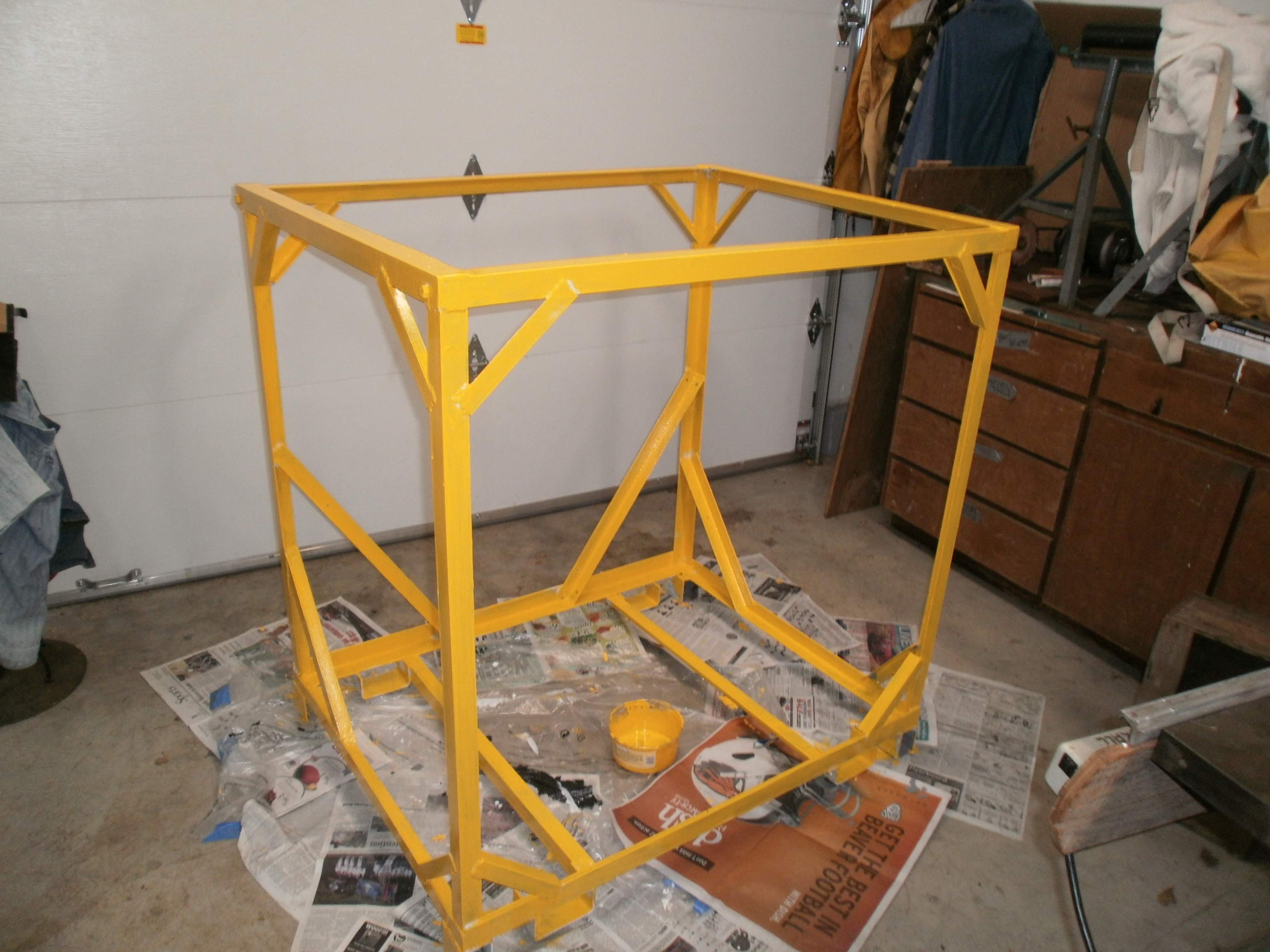

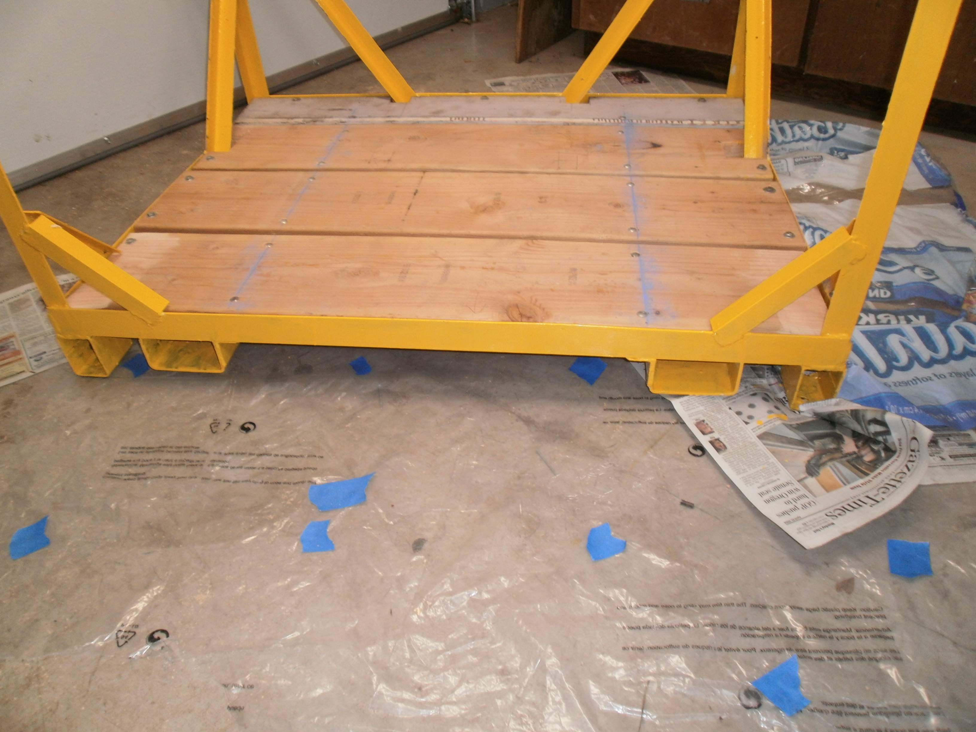

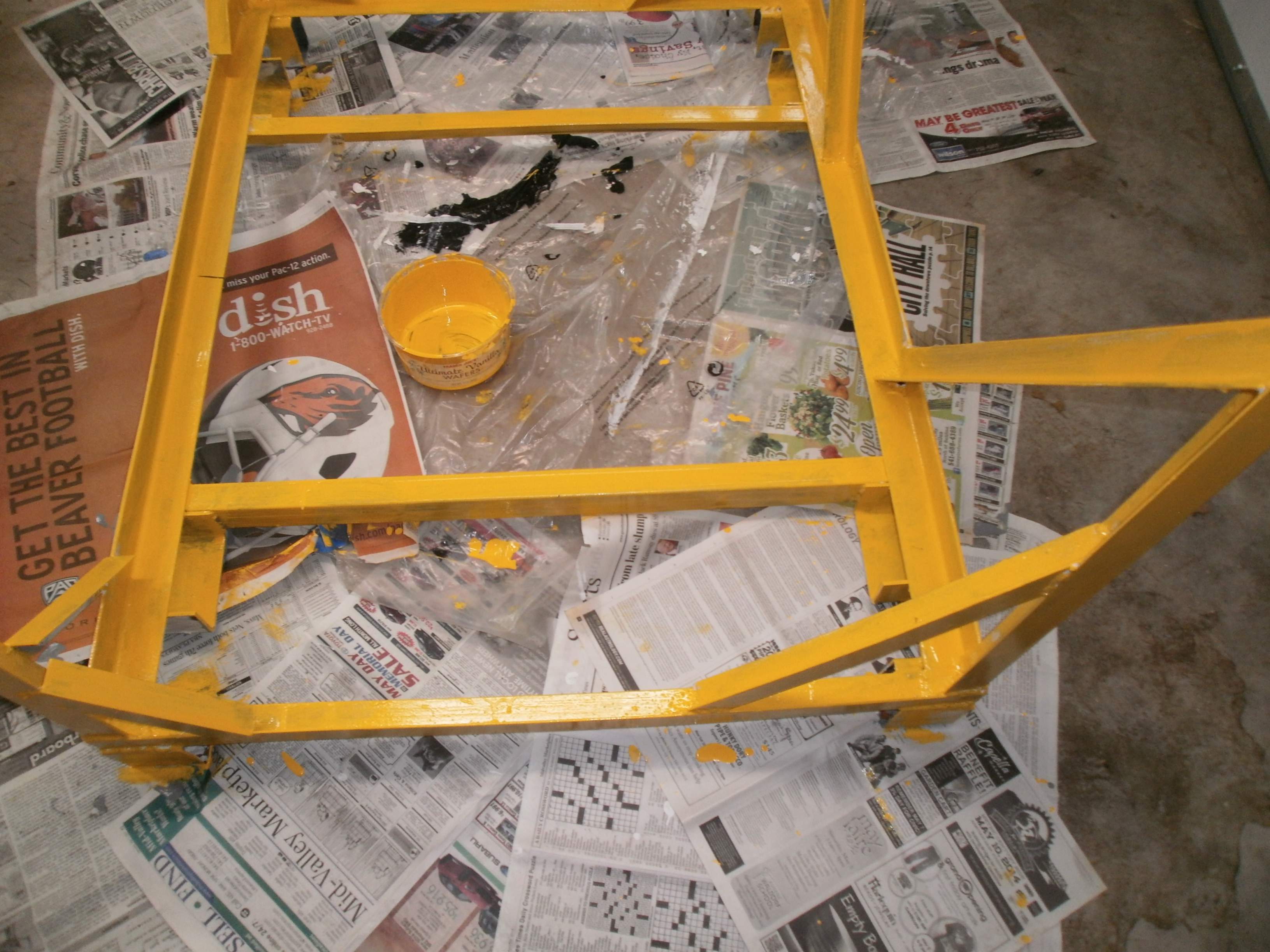

Woodmaxx pto chippers come partially assembled but crated with a platform and uprights made of rectangular tubing and angle iron. I had this thing sitting around wondering what I was gonna do with it. On the bottom I added some big C iron to house my tractor forks. A couple more pieces of angle on the sides, and a couple cross members on the bottom. Inside the tray measures roughly three feet by three foot six. I used bed frame iron and some flat strap. I think it is going to be real handy.

one should have a system to chain it on and lock it in place, or pins in the ends of the forks to keep it from working off the forks.
   / Manlift platform from a Woodmaxx pallet
I could have have welded some hooks on it for chain, but I will just run chain and binder around the fork assembly through the inside of the frame and it will be as secure as can be. Chipping paint here and there doesn't bother me. If I wanted to get picky I could wrap the chain in cloth or hose.

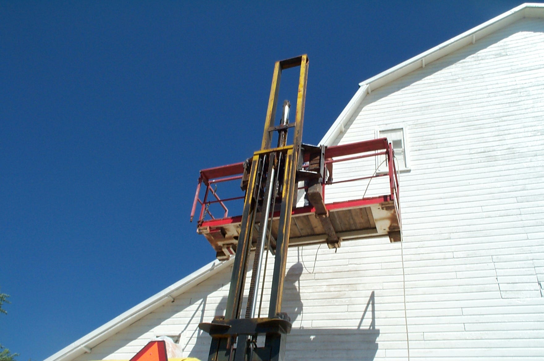

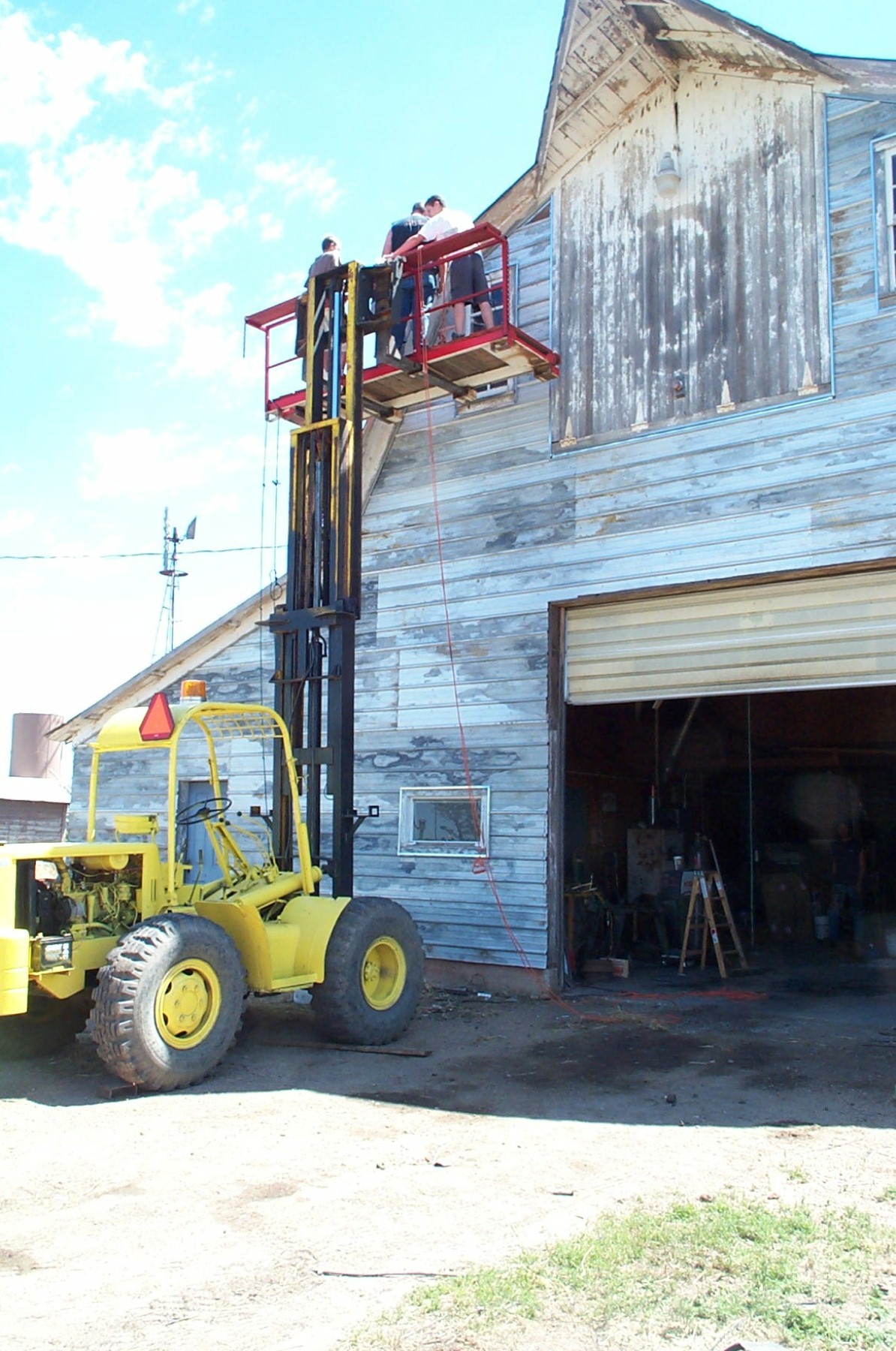

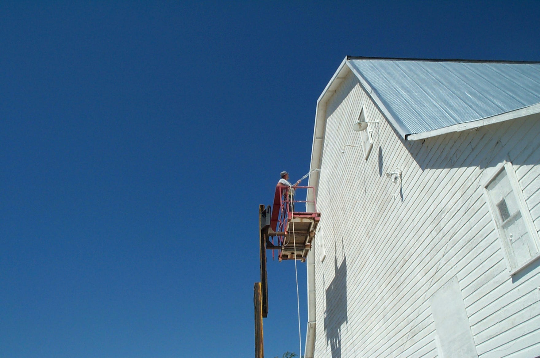

not the best picture but I built this platform a few years ago, out of a old frame about 12 feet wide,
what I like was the 2 x12 I put on the back side of it, made a good work table, and a place for tools,
I have removable frames on the front and chains on the sides of it,
also I put fork attachment points, on the ends and middle, one on the direct end so I could come into the end of it, and use it as well,
the fork lift we have will raise to 30 foot tall,
I have used it for a number of jobs like the barn siding and paint another barn,

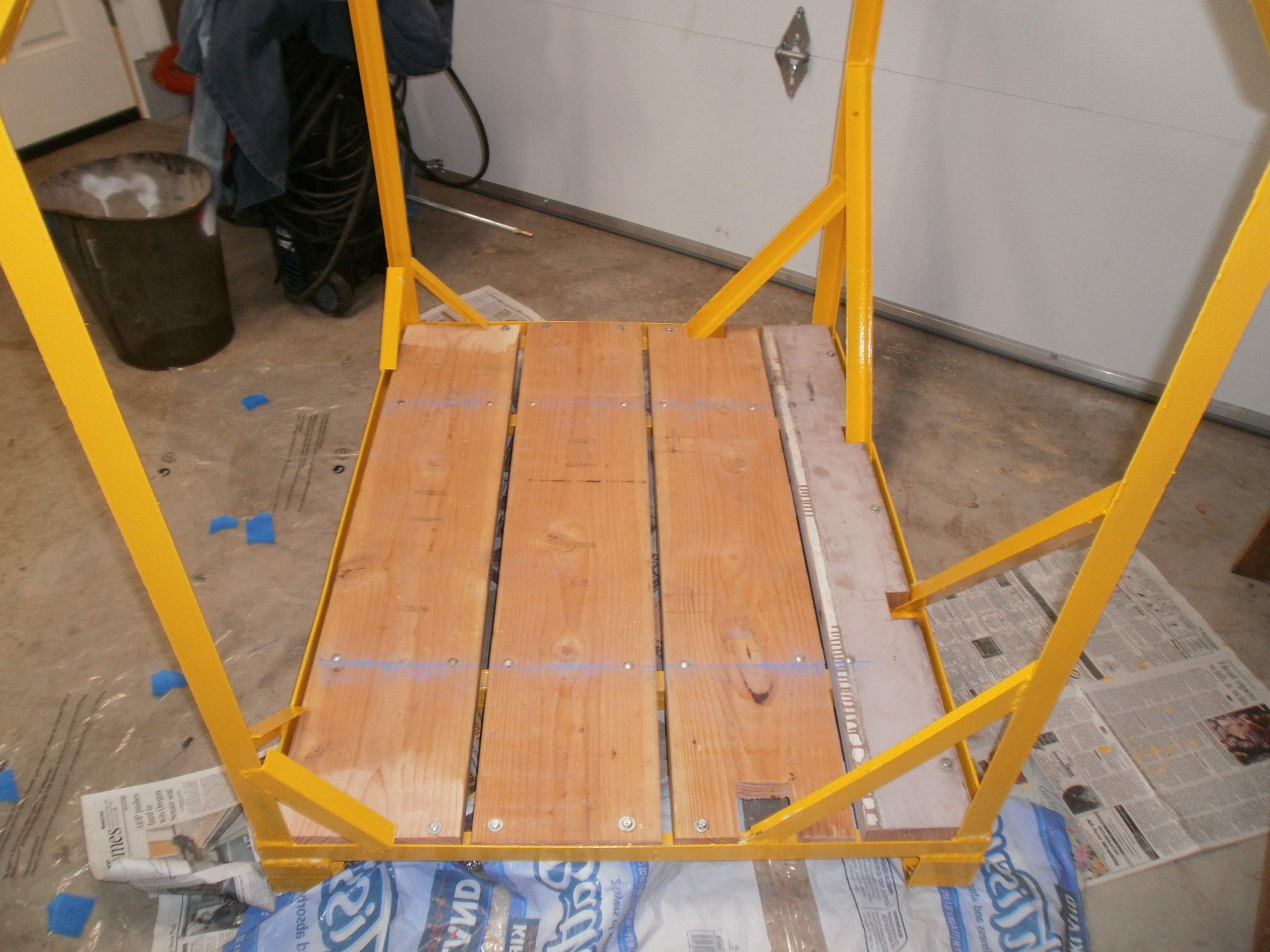

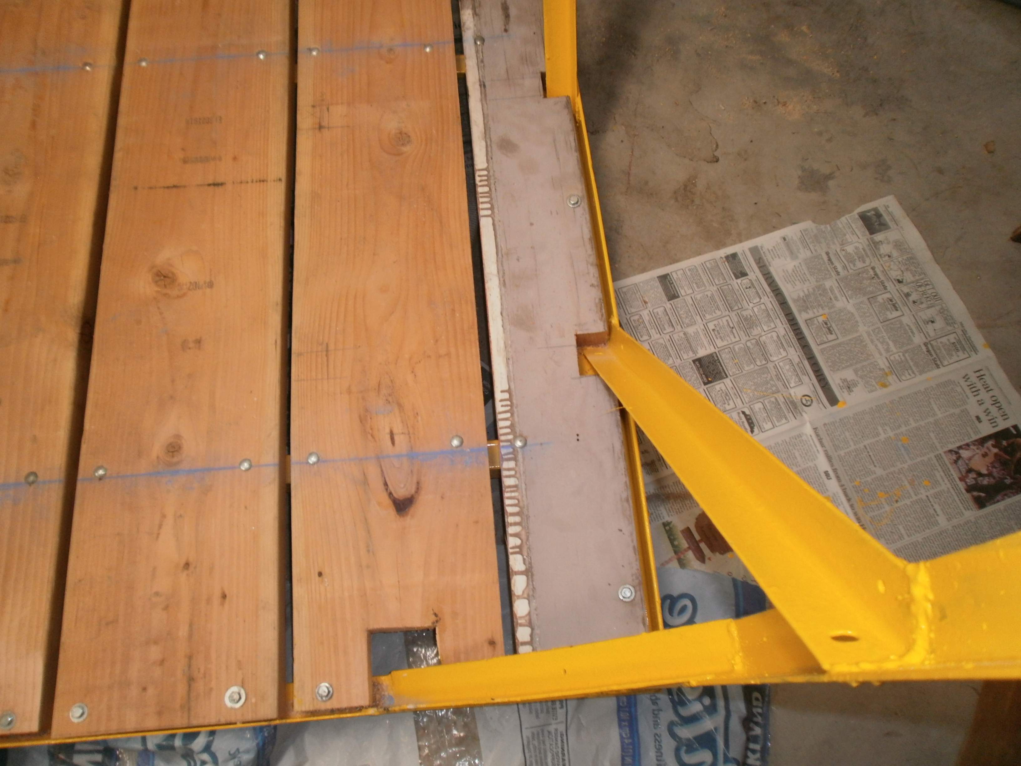

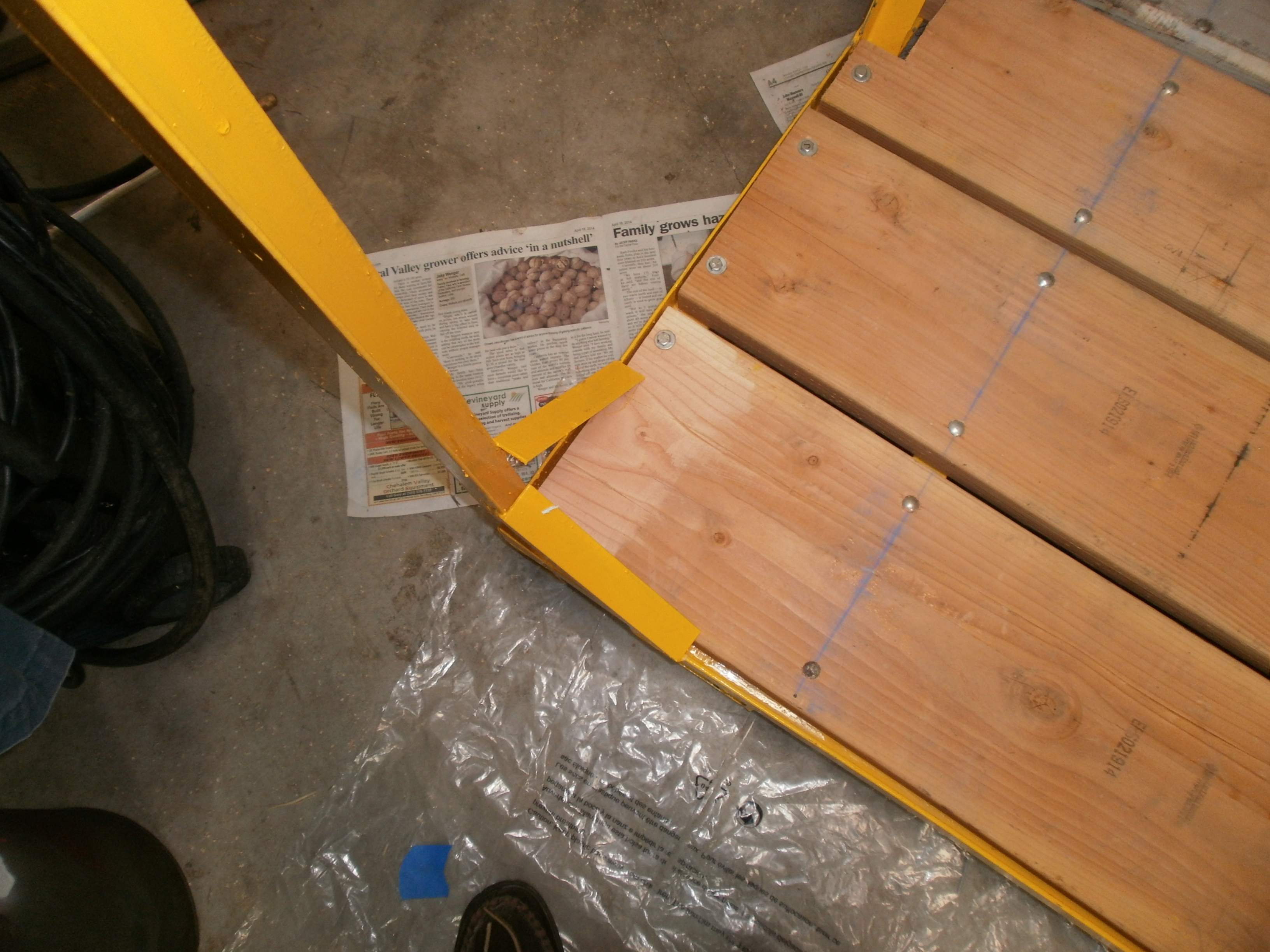

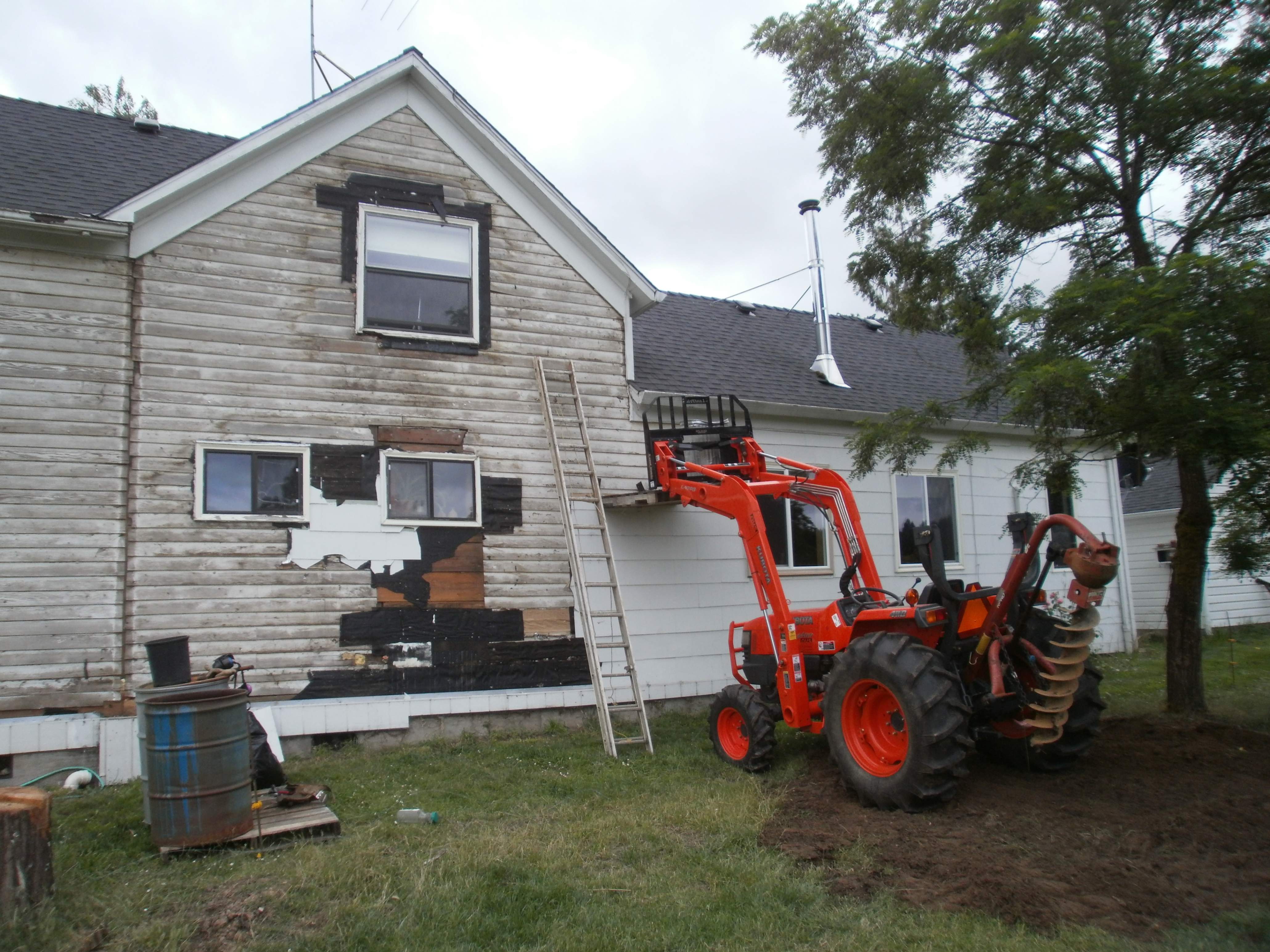

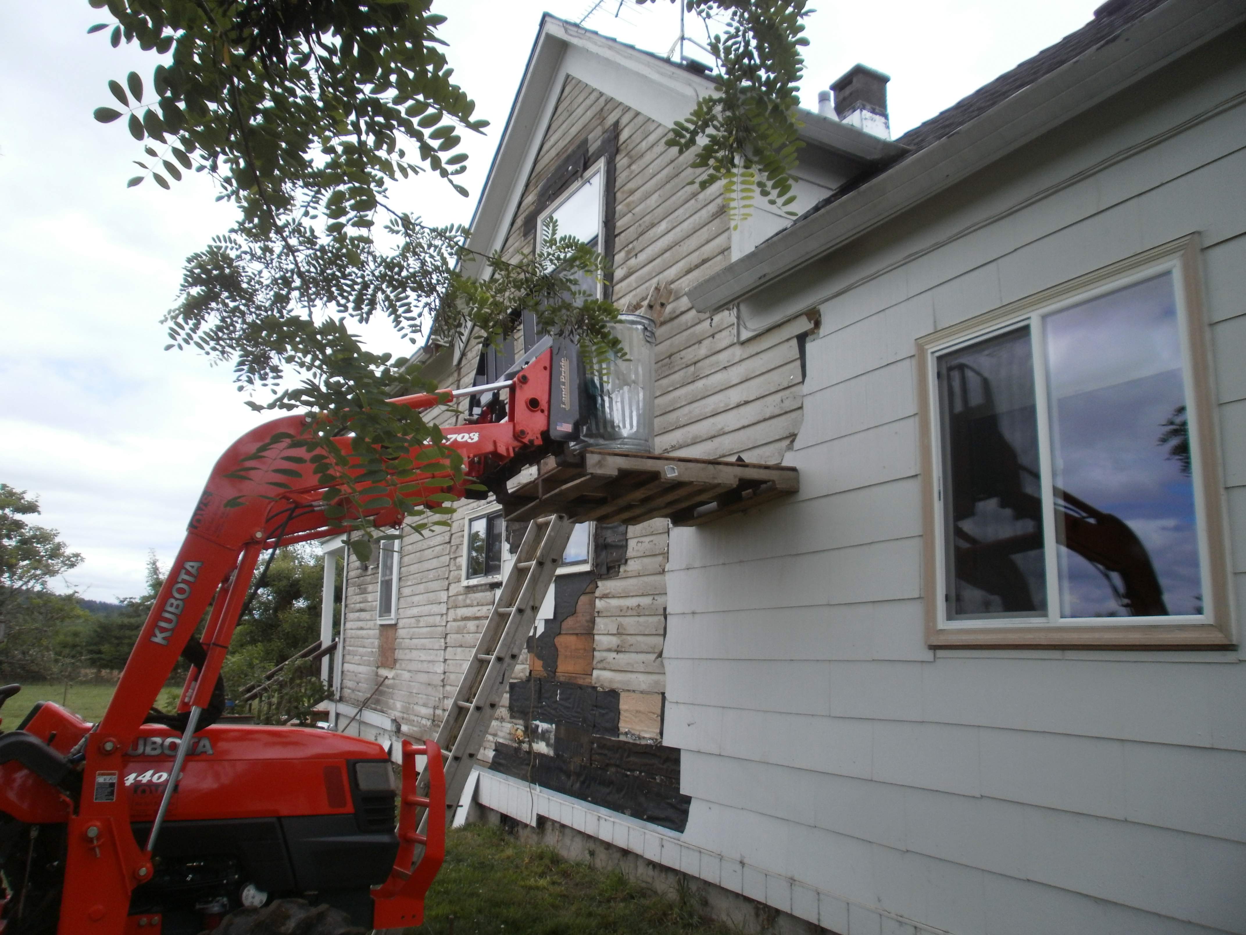

Here are finished snapshots. I cut out the spots where the angle was in the way. That was fine. I hadn't quite bargained for the inconvenience of the board that had to be cut on the ends. It was just too tight to make it fit without cutting one end out more than I wanted. I wanted to make it a tighter fit, but the angle of the dangle didn't allow that, so I had to beaver it out, allowing me to set the board in the tray. I'm happy with it and wish I had this a couple years ago when I was tearing the side of my house.P7020011.jpgPC060035.jpgP7020017.jpg
