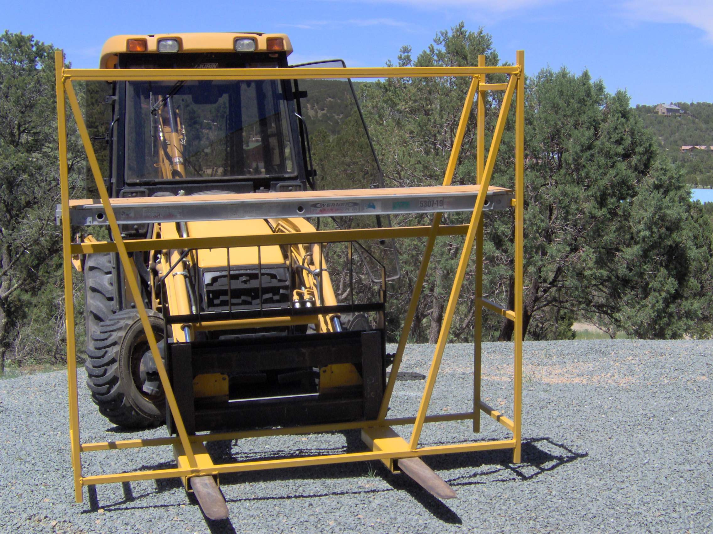

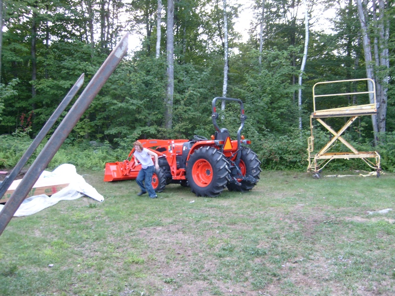

A few years back a friend bought a baler that came with a 15 bale stooker that looked like this one except it has a coarse mesh platform instead of checked plate steel.
I've always thought it would be easy and handy to split it where it hinges (three 3/4" pins) and mount it on the FEL bucket for an elevated work platform and since last year we twice had to work on his front yard light (which is a 100W HPSV luminaire mounted on top of a 14 foot ornamental standard) I decided that this year it was time to carry through with my threats and just do it. I made an attachment point on top of the bucket from a couple of pieces of 1/2" thick plate and four 1/2" bolts for the 2x2" tongue and a couple of angle iron braces from the corners of the platform where it swivels down to the bucket. We immediately used it to fix a problem with the eaves trough on the corner of his house and tested it's working height on the light standard - his head was above the luminaire - so perfect for that. Although I don't think it will be used often I'm sure it will be extremely useful when we do have a use for it. We also discussed the potential for a failure of the loader's hydraulics and know full well the hazards of using a loader for a man lift and I believe that hazard is much less than alternative work-a-rounds. We also plan to fabricate a removable extension for the guard rail.

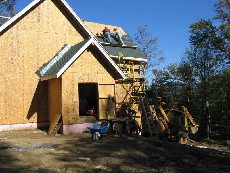

I have a jet engine work platform that came from a military surplus site. It has a hydraulic pump and cylinder that were shot so I replaced it with a pipe of pipe to fix it in the maximum lifted position. I use the clamp on forks to lift it with my backhoe. It came in very handy while building my house. In one of the pictures I used the bucket curl to level the platform one way and the stabilizers to level it the other way. Being an expanded metal floor it's easy to use straps to hold the ladder from moving.

Does it want to tip when you stand in either of the rear corners (closest to the front tires)? If the diagonal angle iron is bolted at both ends it shouldn't tip, but can't tell if they are in the pic.

texasranger556, it's very stable. The frame is 2"x2"x1/4" angle iron and the angle iron braces are under a bit of compression when installed. They are attached through existing 3/4" pins at the top end and are bolted with a 1/2" bolt ar the bottom end where there is a factory hole in the bucket.

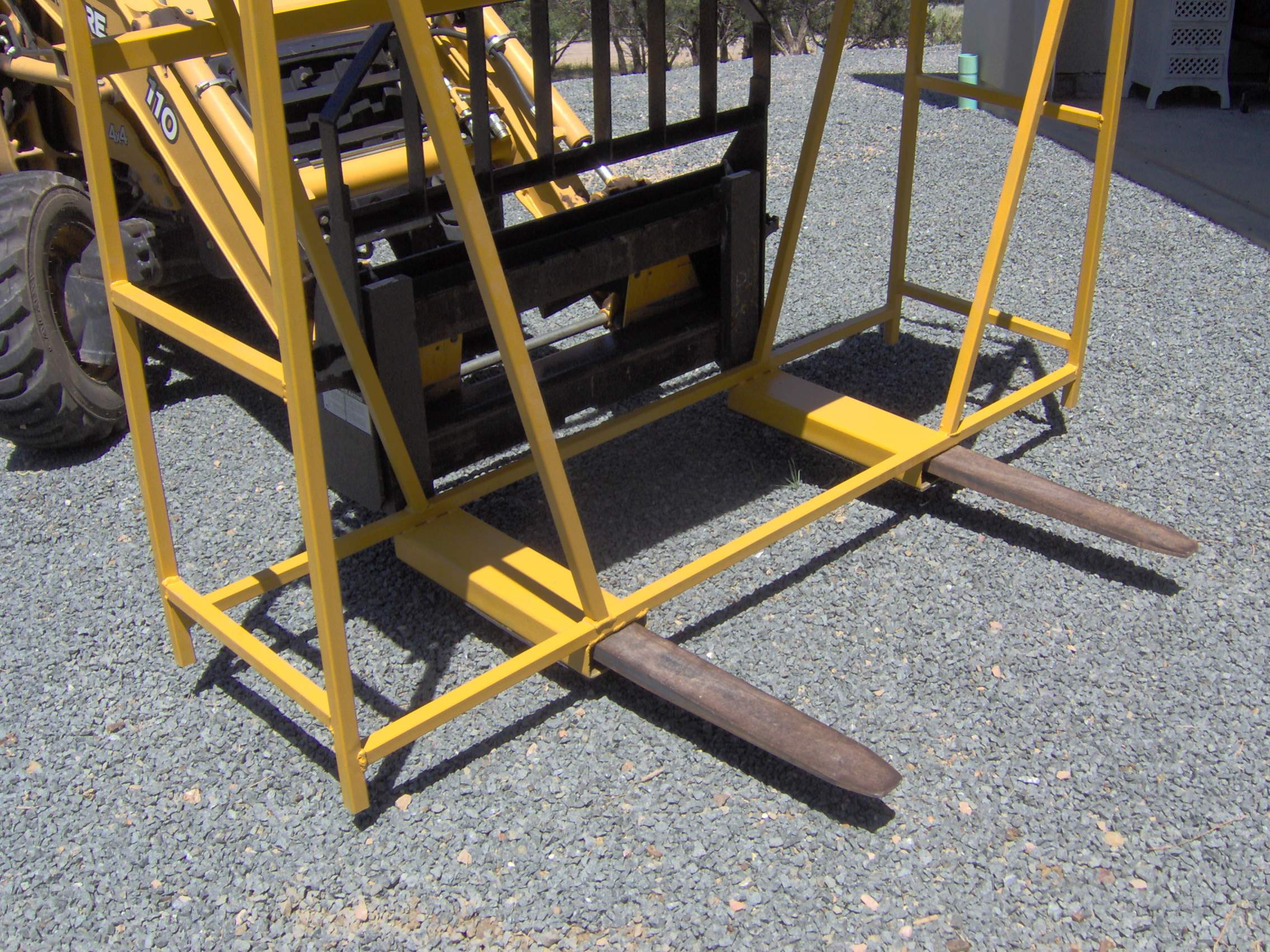

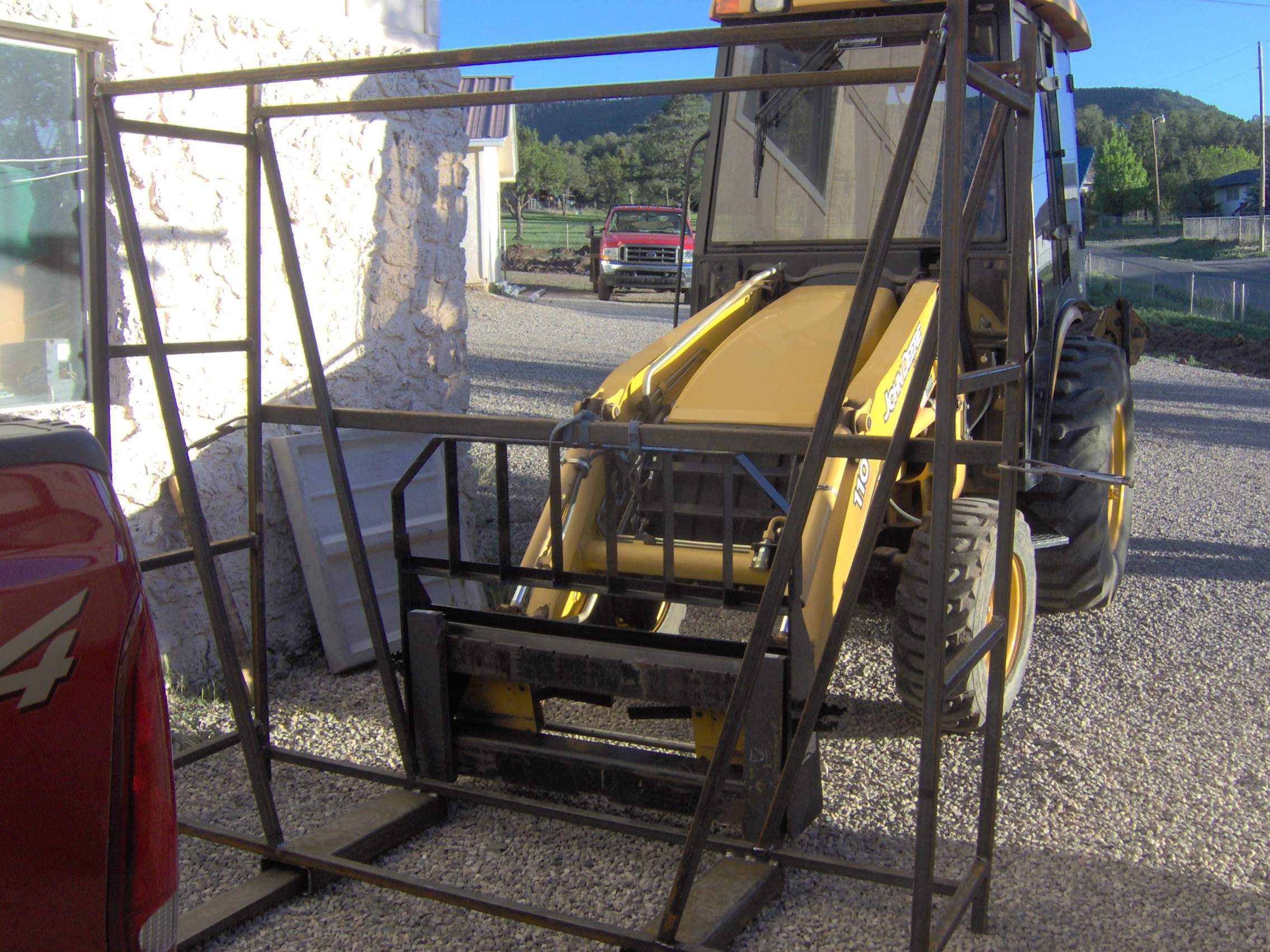

here is one I built that uses a 7' scaffold plank. Max height for the plank is 15' on top rung. I did make an add on hand rail for the top platform but have not needed it yet. It does fasten to the fork back brace and the forks allow building materials to ride along. It is light enough to load in a pickup and carry to a job site. My helper is about 5'5" he thought this was a huge help.
It is not OSHA approved, not even close but we felt it was safer than ladders.

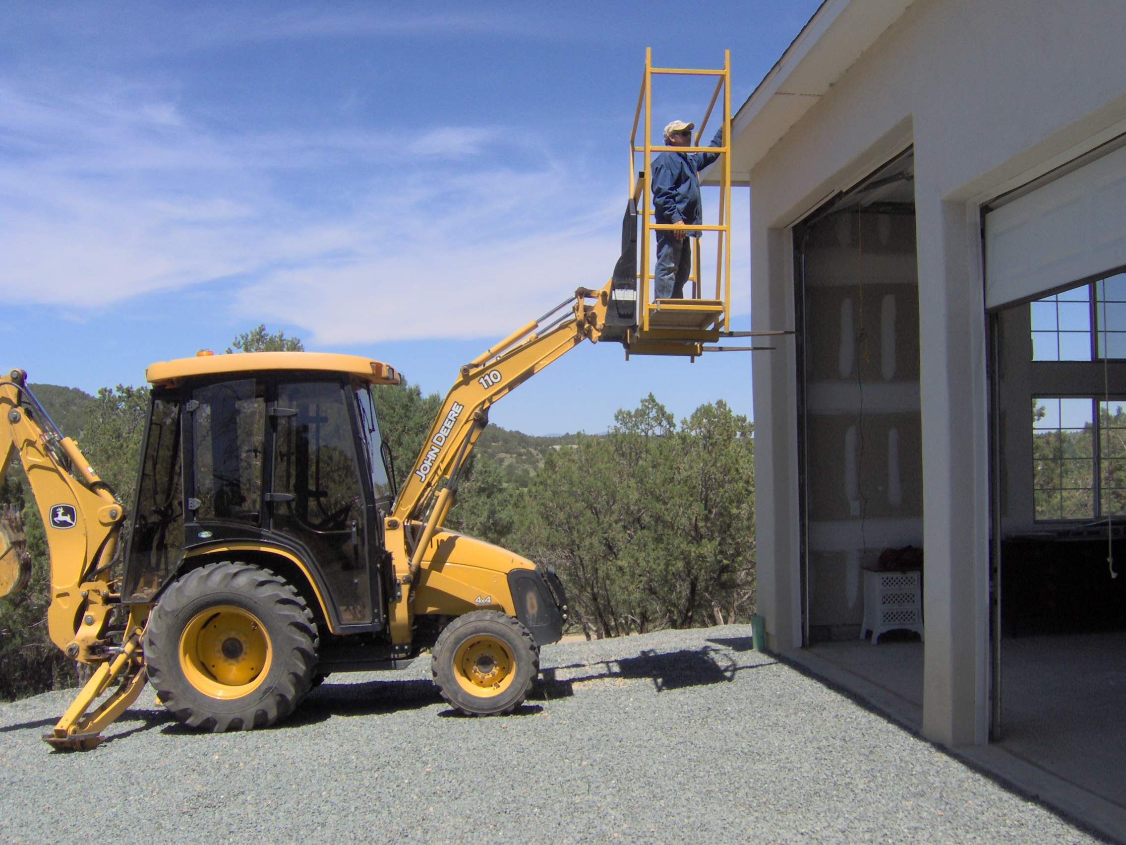

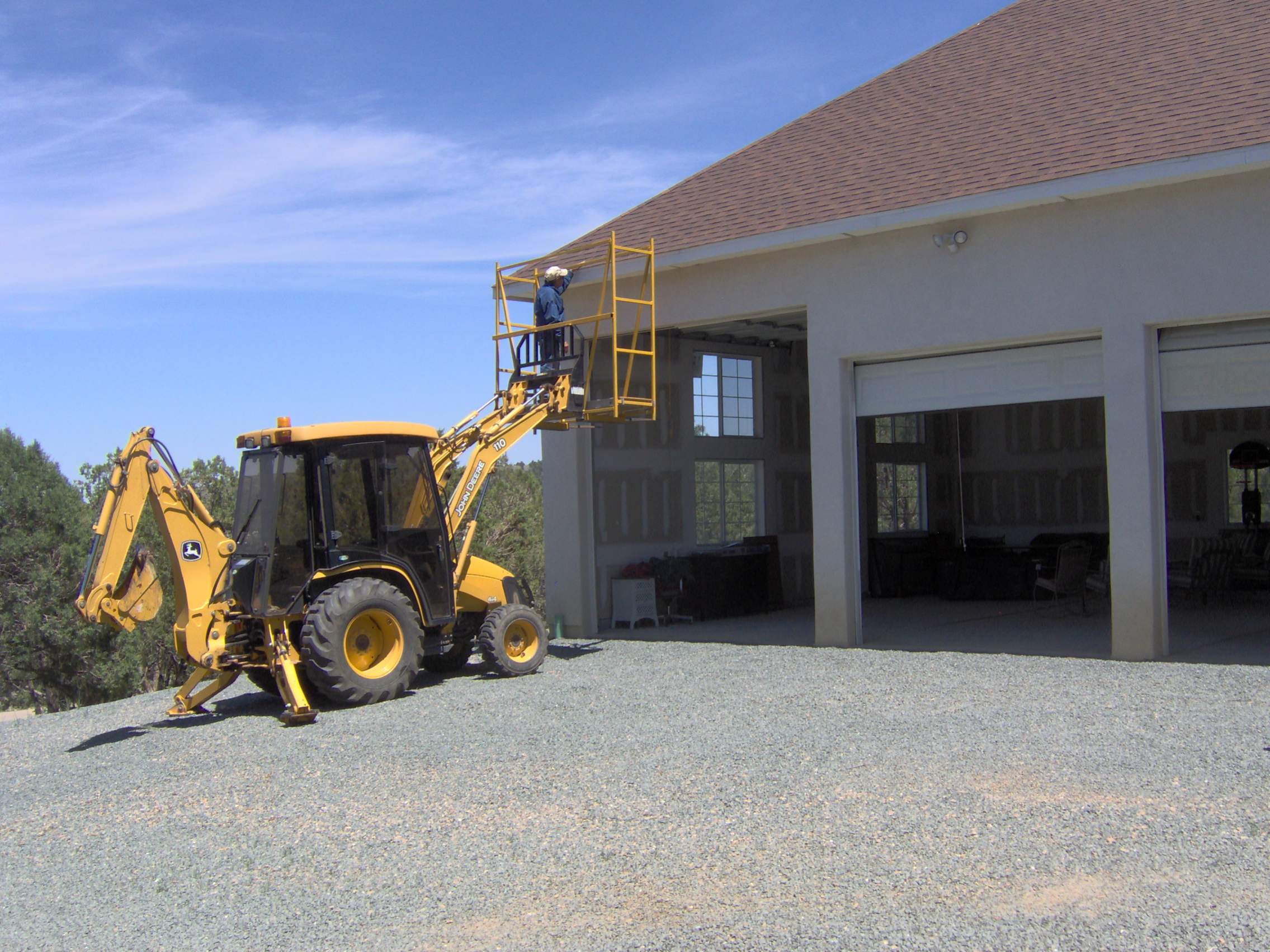

Here's a pic of my buddy on the platform and I'm in the driver's seat. That's my JD 3010 with a 148 loader with 6 foot bucket.
mace_zpsjkxh5ktq.jpg~original
That picture makes me shudder. Having worked in construction for 45 years and having seen all manner of unsafe work platforms yours ranks right up there with the most unsafe. A front loader is not built to raise a work platform and does not have safety valves in case of a hydraulic failure. If you blow a hose that platform is going down and real quick. Also there is not a safety rail all the way around the platform. There also should be attachment points for a safety harness. Take that thing off and go rent a manlift from a rental shop.
Like I said in my first post "We also discussed the potential for a failure of the loader's hydraulics and know full well the hazards of using a loader for a man lift and I believe that hazard is much less than alternative work-a-rounds."
I worked for 35 years as a Lineman for the provincial electrical utility operating a variety of equipment during that time including boom trucks and bucket trucks so I am well aware of pilot operated check valves. I guess climbing poles, steel transmission line towers, and doing rubber glove hot work on 25KV lines has given me a different perspective on what's hazardous and to what degree it is.
