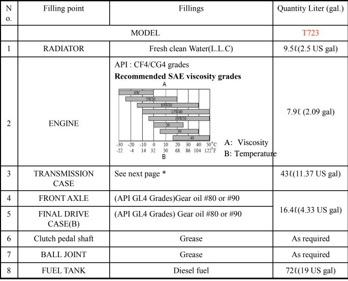

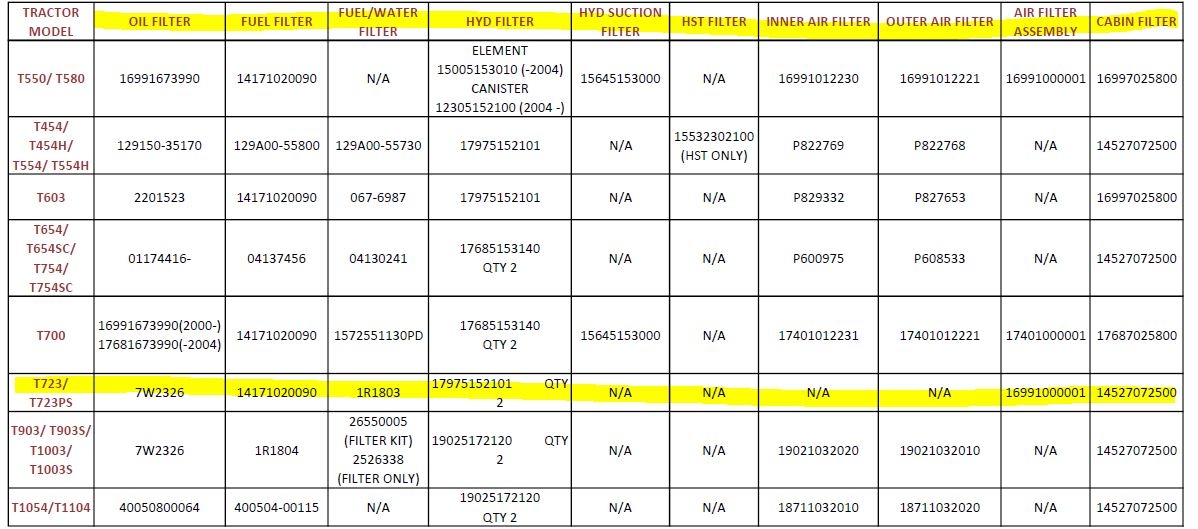

   / Manual with actual information and specifications about TYM T723 Tractor? #2
