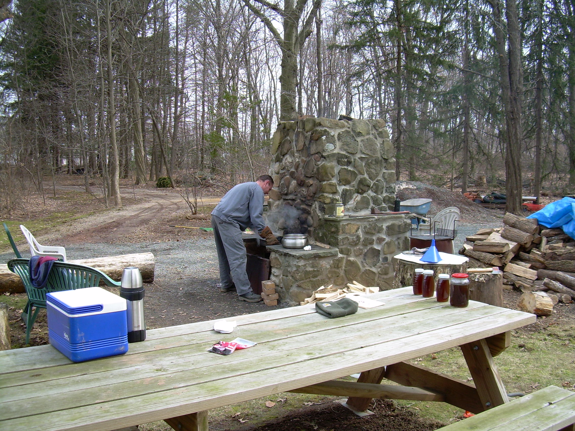

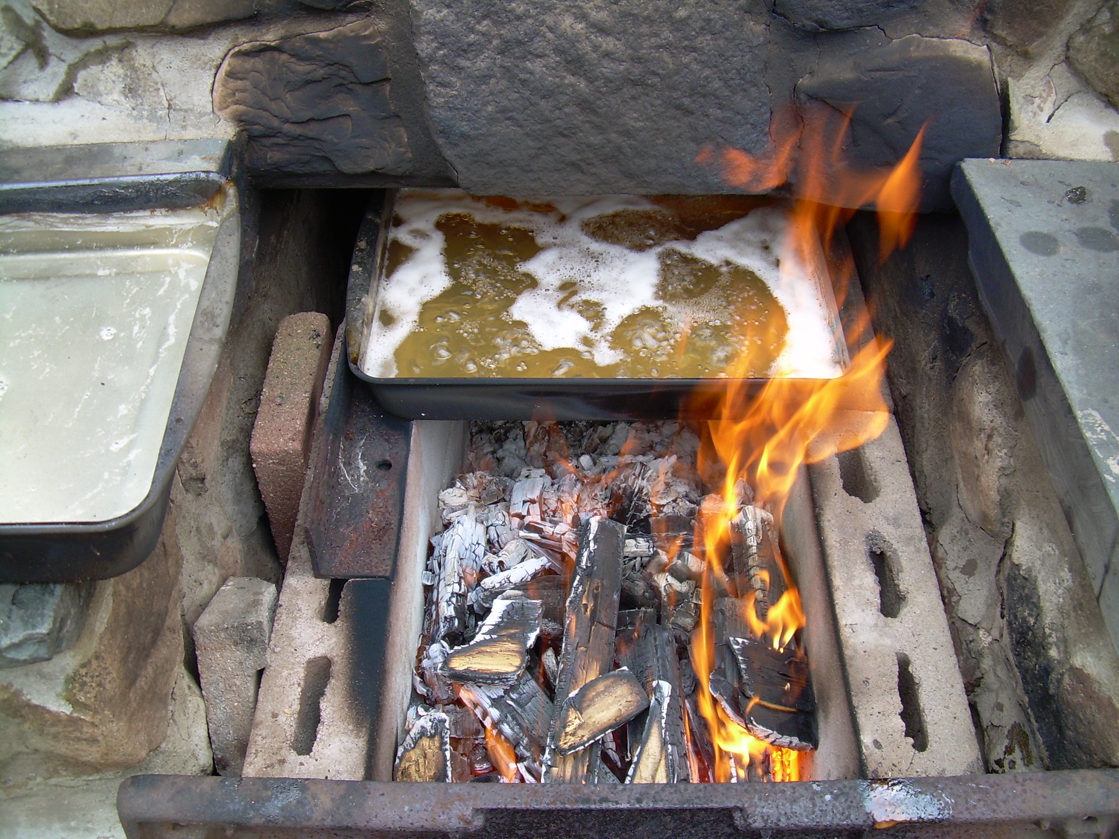

I have just 1 maple on my property (tons of oaks) and that's right on the property line but I have the south side which is where you have to tap. this one 24" dia tree is remarkable for it's quantity and quality of sap, I got almost a gallon of syrup in just over a week of collecting sap from my 3 taps in this tree. I started late and have since pulled the taps cause the flow slowed way down, but this week the tree was pouring out again, so I guessed I pulled the taps to soon.
I'm constantly making it to thick thinking I can't possibly have this much syrup already. The thicker batch is even tastier but will turn sugary if not used in a few days after opening.
I got interested after reading a storey in the local news about a guy in town that taps about 30 trees in his neighborhood, it's a 45 year old sub division and the builder planted maple trees in all the front yards. I collected a couple of quarts of sap from my tree and boiled it on the stove only got a tiny bit of syrup but it was really syrup and tasted delicious, I was hooked.
Now I boil it in the back yard over a modified outdoor fireplace.
At 40 to 1 ratio it would take 10 gallons sap to make 1 QT syrup, I'm getting a quart out of about 7.5 gallons.
JB.
