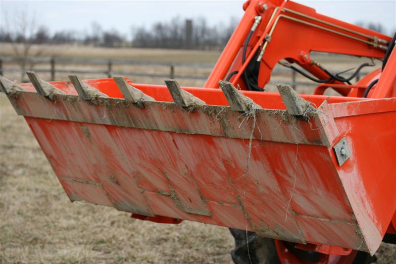

The toothbar really needs to be removable if you want versatility. Unless you have a large compact, your toothbar will be more solid then the loader has lift. I use the toothbar for moving brush, raking dirt of roots and brush by back dragging, popping corners of concrete slabs, breaking out hard piles, increasing the capacity of the bucket, (it really does add to the capacity the bucket can carry). I used a unibit to drill my bucket out and it worked perfectly. My bolts were 3/4", not a chance you will break them because they only keep the toothbar from sliding off, the bar has slots that pinch down on the cutting edge that do the real work.

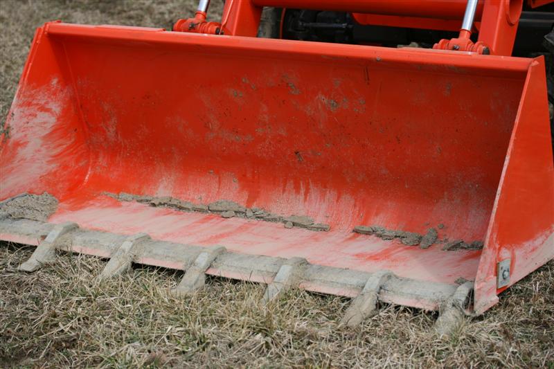

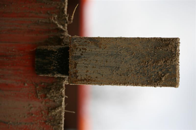

I just recently installed a Markham Toothbar on my bucket (72"). I haven't used it very much but it is one quality product. It is the most bang-for-the-buck upgrade you can purchase. It is quite heavy duty. I was absolutely amazed at how much better I was able to dig with the toothbar. It probably increased my digging capability by 10 fold! I would doubt that there is any significant stress on the bolts. The TBs are secured to the cutting edge by notches under the bar. So all the digging stress is placed on the bar and not on the bolts. It's difficult to explain, maybe I'll see about taking a picture. They are not easy to install but it did seem to take forever to drill the 1/2" holes in the hardened steel of my bucket. I drilled a 1/16" pilot hole, then a 1/8", then a 1/4", then a 3/8", and finally a 1/2". They all went quickly until I got to the 1/2". I think I was in too much of a hurry by that time and went too quickly with too little oil and quickly dulled the bit. Markham's service is outstanding. It's the best money I've spent for my tractor.

I just thought of something else worth mentioning. The bolts go through a slot in the toothbar. I mounted my toothbar so the bolt would be right in the middle of the slot. I have heard from Markham that it is slotted for a margin-of-error. Before the bolts sustain any forces or stresses the toothbar would likely slide, which is virtually impossible due to the notches on the bottom which brace the toothbar on the bucket's cutting edge.

Here are some pics of my Markham toothbar. First is the whole bucket, second shows the tooth bar curled, last is a closeup of the underside in an attempt to show these notched teeth I have been talking about. Maybe this will help explain some of my blabbering.
