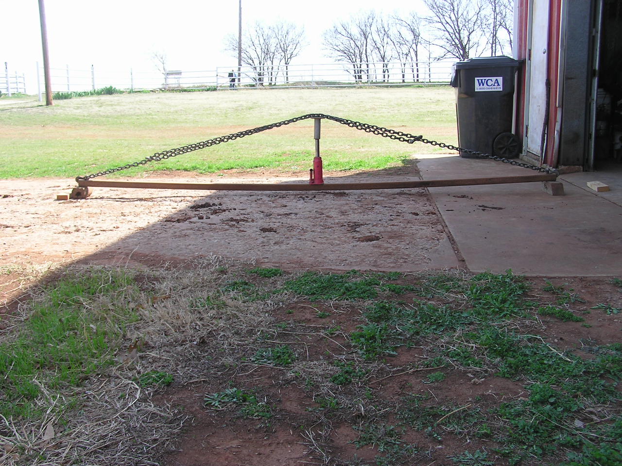

While I was taking things apart, I figured I might as well take the rear door off. So should I just put a block over the center and lower my loader down on top until it is straight, or is there a safer way?
If you use the loader, put thin stop under it in the middle, so it doesn't go too far. You have to go past straight to allow for spring back, it is hard to know how far.
Here is another way, this is square tubing. It had a slight bend, I put the jack on the high spot, and went down a little more each time, until it came up straight.
